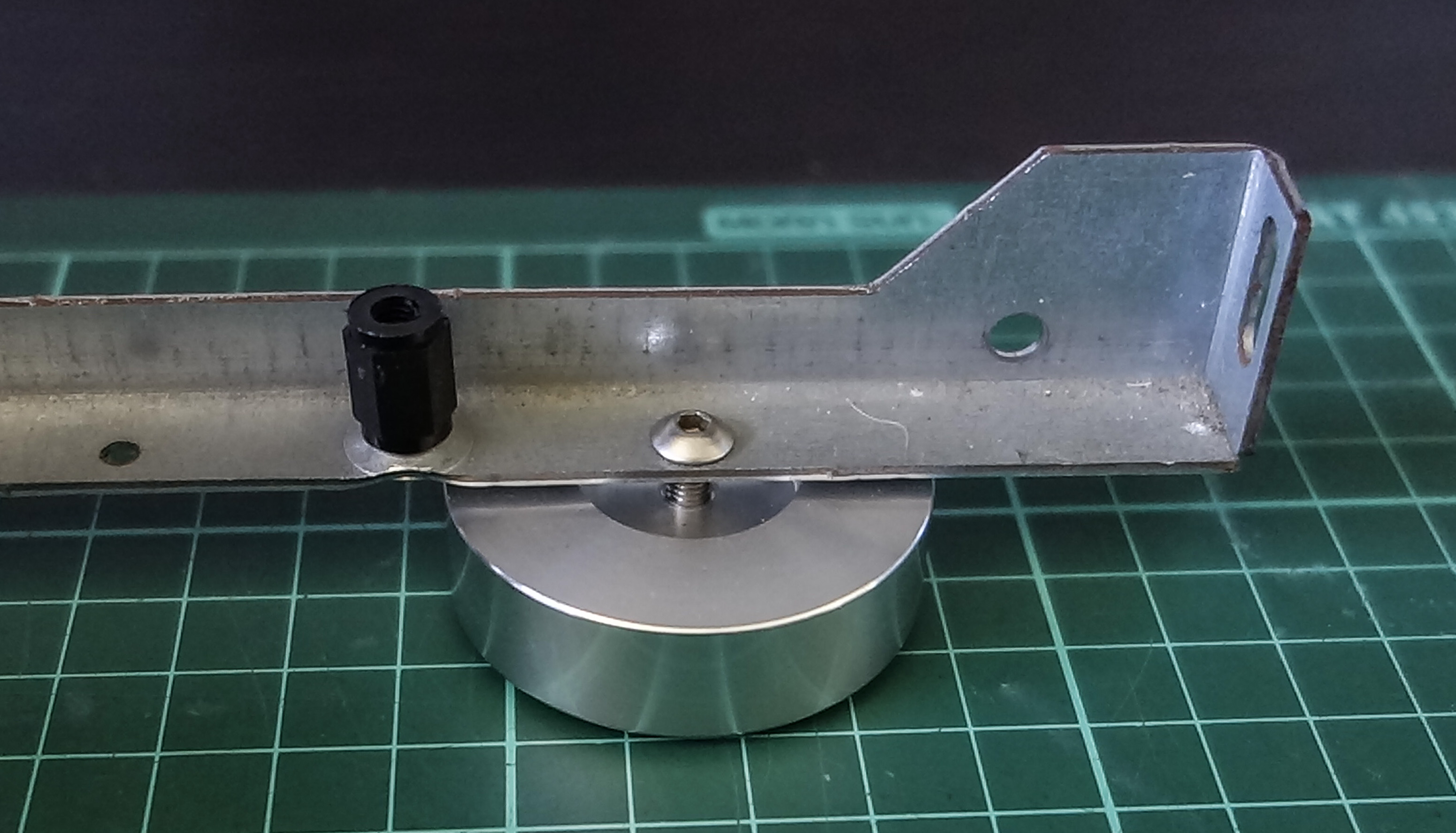

Bit of info that may be useful to future visitors here:
The sheet screw holes to affix the top and bottom panels are threaded to M3 specs. To affix the standard plastic feet using the same holes as for the bottom panel, substitute M3-16 machine screws for the black sheet metal screws provided.
As suggested by Zen Mod (tray spacers), and the queries on feet mounting, the attached photo provides an idea of what I have done
1) A 12mm spacer has been added (a 'dummy' at this stage - it's plastic) as an internal tray spacer.
2) The front and rear pre drilled screw holes (that hold the upper and lower bases in position) of the base have been tapped to M4 and M4 bolts screwed in from above. This allows one to screw on the feet, after having placed the base plate in position. The middle plate screw is still used as per design whilst the feet clamp the 4 corners of the base in place. Obviously the 4mm screw size must be chosen such that it is not too long to prevent the feet 'clamping' the base plate in position. The M4 bolt length will probably vary by which feet are used (I purchased mine from Ebay).
Anyway, I thought this idea might be helpful to others.
