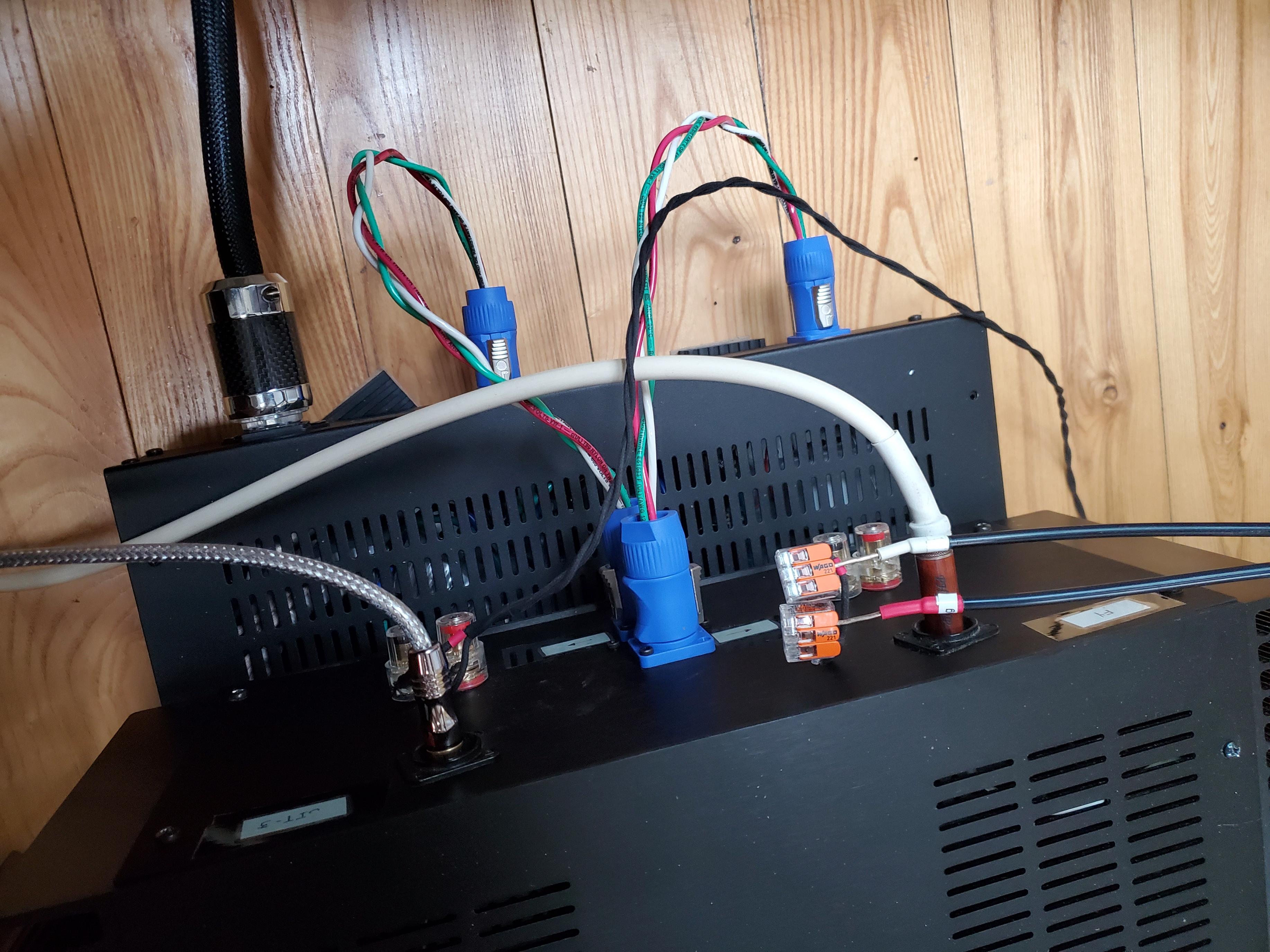

I use wago lever nuts. A low mass copper connection with better clamping than a binding post. Cheaper and better sounding too.
Why put all that metal and an iffy mechanical connection between your wires?
Those look good as terminal blocks for the power transformer. You’re using them as binding posts?
Yep, I just run the output wire out of the chassis and then connect to the speaker wire right there.
And yes, could be used internally too. They're ul certified and can take over 300v of continuous electricity... and a 1kA pulse.
