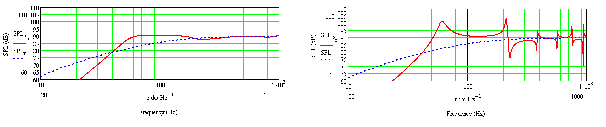

A pencil with & without damping. It's a specific MLTL alignment.
How do you suggest positioning the stuffing if i use the braces with circles? Is polyfill sufficient or should i buy acousta-stuff or whatever.
Use whatever you like within reason; the object was to make a cabinet that is easily adjusted to a given requirement by varying the level of damping (& why removable backs are highly recommended for the pencil cabinets) -this will also vary depending on what material is used. Default is simple dacron (hollow fibre polyester), but you can use others.
Damping is uniform throughout.

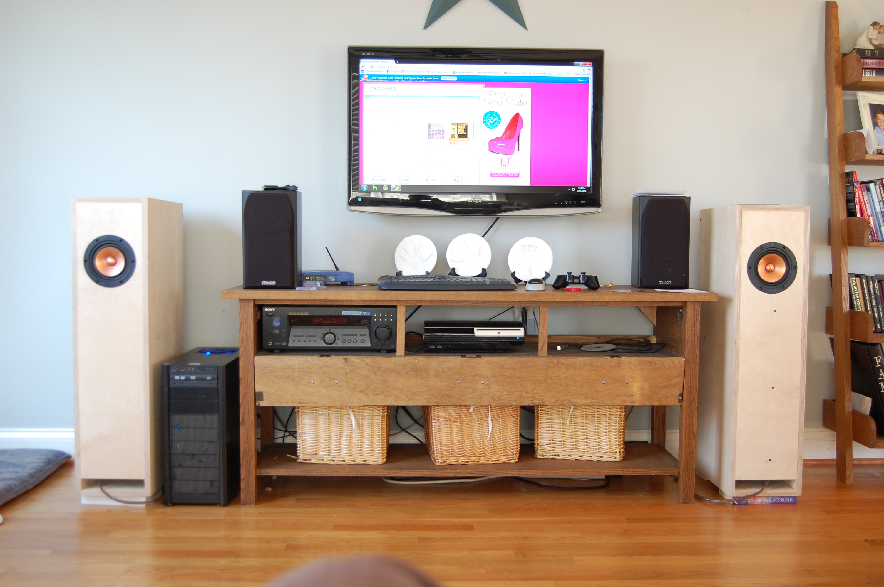

I have included a picture and was wondering what may be happening with my room that is throwing the sound-stage to the left. I can sit centered in front of speakers and music has good sound-stage, but is shifted left. Is it the couch on the right or space between left speaker and entertainment center? I know room interaction is technical and i can only do so much. Tried lifting speakers off the ground to simulate feet to see if it would reinforce bass with a little different floor bounce
Please understand they sound great, just trying to dial them in. I have a feeling that when all is said and done they will be phenomenal.
