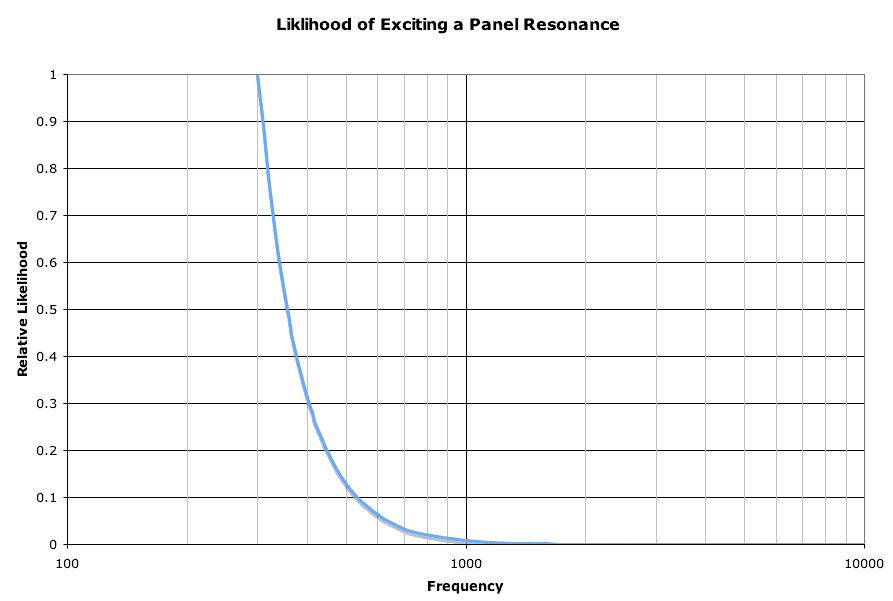

Let's consider that the energy to excite a resonance is inversly proportional to the 4th power of the frequency.
Let's assume that a typical MDF panel resonantes at 300 Hz. Now consider how much less likely a resonance is to be excited if we can push the panel resonance up to 1000 Hz.
(1/300^4)/(1/1000^4) = 123 times less likely. In a full range speaker one we have energy into the cabinet all the way up, but one can arbitrarily pick a point using the "less likely to get excited" criterion to decide where the functional bandwidth of the cabinet extends.
The chart shows relative likelihood of exciting a resonance at that frequency. Below ~300 Hz, the 4th order supposition breaks down

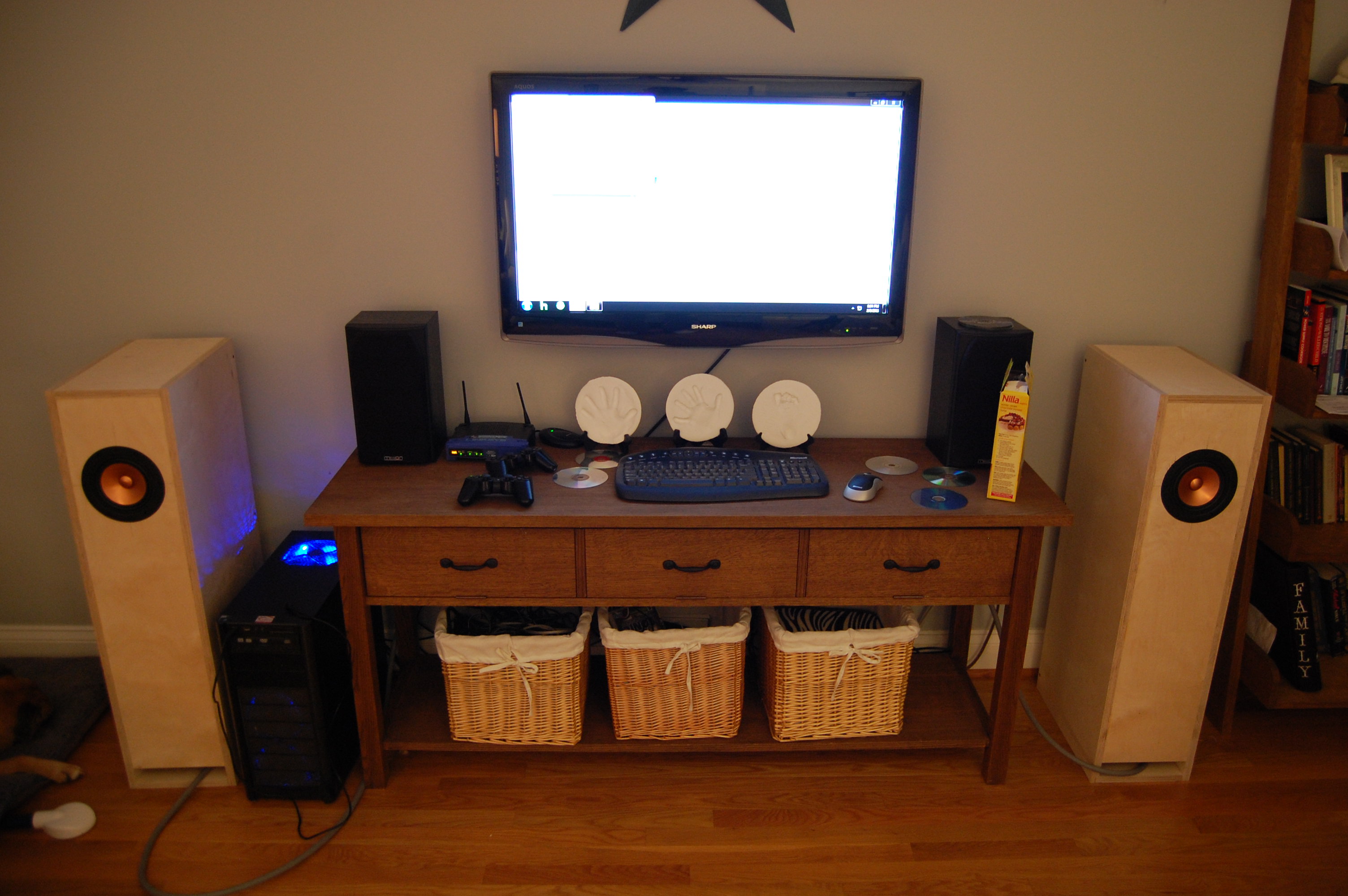

Routed out the speaker holes and definitely feel like some added bracing is necessary. I have left over 3/4", but feel like this is big enough that it could affect cabinet response. I also have 1/4" plexiglass, but it is not very stiff. Don't want to buy 3/8 just for backing and not real sure it would be good for bracing. ANy comments. ChrisB, have you worked with raw veneer before? found some very nice stuff, but it is raw and thinner than I am used to.
Drivers are installed now. Just testing them out. Have to add stuffing and braces. One problem, I cant find the woofers. Sounds great Scott and Mark and I am listening to my HT amp. Can't wait to hear them with some Pass AJ's. Ordering either figured cherry or figured Anigre to finish them in. Will have more pics soon. Side note, they reveal the source! Pandora sounds like crap. CD's=wonderful

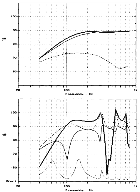

They're a TL variation, so stuffing is a major functional component in the design. Brings the response to the correct alignment, flattens out the impedance & improves control over the driver. You can adjust the quantity to suit your particular system / room / taste.
Stuffed & unstuffed from Augspurger.
