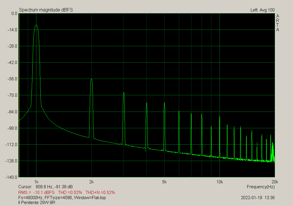

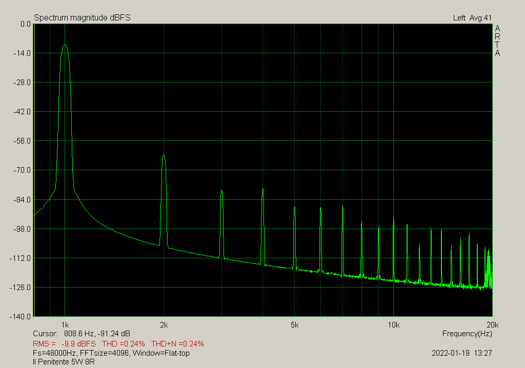

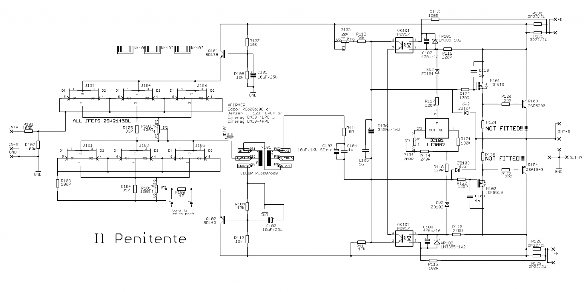

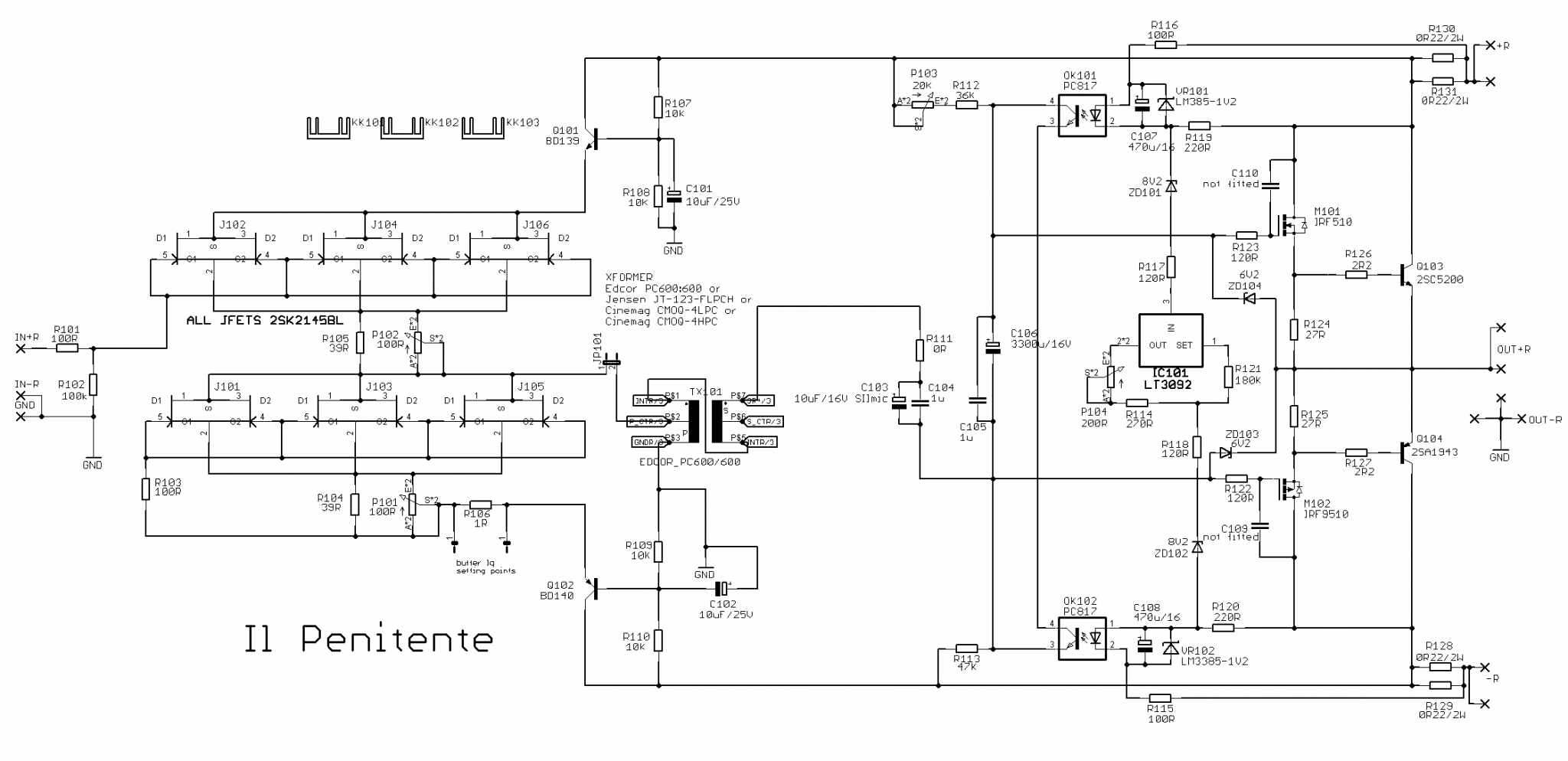

So, last one in series of autoformer gain amps (you can call them all - M2 on Mushrooms :rofl: ) , this one differing on outputs being classic BJT complementary pair, so sorta blasphemy in Papaland ......... he sinned heavily eons ago ....... while my Sin is recent........ :devilr:
Anyway, here's funny diagram, showing nothing else than bunch of multilegged fuses and some nice iron
hm, yes, my prototype equipped with first genuine ones I snatched from drawer - 2SA1491/2SC3855 ....... but pretty much any "for Audio amp" complementary pair should work well ........ 2SA1943/2SC5200 , TTA/TTC (newest Toshiba incarnation of 2SA/2SC)
rails +/-23V, Iq 1A5
2nd is clearly neg phase, not seen from my gigglywiggly, but I stumbled on nice routine in LTSpice showing just that behavior and didn't yet found reason to doubt it
edit on 20.01.2022. - C109 and C110 are not fitted, neither here nor in schm in post #6, so ignore them; these were "precautionary parts"...... which I initially forgot they're needing investigation (with or without); measurements shown were made with them in place, but after trying without, I can happily toss them out; as result, Freq. linearity (logically) being better without them ..... for instance , 8R load - everything stays in 1db envelope

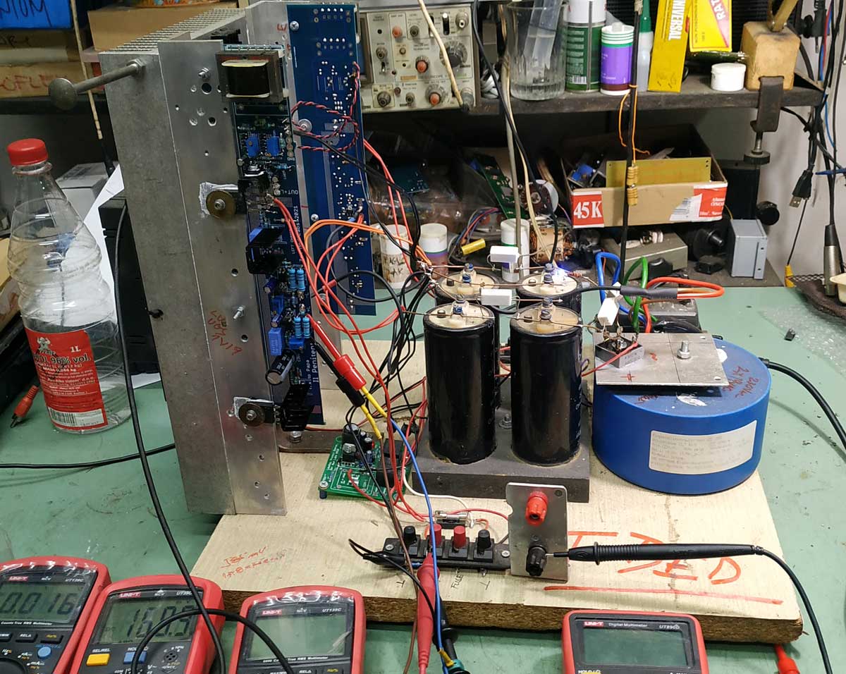

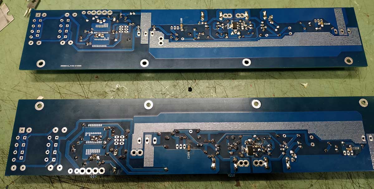

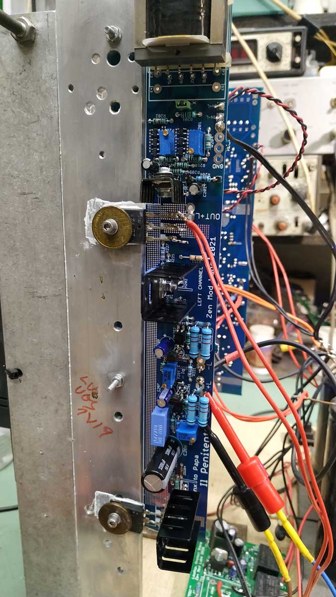

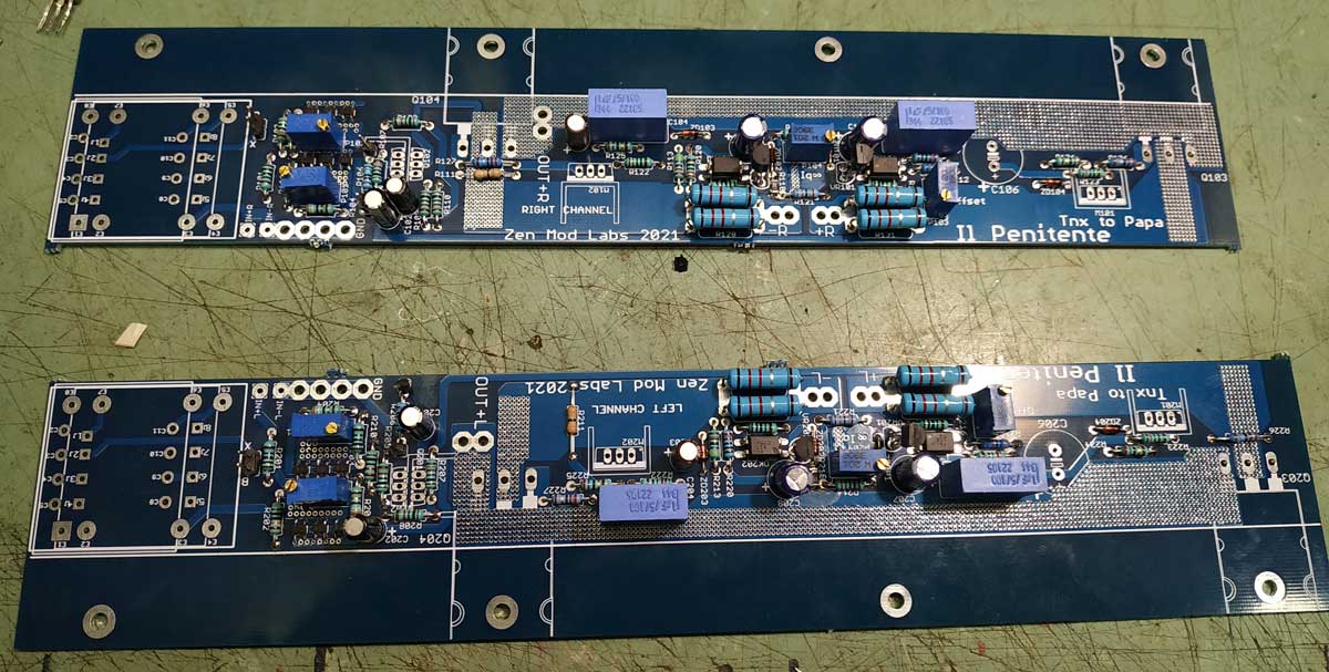

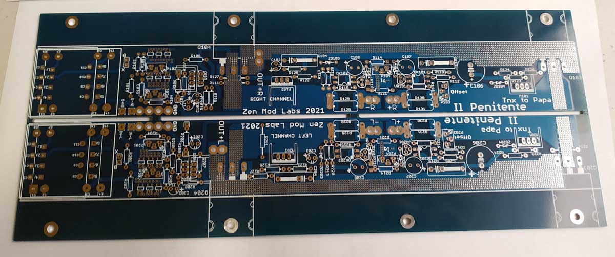

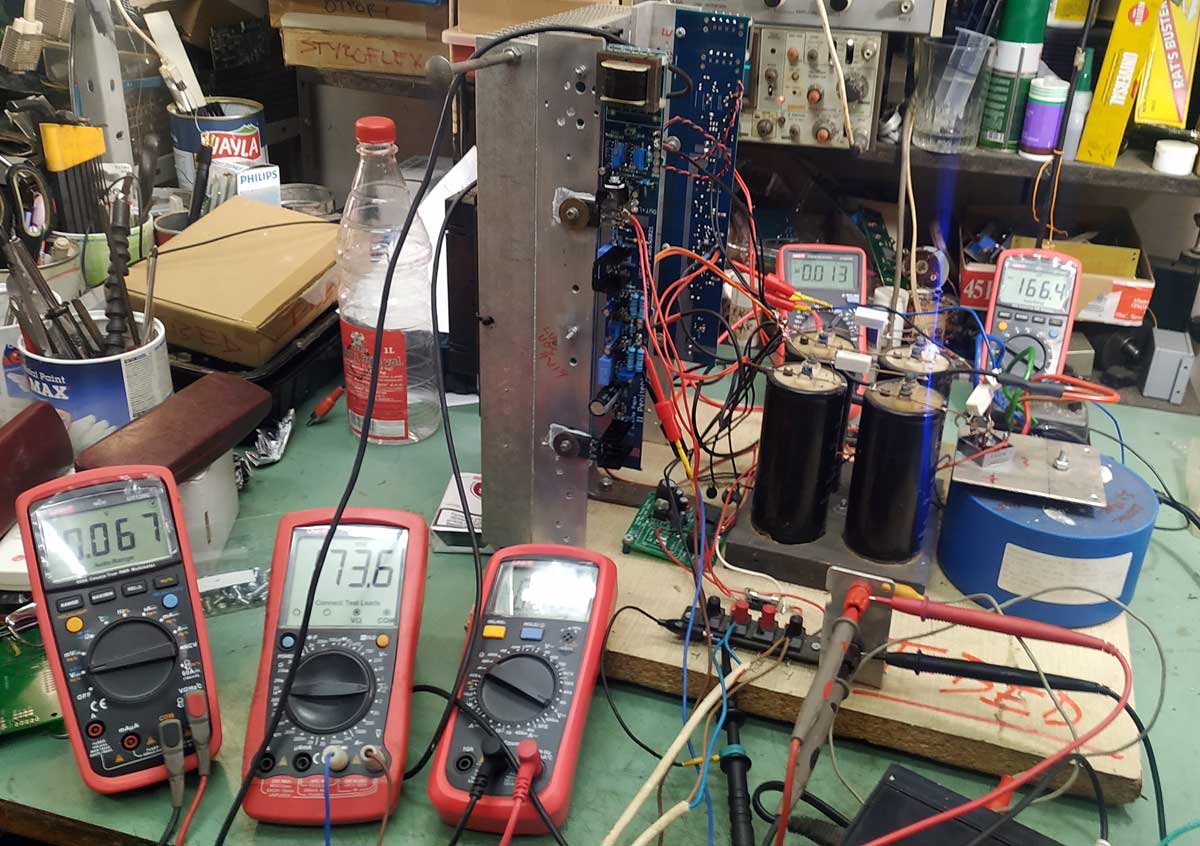

some funny pics from my workbench

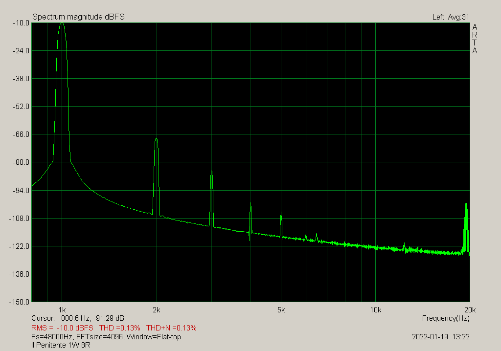

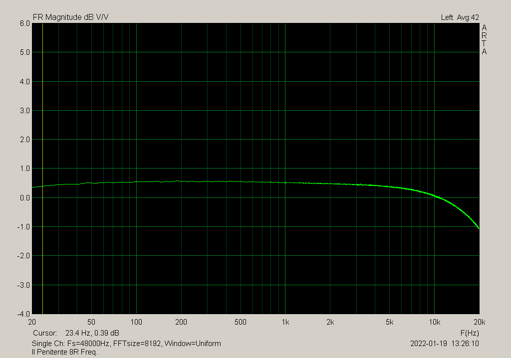

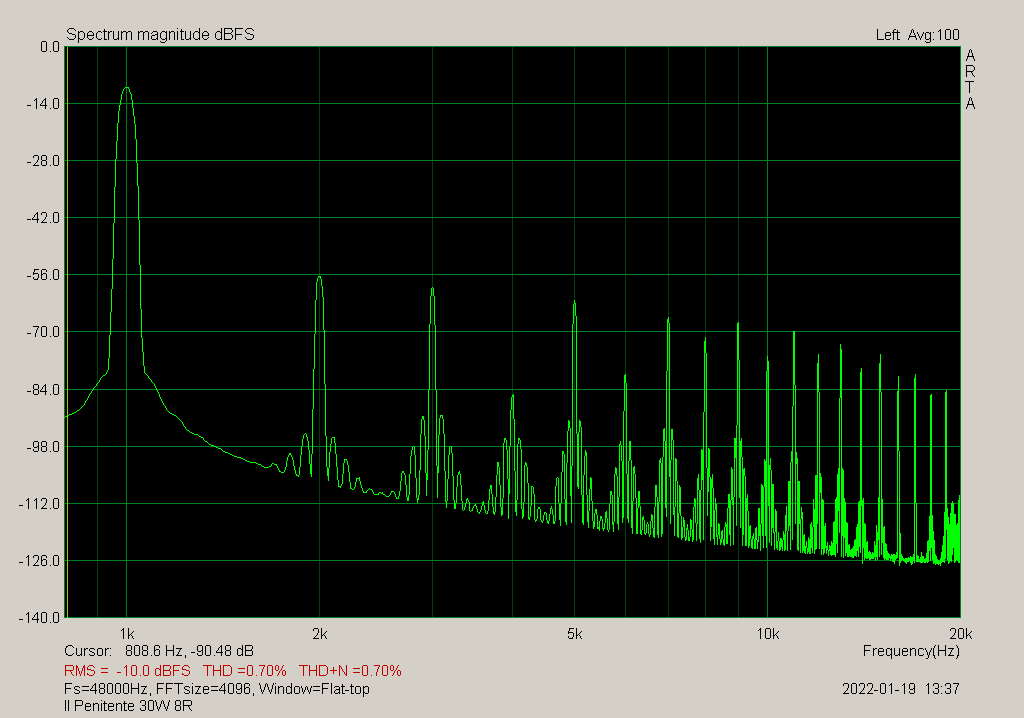

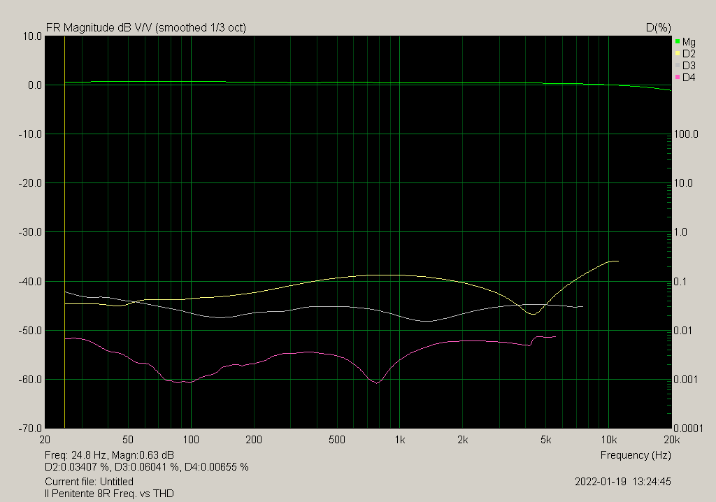

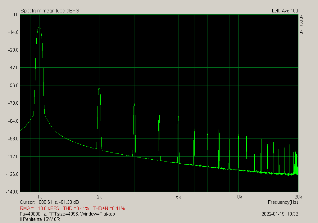

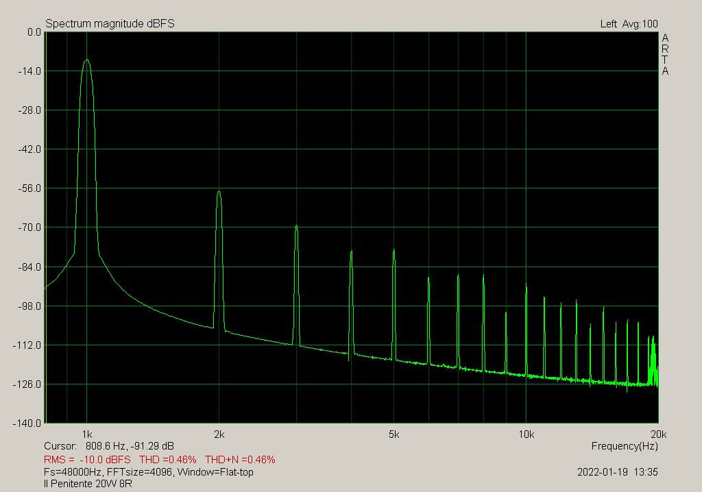

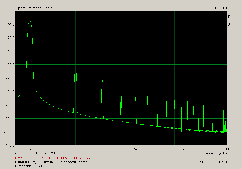

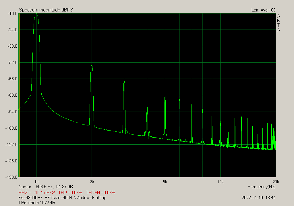

now, usual drill with 8R load

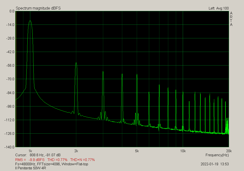

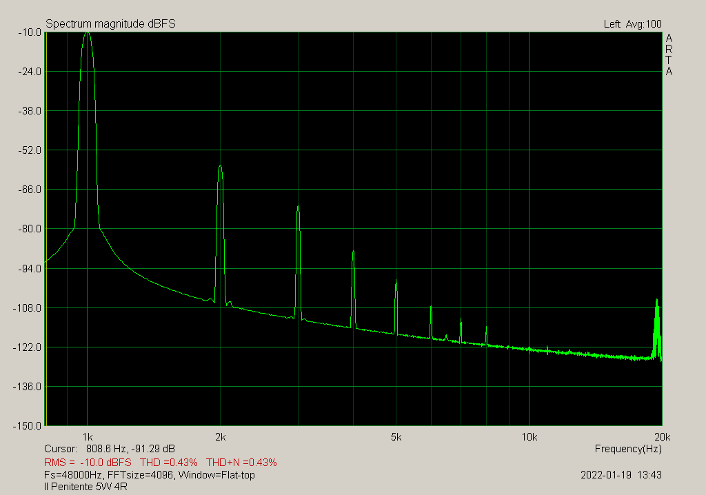

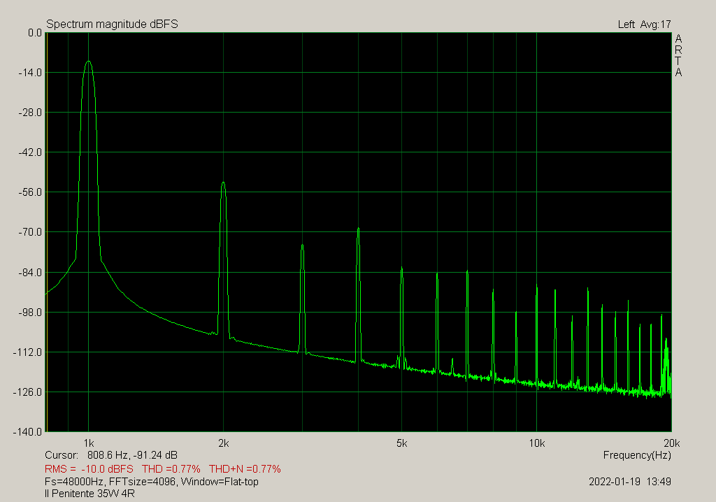

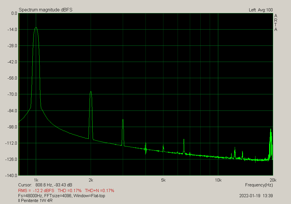

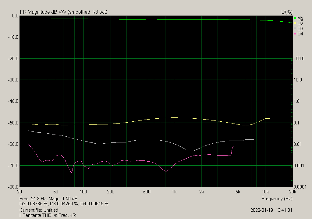

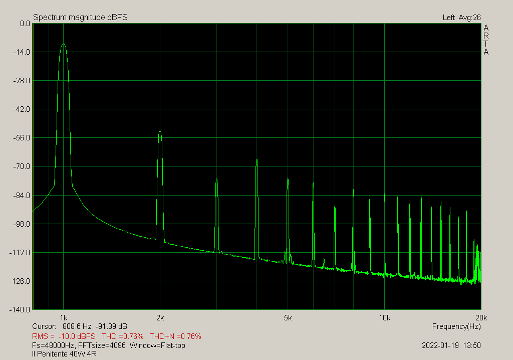

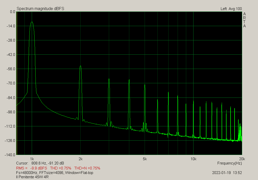

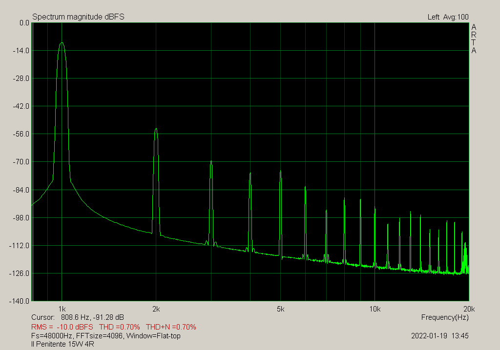

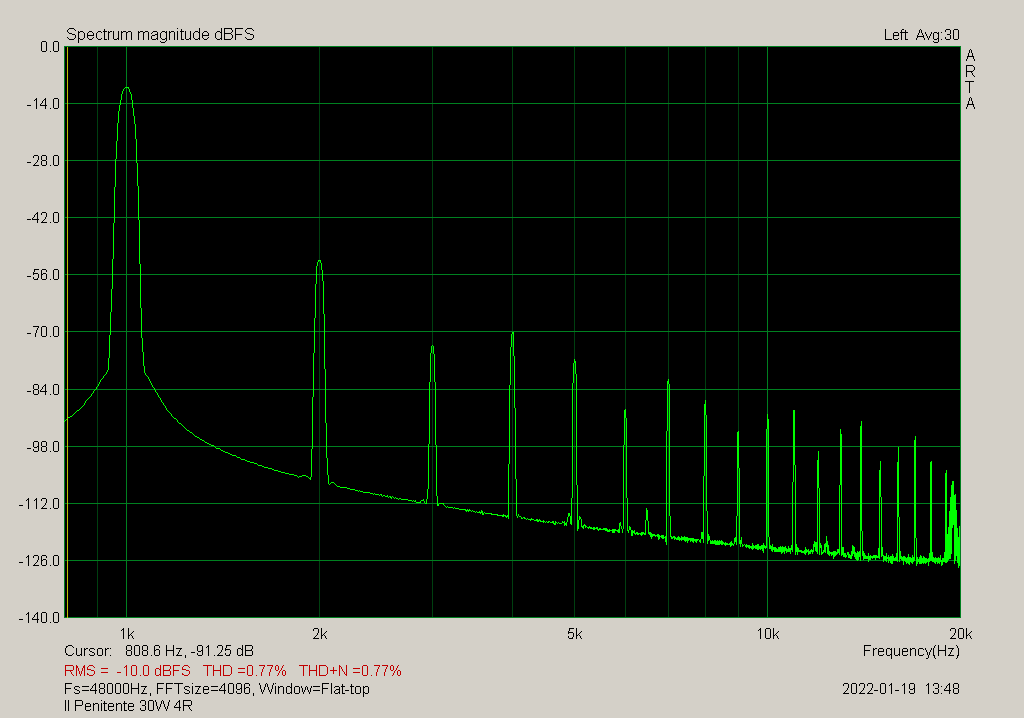

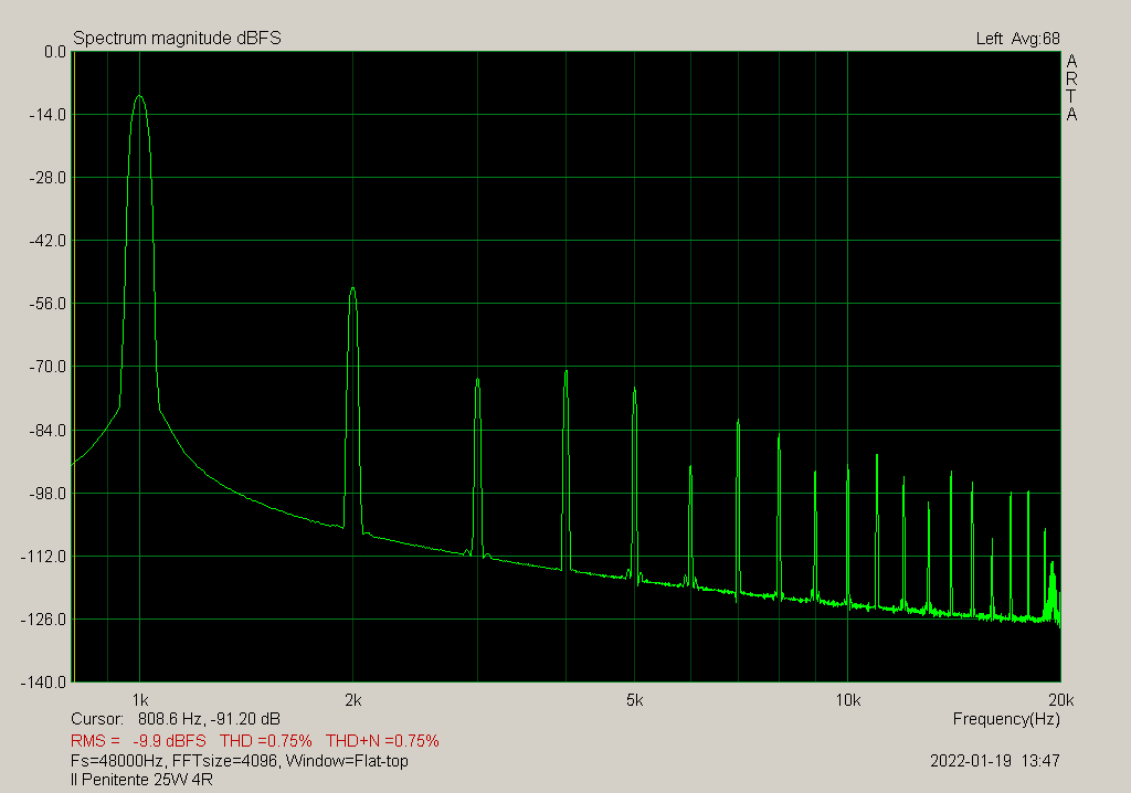

usual drill with 4R load

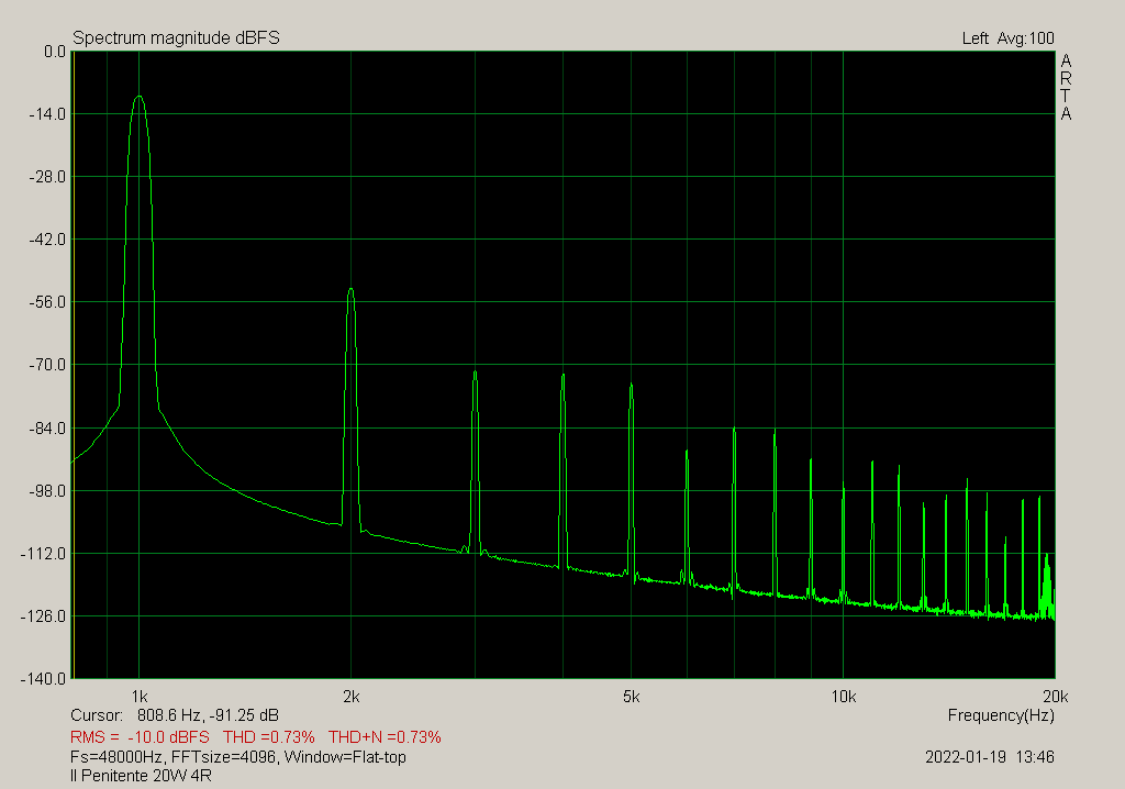

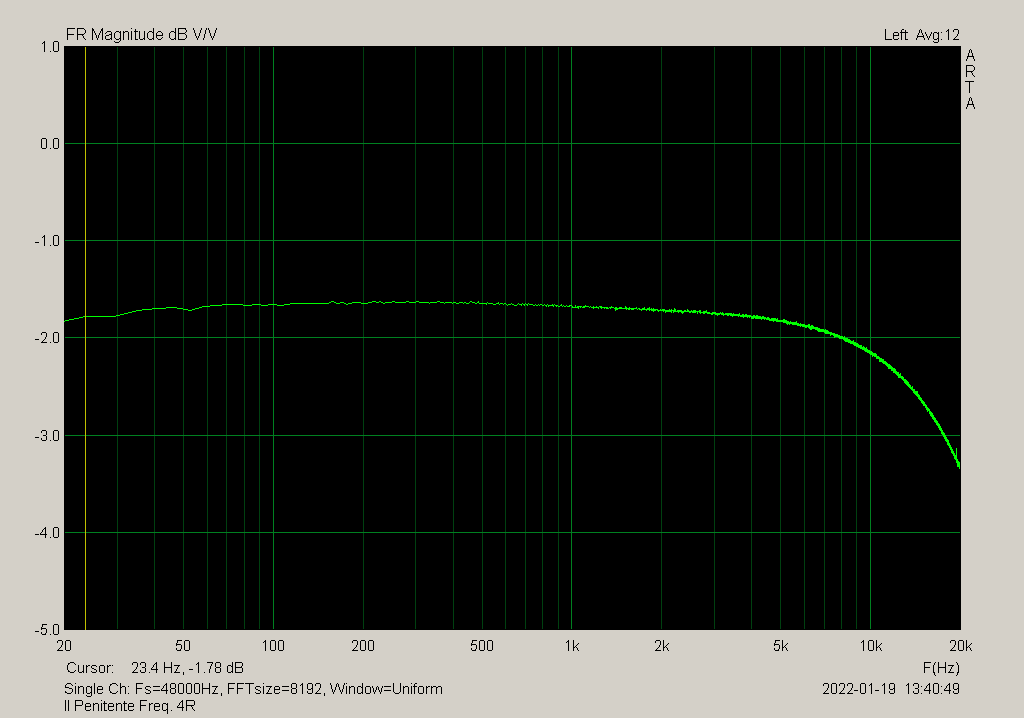

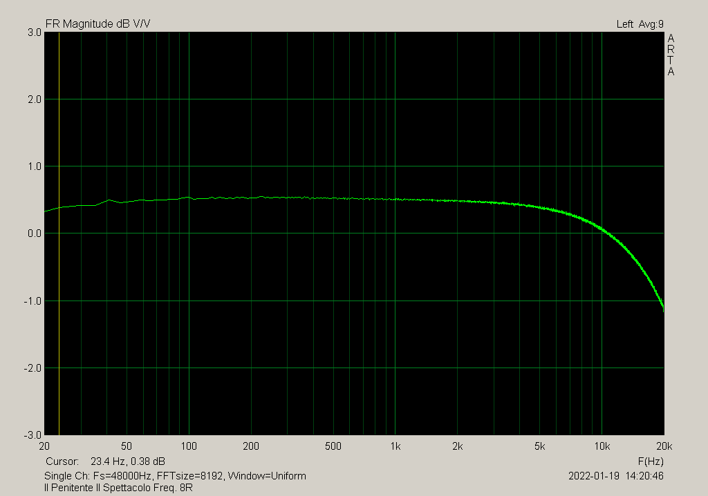

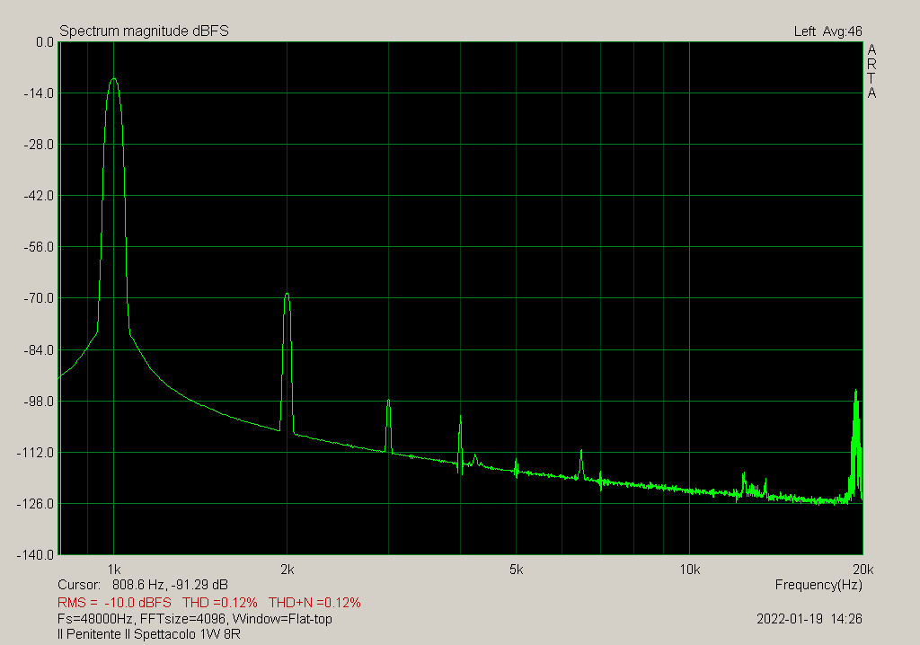

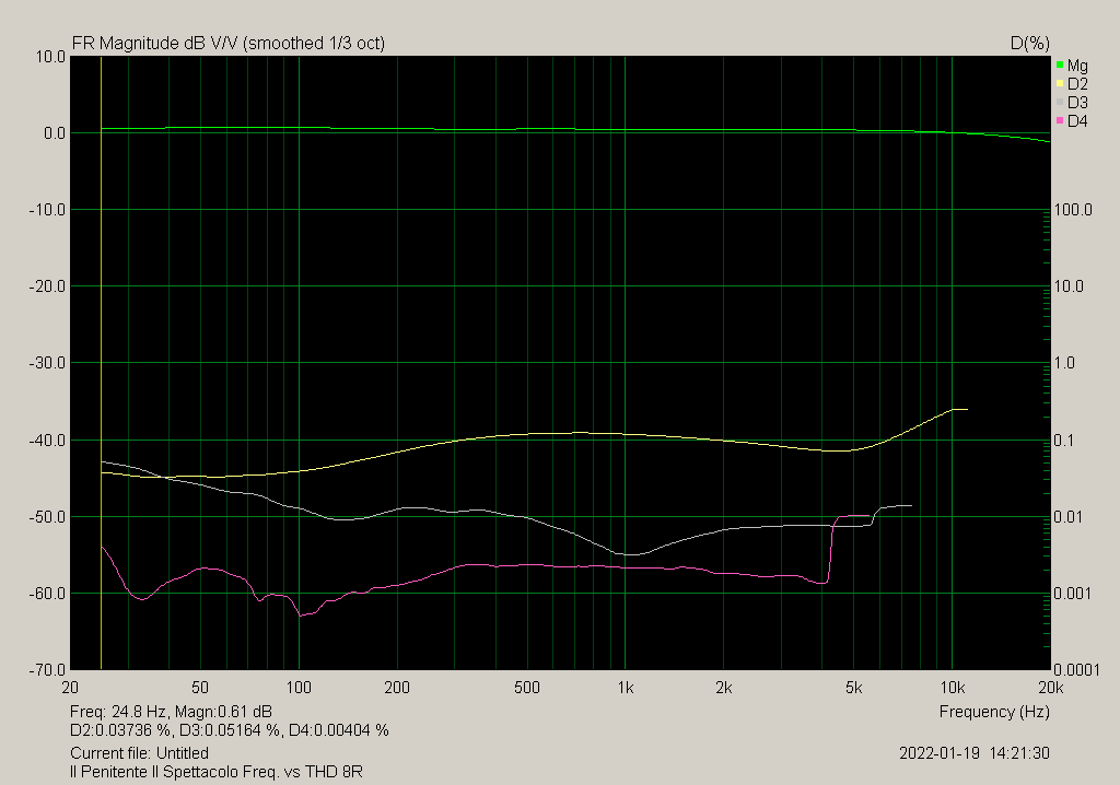

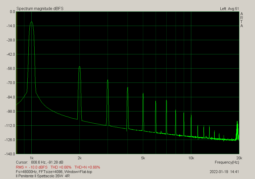

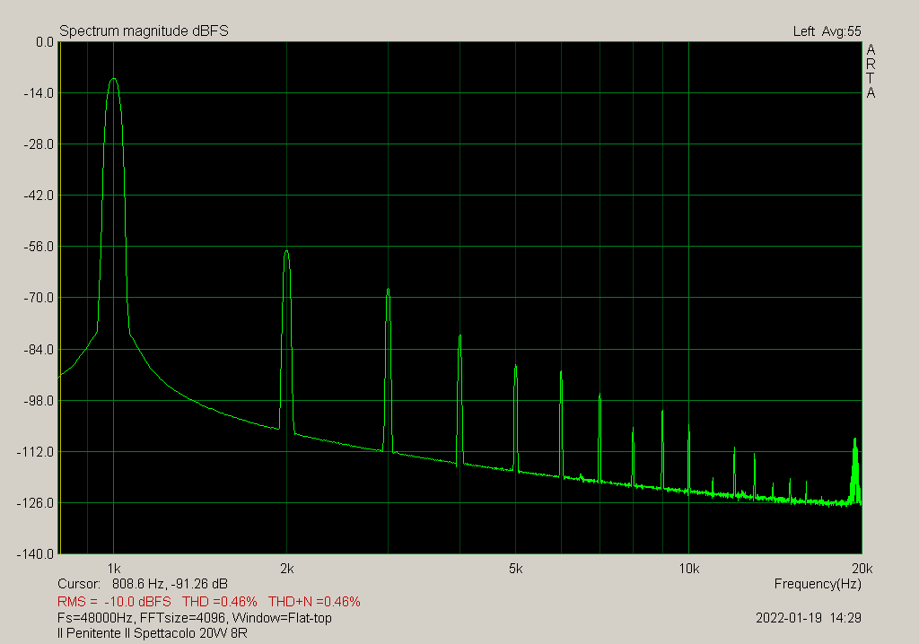

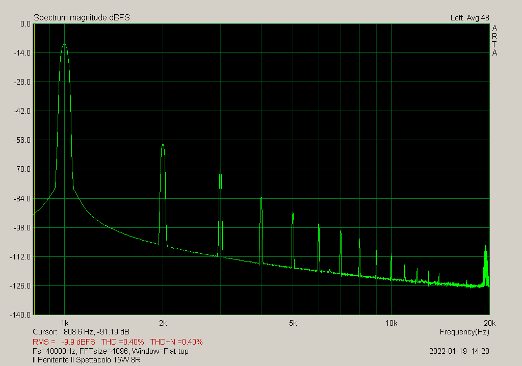

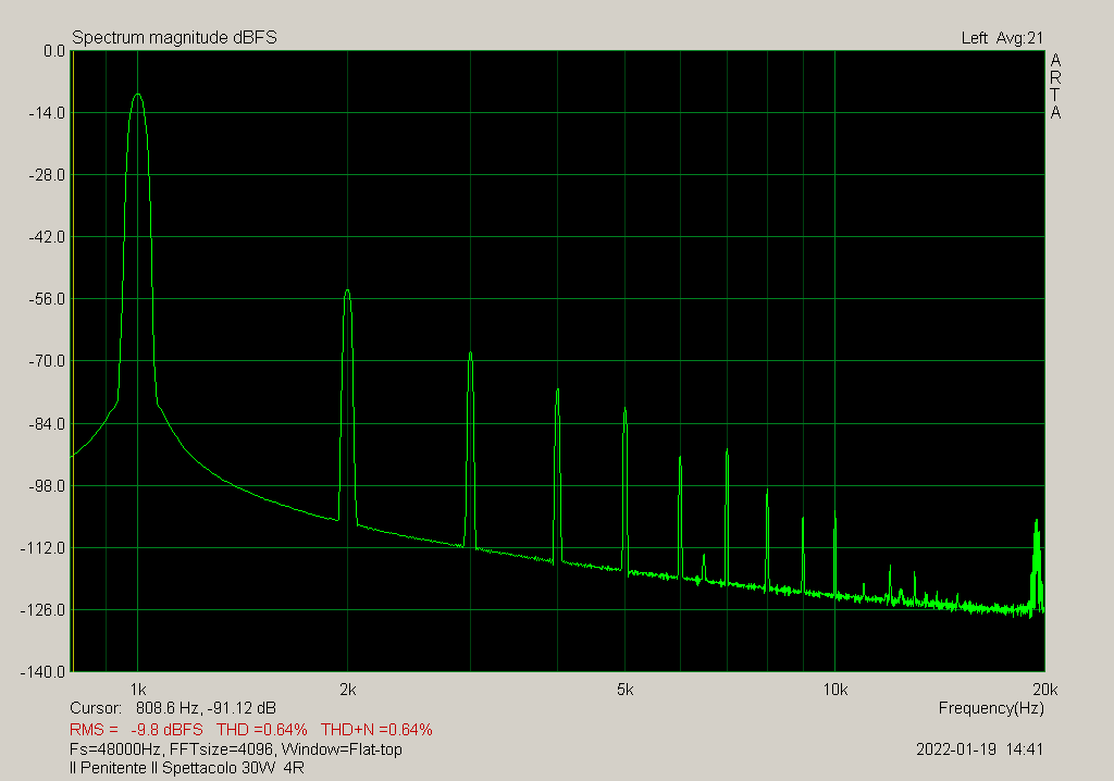

Now - Il Penitente Il Spettacolo is wakoo iteration with special parts in output stage
we can call them Insulated Gate Bastard Transistors ........ made simply by tossing out source resistors of TO220 mosfets, so mosfets are covering just base current of output BJTs
here's schm

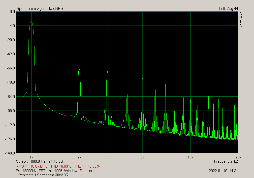

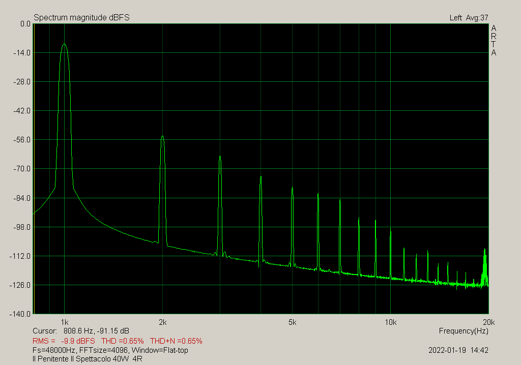

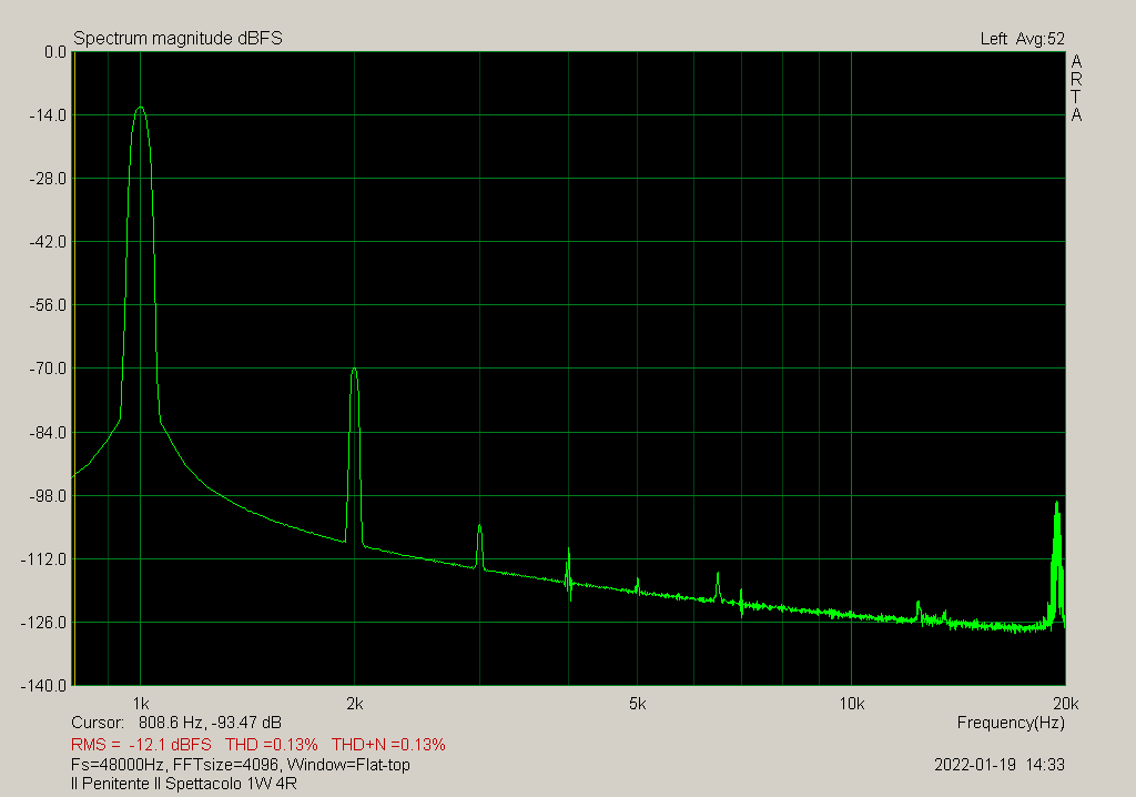

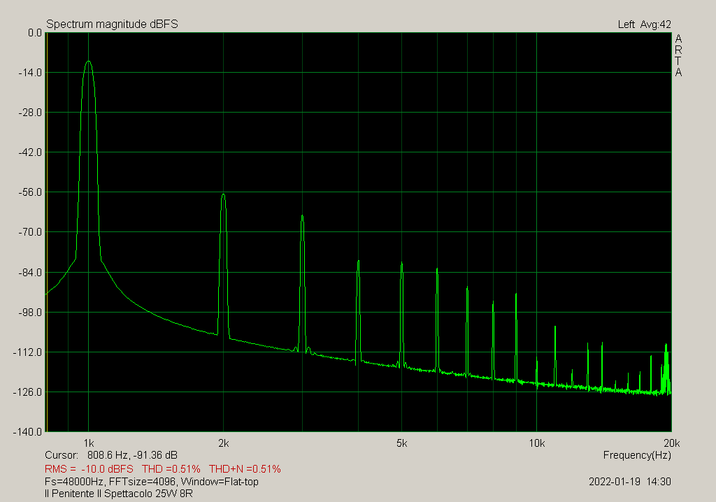

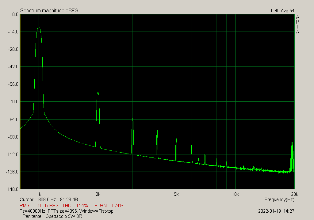

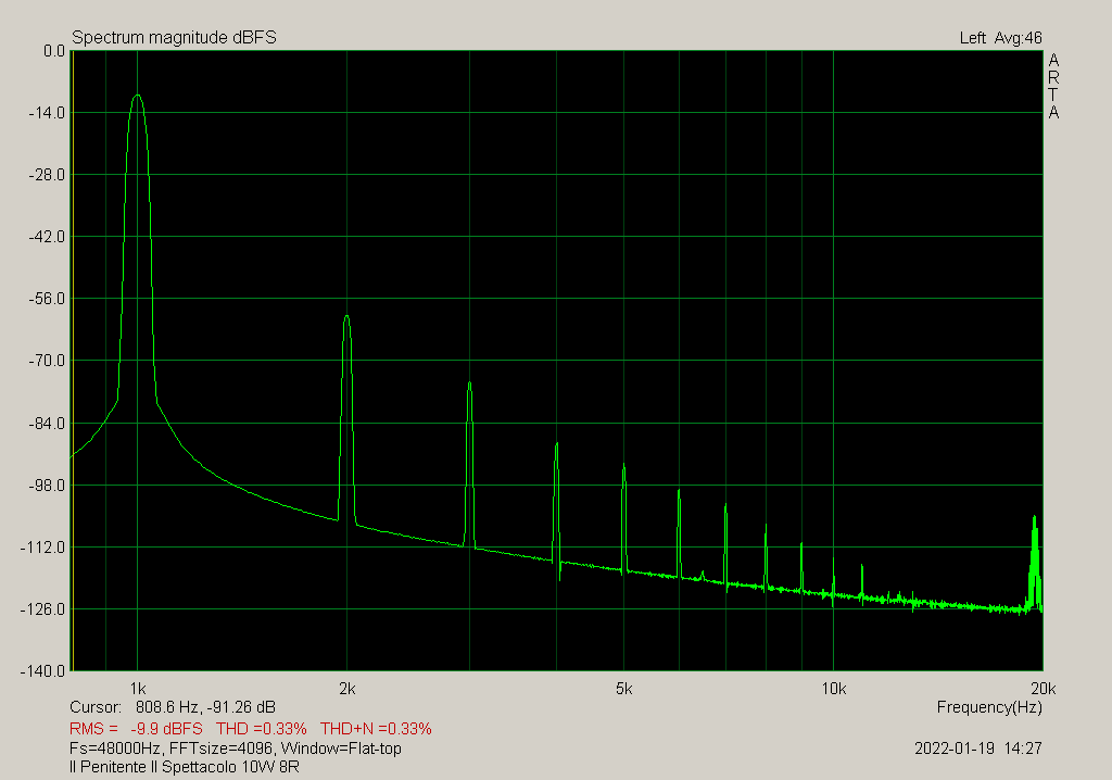

graphs, 8R load
difference to boring regular Il Penitente is - more uniform THD Spectra on all power levels

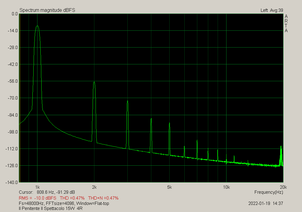

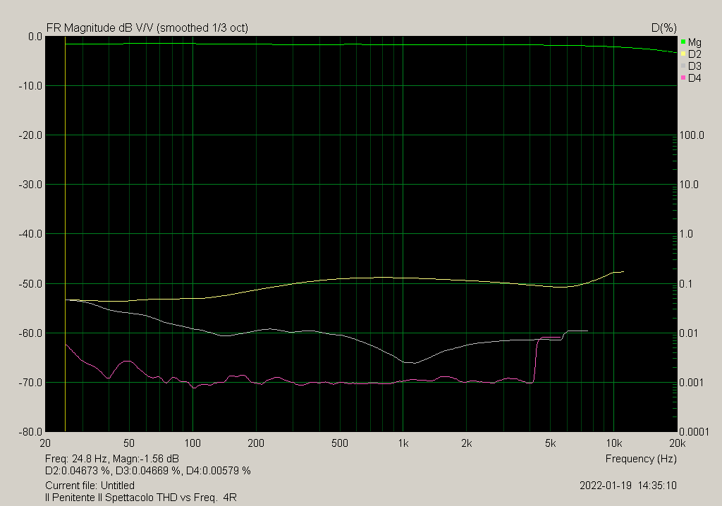

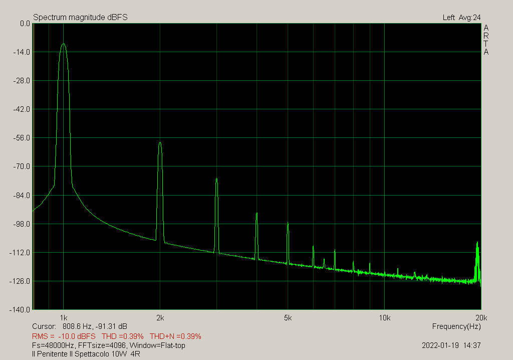

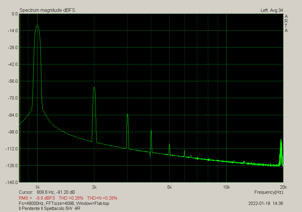

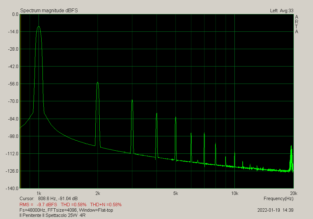

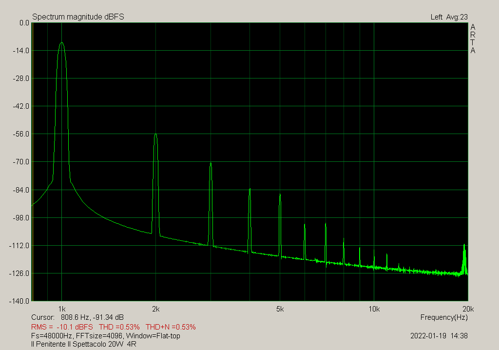

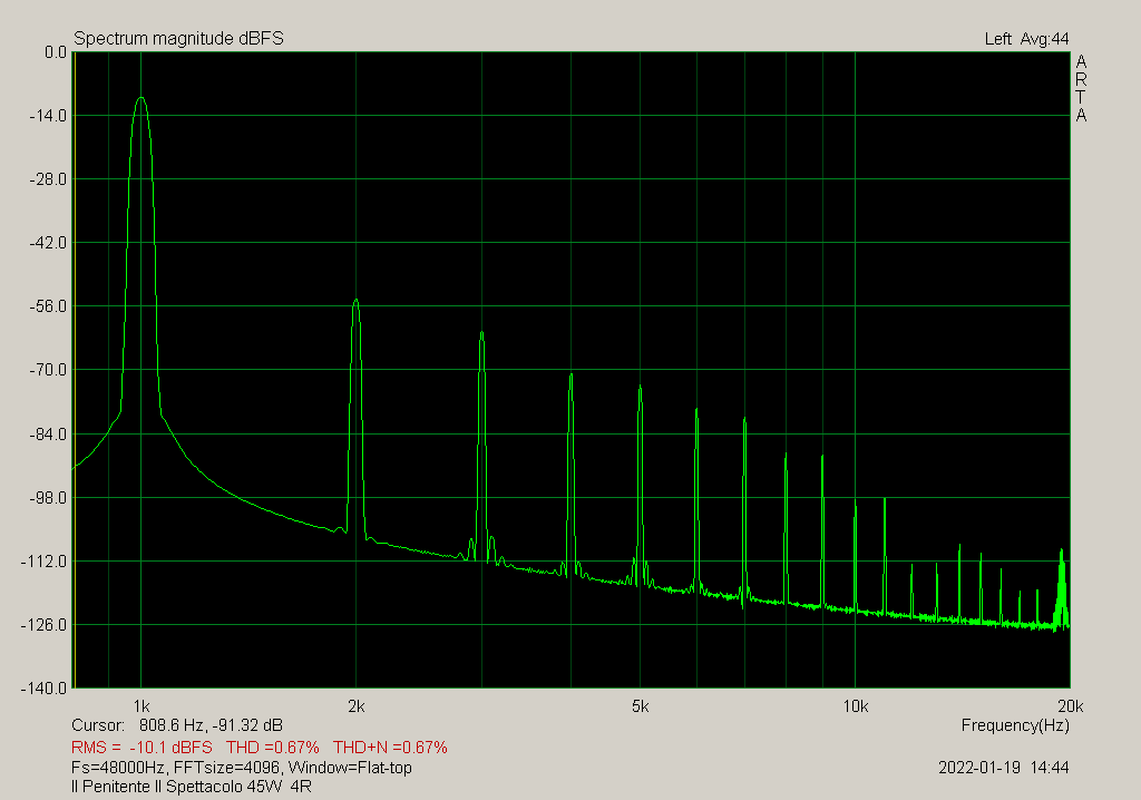

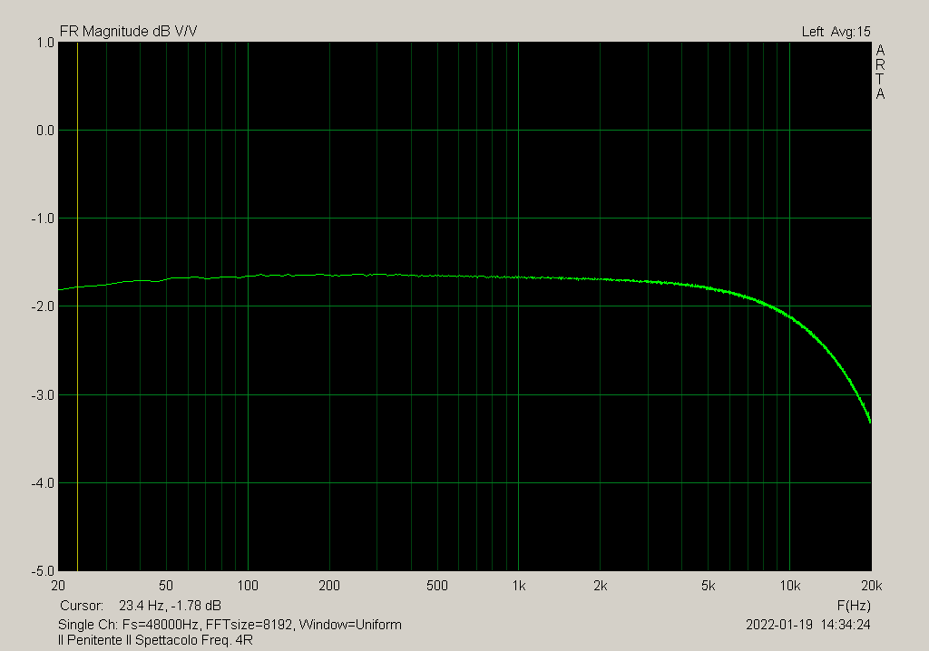

graphs 4R load
