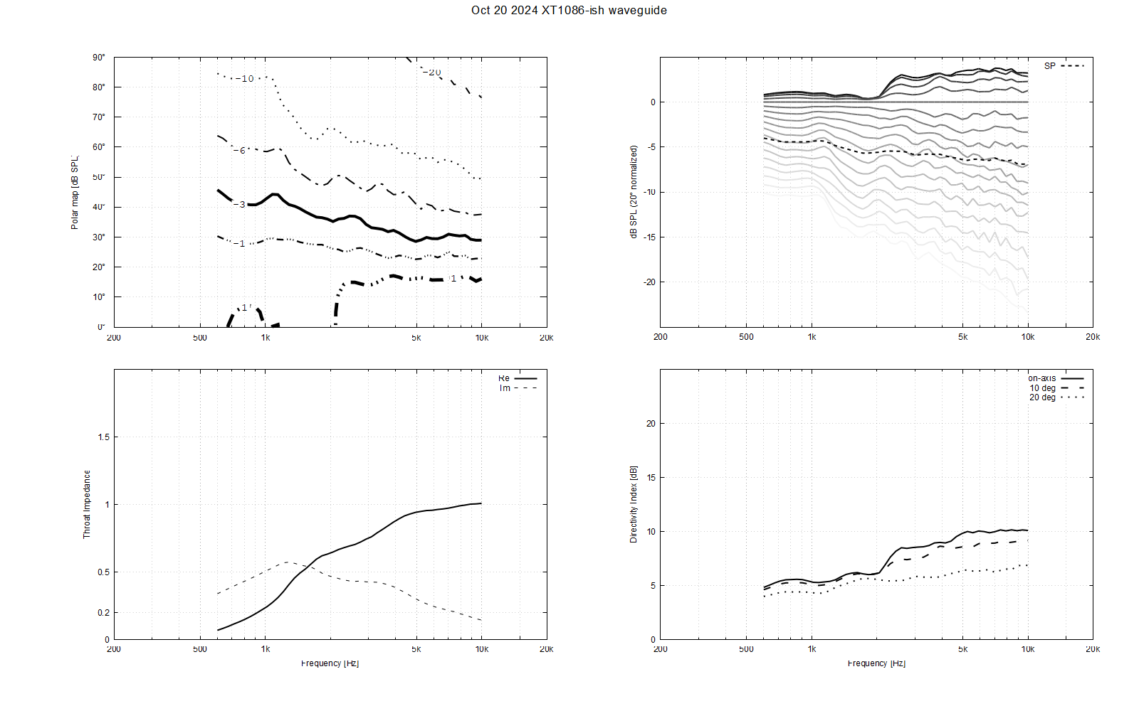

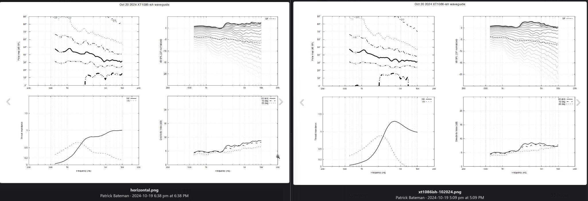

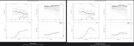

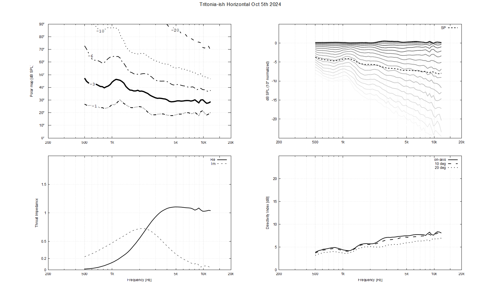

Alpha and Beta are REALLY close, but I'm giving the nod to "Beta" because it's directivity index is smoother and the off-axis response curves are smoother. In the attached pic, "Beta" is on the left and "Alpha" is on the right

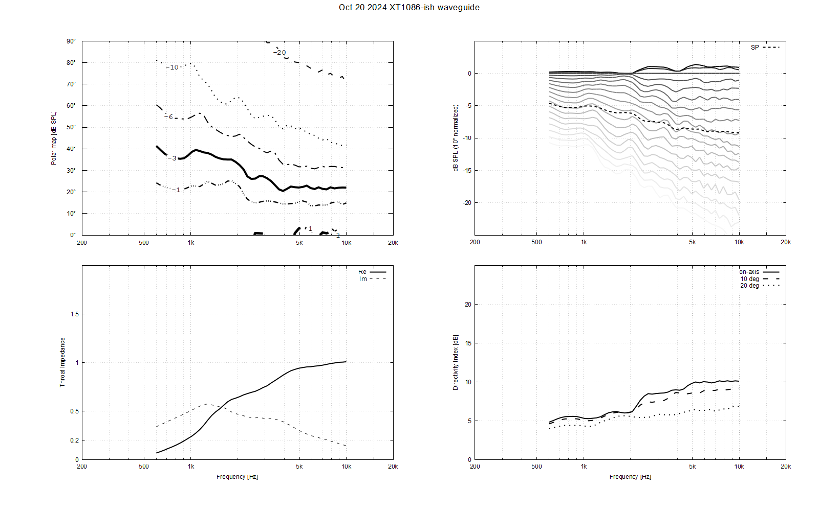

Now that I have ATH and ABEC working properly, I'm able to come up with some fairly unorthodox waveguides. (My favorite kind.)
If you look at the response of this waveguide, it's not as smooth as can be. This is true.
But my goal here, is to fit the waveguide into an Ikea Kallax.
The obvious solution is a 13.5" x 13.5" square waveguide that fits into one of the Kallax "cubes"
This waveguide is very asymmetrical, and you would assume that it's asymmetry would lead to a wildly asymmetrical pattern But it doesn't have that; note that the vertical AND the horizontal beamwidth is close to 100 x 100 degrees.
Here's how this is working:
  • The waveguide is only 314mm wide, and you would expect it to lose pattern control on the horizontal axis by 1083Hz. But the horizontal pattern is maintaining down to about 600Hz.
  • The waveguide is 548mm tall and you would expect the pattern to lose control at 620Hz. But it's obviously going lower than that (I need to re-run the sims with a lower limit to determine how low.)
  • What's happening is that the wavefront is wrapping around the Kallax. As the wavefront wraps around, it transitions from radiating into less than half space, but not quite full space. Because the output of the waveguide is radiating into a larger angle, that tends to reduce the output to the sides (EVEN THOUGHT THE WAVE IS BIGGER THAN THE WAVEGUIDE.)
That last point is kinda hard to understand, I know. Took me a while to figure out myself.
Here's one way to visualize this:
  • If the waveguide is producing a 1khz wavefront, the wavefront measures 340mm x 340mm. The wavefront is completely controlled by the waveguide, which measures 548mm x 314mm.
  • If the waveguide is producing a 500hz wavefront, the wavefront measures 680mm x 680mm. The wavefront is completely controlled by the waveguide, which measures 548mm x 314mm. On the vertical axis, the wavefront is almost completely controlled by the waveguide. On the horizontal axis, the edges of the wavefront are now wrapping around the front baffle. (Because the baffle is 416mm wide, and the wavefront is larger than that.)
  • The important thing here, is that at 500Hz, the wavefront isn't radiating into half space OR full space, it's somewhere in between. If the wavefront was much MUCH larger than the baffle, the wavefront would be nearly omni. But it's not.
  • I believe that when the wavefront is in that "grey area", it's radiating more to the front (which is half space) but less to the sides (because it's somewhere BETWEEN half-space and full-space.)
I know that I'm likely using the wrong terminology in that last comment, and in previous discussions, people who know the terminology better have described this better than I can.
Bottom line: Although this waveguide is wildly asymmetrical, it's pattern is fairly close to 100x100 degrees.

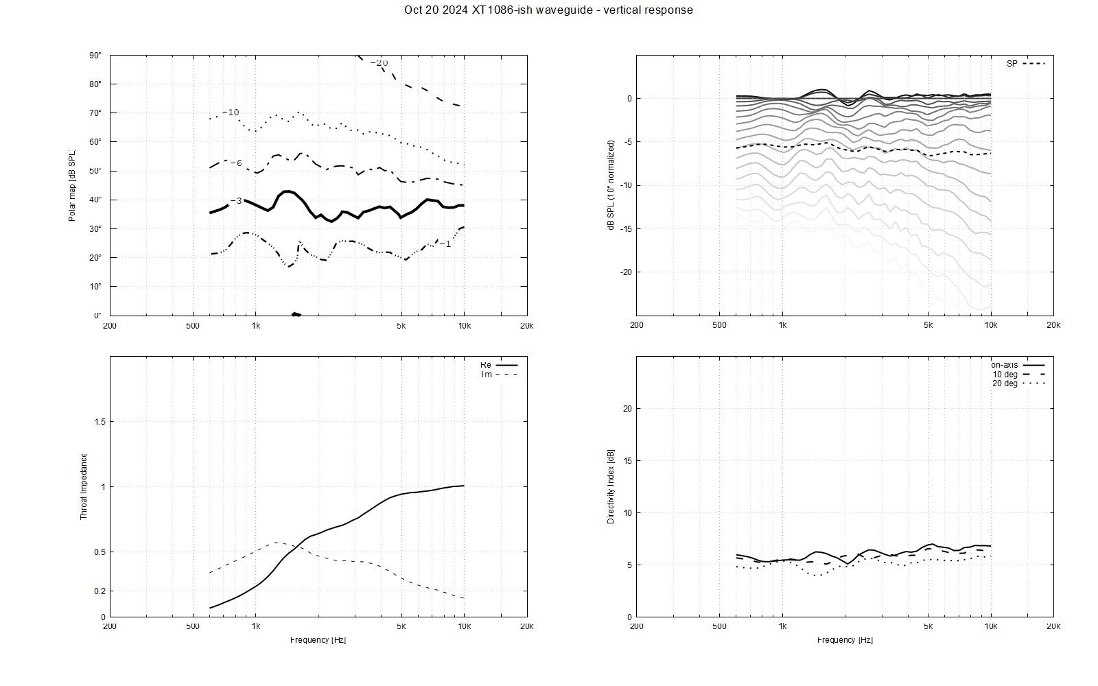

Forgot to mention:
In the attached pics from post 22, there is a pic of what the enclosure looks like, a pic of the simulated vertical response, a pic of the simulated horizontal response normalized to zero degrees, and a pic of the simulated horizontal response normalized to 20 degrees off-axis.
With constant directivity waveguides, I like the Gedlee idea of listening off-axis, but to me, it looks like the diffraction slot in my design tends to favor listening with the speaker fired straight-ahead.

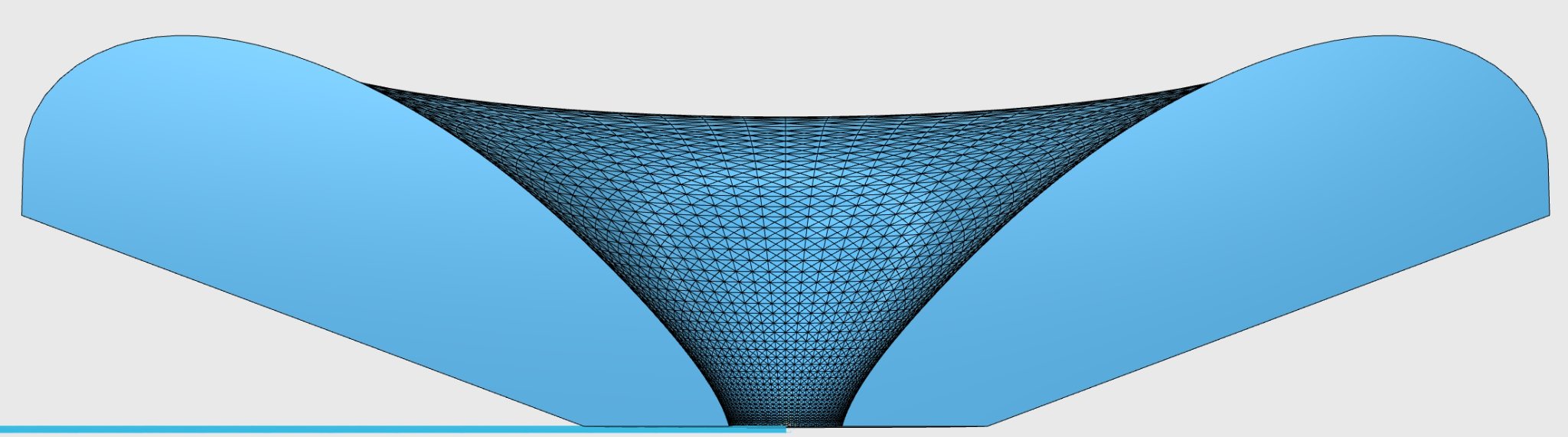

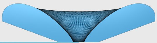

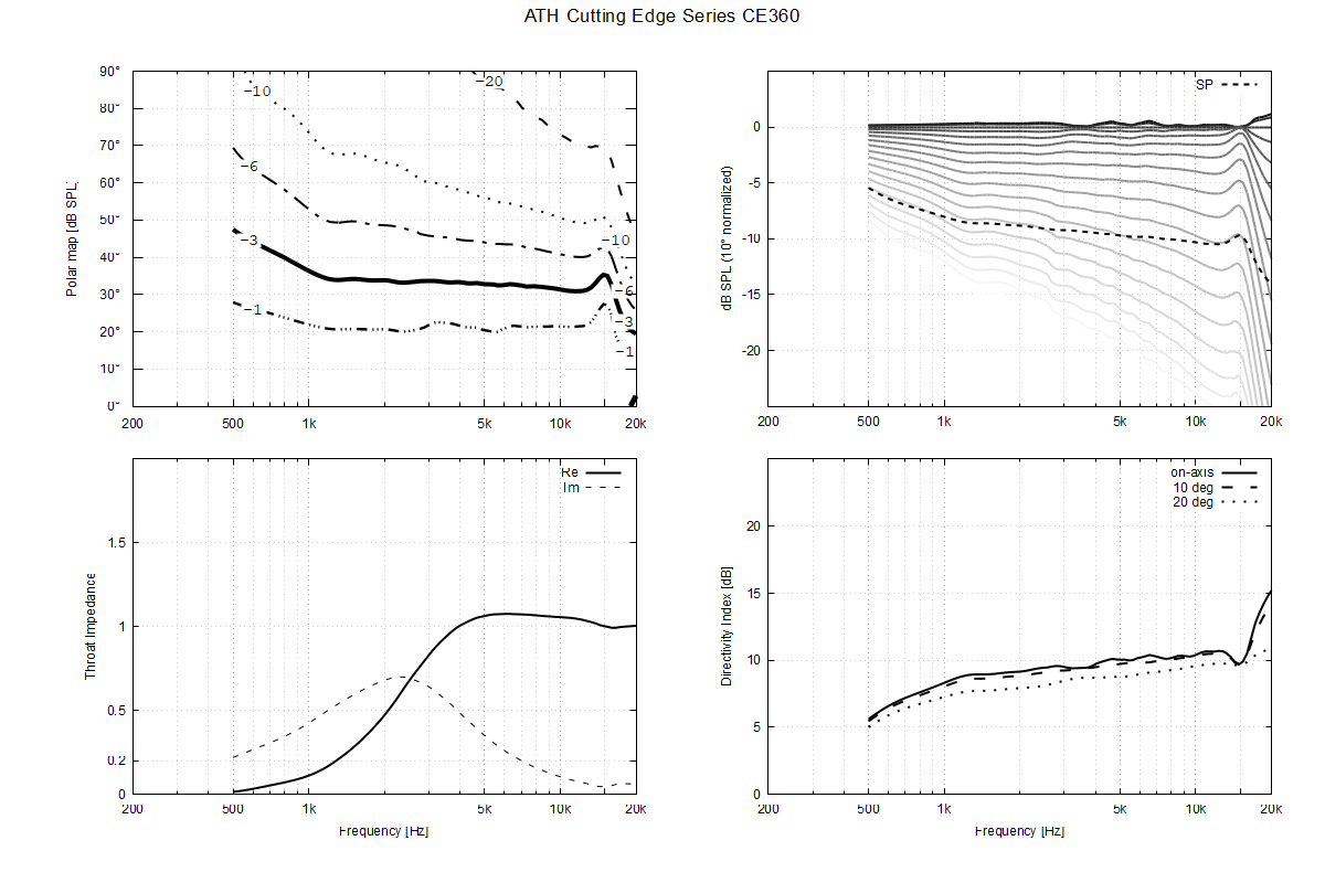

This is Mabat's "CE360" waveguide from his ATH thread. I wanted to see if it's possible to make a waveguide that's square instead of round, that performs comparably.
The reason I've posted a cutaway is because I needed to determine how deep the roundover is. It's 30mm deep. (When you use the "roundover" function with a square waveguide in ATH, the results aren't always perfectly flat. They are flat with a round waveguide.)
Here's the config file, which I cut and pasted from the ATH thread. There may be a couple of small changes.

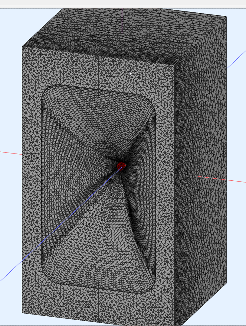

I'm beginning to see why Mabat is such a fan of waveguides that are NOT in a baffle.
I took the CE360, stuck it in a box, and the response shape changed quite a bit. The addition of the enclosure DID increase the directivity control to a lower frequency (something I've argued is possible for a few years now) but it changed the polar response and frequency response.
Perhaps the big surprise, was that there was quite a significant change on the vertical axis. IE, if the waveguide shape is similar to the box shape, things are good, once the dimensions of the box become asymmetrical (while the waveguide is symmetrical), things start to go sideways.
To me, this leads to three conclusions (which may be incorrect, TBF)
1) if your waveguide is symmetric, a box that is significantly asymmetrical may be a problem.
2) One could probably 'juggle' the box dimensions to improve this. Similar to using the "Golden Rule" for enclosure shape. Right now, the box I'm using has a height to with ratio of two to one, so that's about as bad as it gets.
Attached are the vertical and horizontal sims, with the CE360 mounted in a box. Note that the issues with the response are caused by the box itself, not the waveguide. Also note that the response is simulated on-axis, not off-axis. (The previous ones were simmed at 20 degrees off axis.)
