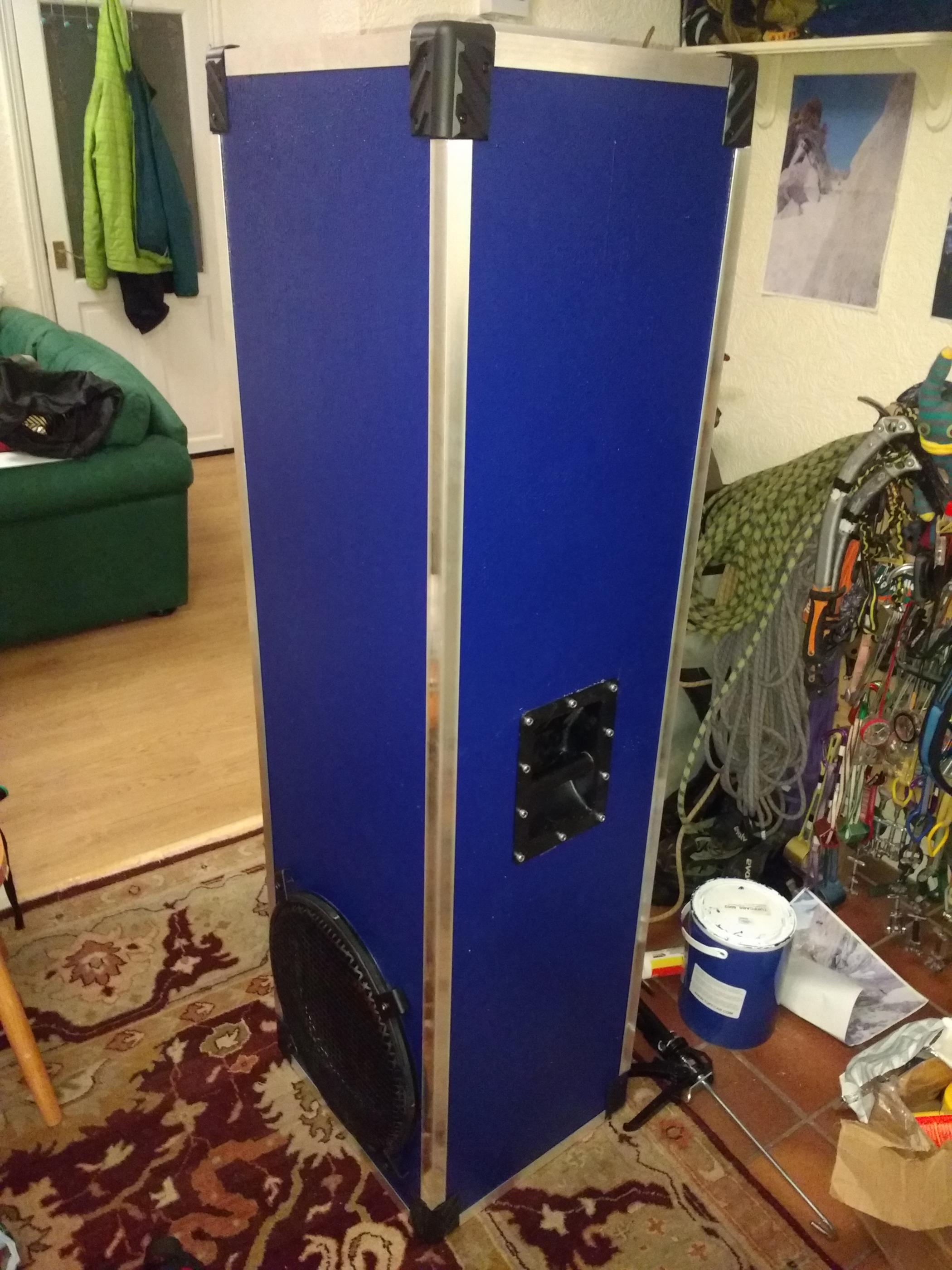

I have quite a decent sub system consisting of 12*15" drivers, sealed boxes as I obsess over low bass. Mix of 2 drivers in 200L and 4 drivers in 200L. I used cheap drivers, lose about 6-8dB compared to the most expensive, 1/10th of the cost though. I am always xmax limited. The size of my system could be halved using the most expensive drivers for the same output. My current approach also has problems with heat buildup in the boxes and power requirements as I need multi kW amps to get anywhere. This is particularly problematic if wanting to run off battery/generator power.
I had not considered using smaller drivers in horns however. If this box meets its specification it could almost match my subs using 4 boxes which would be half the total enclosed volume. The total cost would also be a lot lower due to reduced numbers of drivers and input power. Overall a better design if your willing to give up 8Hz and not quite get to 20Hz. Quite tempted to at least simulate adapting it for two drivers for more output as it could be worthwhile making a few for battery powered operation.
Interesting Sub you have there, is that blue carpet or melamine? Small cross-sectional/tall can pack very well in pickup trucks and vans, more space efficient than FLH/TH.
Yes if this 12 box rig is for mobile use, the smaller/less cabs approach would be much easier loadouts! And loosing 8Hz so your bandwidth starts at say 30 vs 20Hz (I assume EDM material), you crowd won't even notice it. Esp if outdoors, trying to produce meaningful 20Hz outdoors is not productive.

Ah yes the plan was to get all 4 boxes in my car but I made them a bit long and so I can only get two in (forgot to allow additional room for door sills). I might give in and get a van if I'm taking them around too often.
