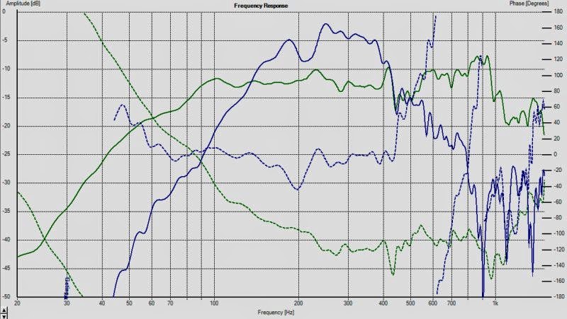

Here's a comparison of the output of the horn with two woofers, versus a bandpass box with four woofers. The bandpass box plays lower and is smoother, but the horn is louder. The horn sim shows some nasty peaks. In my experience, I've found that hornresp exaggerates peaks. So hopefully it's not that bad IRL. Also, I would like to use at least two per side, for midbass impact, and arraying the horns will smooth the response. The BDEAP is designed to be arrayed.
![nd91%2520vs%2520kef%2520-%2520frequency%25202.jpg](https://lh3.googleusercontent.com/-Ka_ghRQKFkg/U7WIi3m6gEI/AAAAAAAAIpI/yWsDUpaZK7E/s800/nd91%2520vs%2520kef%2520-%2520frequency%25202.jpg)
Here's the frequency response. The blue line is the horn sub. The green line is my Kef sub, and 8" vented box. I use the Kef as a reference when I do sub measurements.
The Kef goes lower and the Kef is smoother, but what I really wanted from this box was something with high efficiency and high output. My mains are Synergy horns, and I didn't want to 'pad' the Synergy horns, so the midbass needed to be LOUD. Based on this measurement, it looks like this midbass horn is giving me about seven more decibels output in the passband than the 8" Kef. The Kef enclosure is also twice as big.

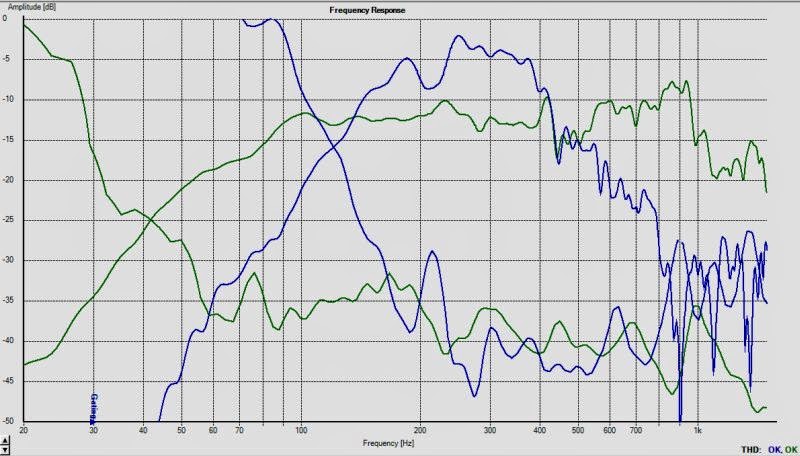

Here's a comparison of the distortion of the two enclosures. The THD of the Kef is about 20-25dB below the fundamental; the THD of the Ikea horn is about 10dB better than that. The THD of both boxes goes up like a hockey stick as you get lower in frequency, due to excursion.
![nd91%2520vs%2520kef%2520-%2520frequency%25203.jpg](https://lh4.googleusercontent.com/-V_u83tWXARE/U7WIjOR-bbI/AAAAAAAAIo4/dUyQi1am3Bw/s800/nd91%2520vs%2520kef%2520-%2520frequency%25203.jpg)
Horn subs can be a p.i.t.a. to build, but I appreciate this curve. This is the phase response of the 8" Kef and the Ikea midbass horn. Note that the Ikea midbass horn doesn't have the phase rotation that the Kef does. This is because the Kef is vented.
