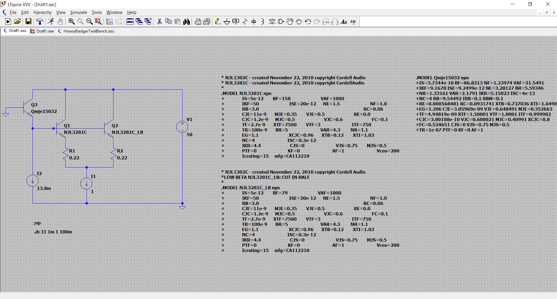

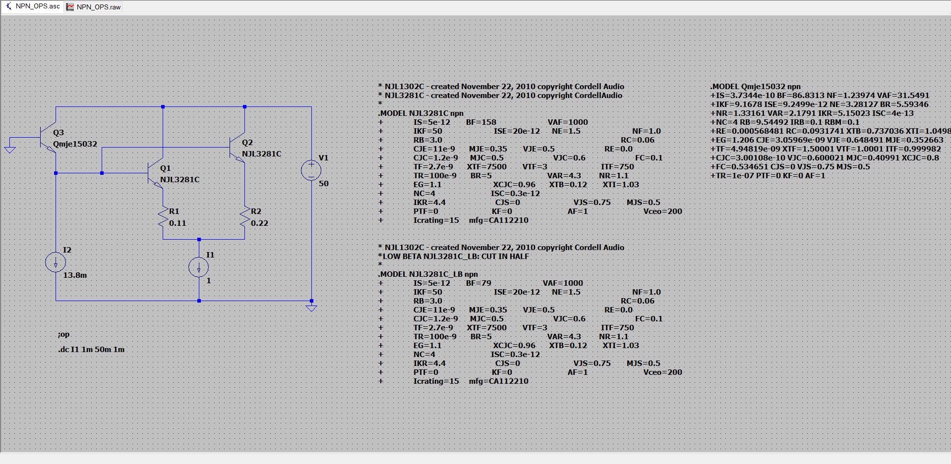

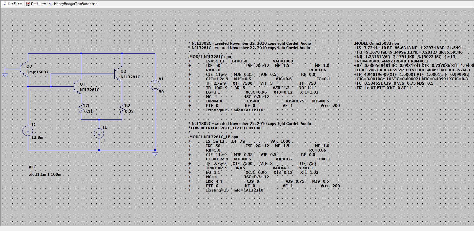

Here is a sim to show my believe.
Setup:
- Output stage of Honey Badger amplifier, heavily simplified.
- Q1 has a beta of 158 (nominal), Q2 has a beta of 79 (halved). The models are on the left of the schematic.
- Q3 is a pre-driver biased at 13.8mA, same as Honey Badger.
Simulation:

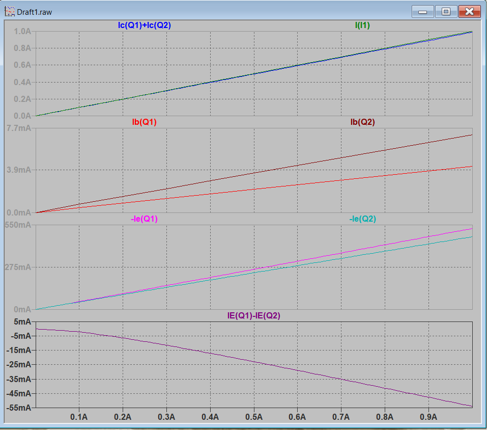

- Sweep load current from 0 to 1 Amp.
- Monitor all currents.
Results:
- Base current of Q1 is half of Q2, makes sense since Beta is half.
- Emitter currents are 36mA off from each other at 1A load current (3.6%) even though beta mismatch is 2x.
Conclusion: Beta is not a strong factor in current split.

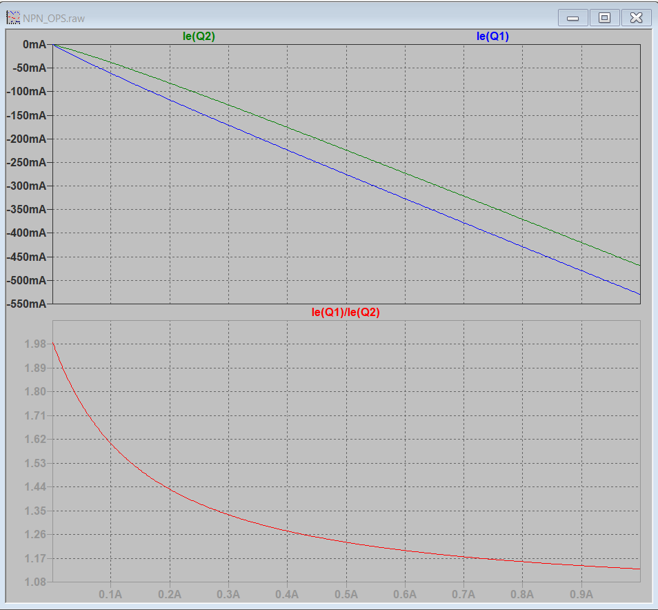

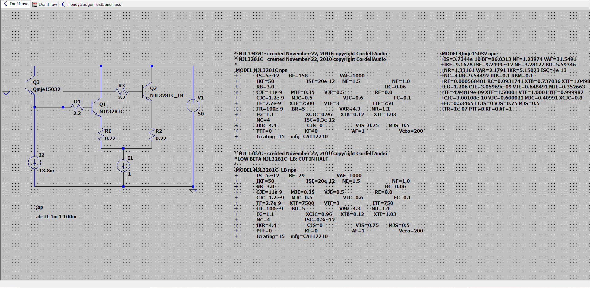

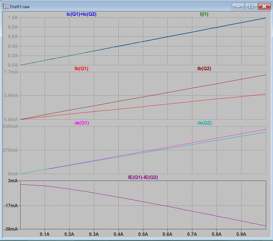

Now I repeated the experiment, added 2.2 ohm base resistors. Expectation is that split mismatch will get worse from my theory:
Sandro said:
"Beta match is important too because of the output device base resistors. Look at the HoneyBadger amplifier, each output device has 2.2 ohm base resistor. The voltage drop across these adds to VBE since the output devices are biased with a fixed VBIAS spreader. Therefore, if beta mismatches you are indirectly adding VBE mismatch to each device, which takes us to the previous paragraph."
Results: At 1 Amp, mis-match went from 36mA to 55mA.
Conclusion: Theory is correct, expected results seen, but 55mA (5.5%) mismatch for a 2x mismatch in beta is not a huge concern.

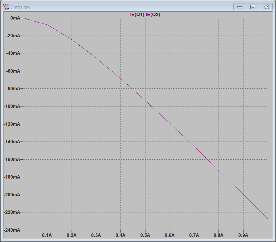

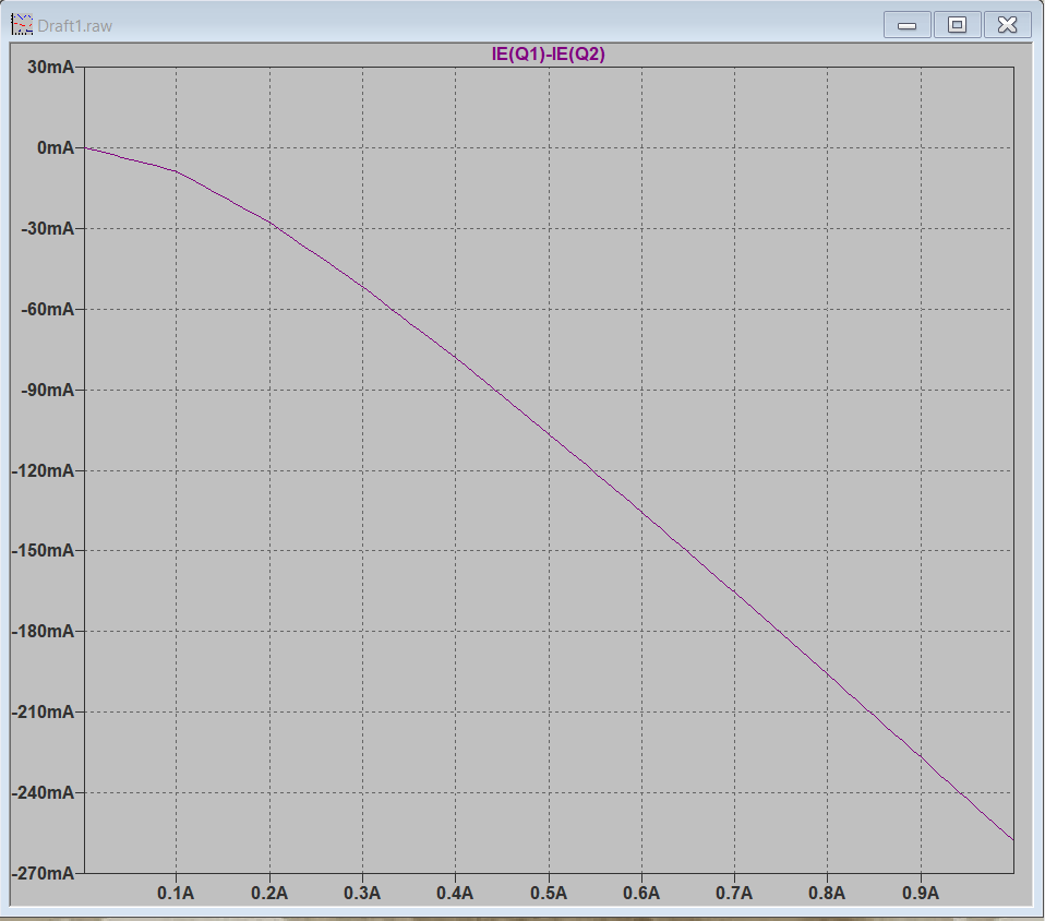

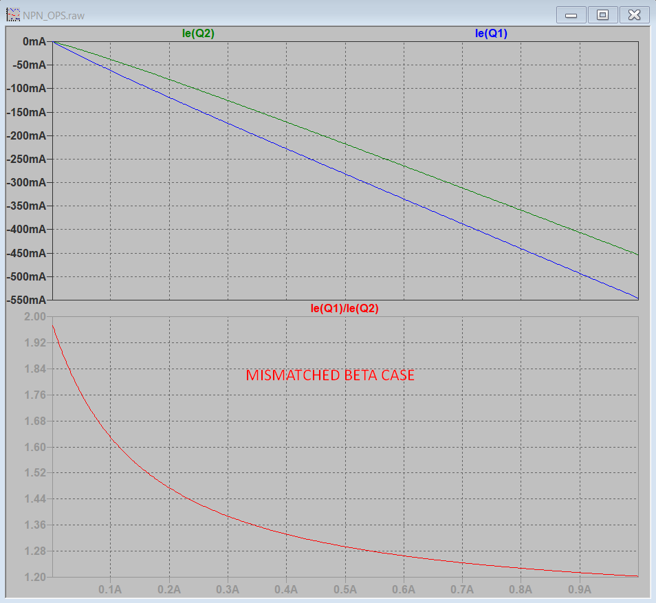

Now let's do a final experiment, mis-match RE by 2x (0.22 for RE1 and 0.11 for RE2) and run the experiment. I know this is gross, but I am trying to prove something:
A. Matched trasistors, only RE's mismatch.
B. Beta mis-matched transistors and mismatched Betas.
Results:
A. Matched transistors: IE1 and IE2 mismatch by 230mA, or 23% at 1A. This is expected, RE is a strong function of the split.
B. Mismatched transistors: Mismatched increased to 257mA or 25.7% at 1A. An increase of 2.7% over case A.
Conclusion:
Beta does have a neglible dependency even in the face of a strong RE mismatch. 2x beta mismatch caused only a 2.7% change.

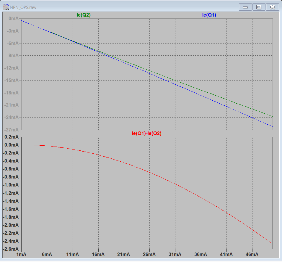

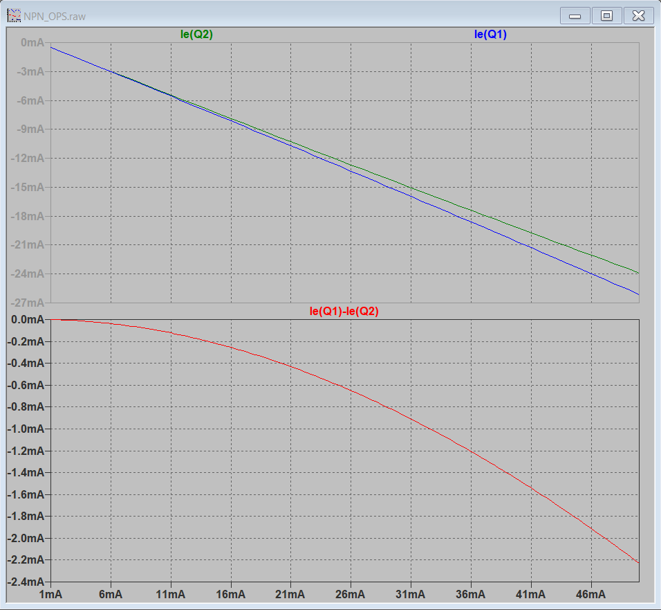

In the previous sims I was comparing at 1Amp, what happens now if we go from 1mA to 50mA, when the RE voltage is small, i.e. much less than KT/q = 25mV.?
Expected result, RE won't matter much due to not having enough voltage to do anything, and we know already that Beta does not matter much.
Setup: Same as in post 28. RE1 = 0.11 and RE2=0.22
Results:
- With matched beta transistors, at 50mA, current is mismatch is 2.2mA or 4.4%
- With unmatched beta transistors, at 50ma, current mismatch is 2.5 mA or 5%
Conclusion
- Results match expectations, at low current RE does not matter much and Beta really does not matter.
So, now the question is, what matters are low currents? VBE, see next experiment!

What matters are low currents? What determines the ratio of currents?
Expectation: VBE match
Setup is similar, RE are matched and I introduced an 18mV VBE mismatch. This is a grosse mis-match but it is for illustration purposes.
Expected behavior:
- At low current, ratio of IE_Q1 and IE_Q2 = exp(DELTA_VBE/(KT/q)) = exp(18mV/26mv) = ~2 purely due to the 18mV delta vbe introduced.
- As current increases, IE_Q2/IE_Q1 approaches RE1/RE2 = 1
Results:
- With beta matched and mismatched: In both cases the current ratio goes from ~2 to ~1 as predicted.
- In the beta mismatch case, it is approaching 1 more slowly.
Conclusion: At low currents, VBE mismatch determines the ratio and beta does not matter in a substantial way.
