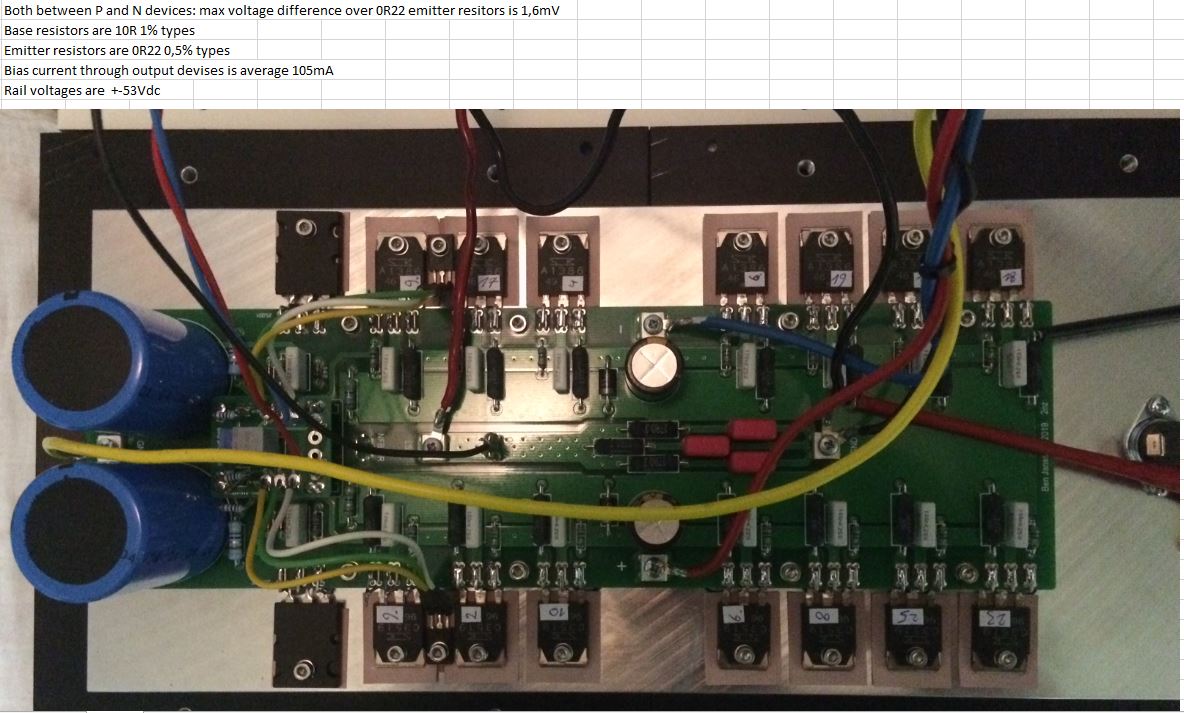

Thanks for the feedback, I'm rather happy you have the same opinion about the square wave reponse.
I just remembered I had some pictures of square wave tests done some time ago, but only with 1 pair of output devices (same circuit but different PCB).
Now we can compare the square waves done at 10kHz with a 8R//820n load.
With only 1 pair, the square wave respons is about identical, same damping but amplitude with 1 pair looks a bit bigger.
I can't quantify what I'm hearing. I have to wait until I can power up the second monoblock (I'm waiting on some copper/silver 11AWG wire for the power supply wiring), should arrive in a couple of days.
Well,
The second mono-block is running. With this one, I only used 1 pair of output devices. This to check what the difference is soundwise.
Remark, the amp with the 7 pair of output devices has burned in about 100hours currently. The one with 1 pair only a couple of houres.
1. Is there a difference between 7 pairs and 1 pair: Yes, easy to recognise
2. Difference in sound: 7 pairs = more detail, more top end. But pleasantly.
3. preference: for now the 7 pair amp is by far the better sounding one.

Hi Bensen, to be more engineery, can you measure or have the equipment to measure:
- Frequency response: 1W, half power, full power
- Distortion at 1k,2k,5k, 10, 20k: half power, full power
for both amps?
I am curious to what does "more detail, more top end" actually translate to.
BTW, for the seven pairs, did you just pick transistors from the same box or tried to do some matching. By now, I am convinced matching does not matter, but I am curious about what you actually end up doing.
