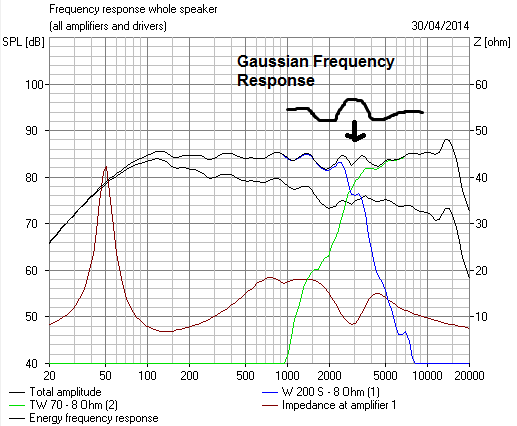

Here's something interesting about series filters. They align phase very well, but I talked about sacrificing flat frequency response. Whenever I do these things, I end up with a gaussian ripple on the frequency response, here a third order series filter. It's a feature! Quite pretty really. It's in the impedance too. Sorry about my poor drawing skills.
I could add that series filters have a flatter power response than parallel, which was one of Bud Fried's notions that I agree with.

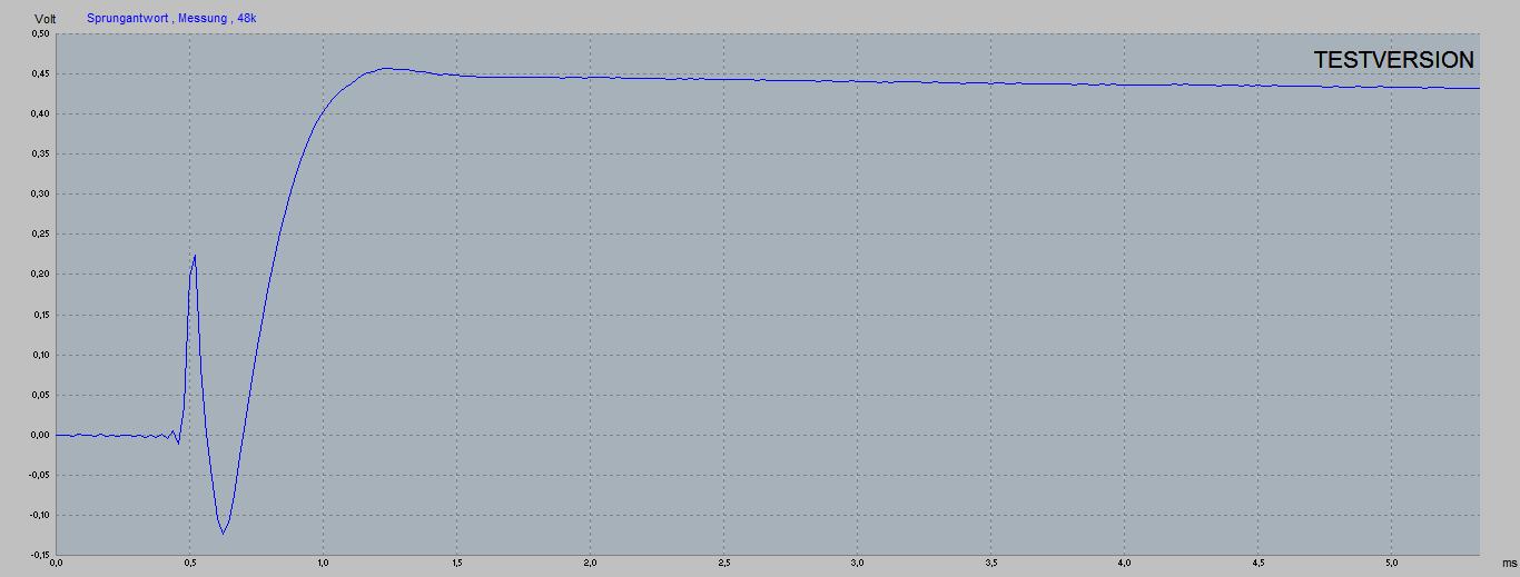

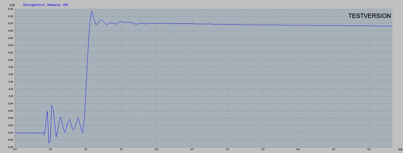

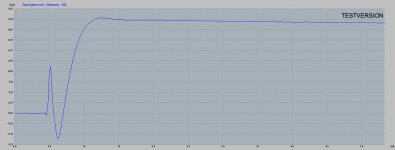

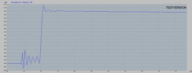

The first picture shows the measured step response of an asymmetric active crossover with low group delay. The second picture shows the same crossover fed via a group-delay equaliser made from 2nd order allpass filters. There is cleary some pre-ringing to be seen which happens at higher frequencies.
What happens when this is applied to a small coaxial speaker (together with some amplitude EQing) is shown in the third picture: A very nice step response.
Regards
Charles

I suppose that is equalising the time delay between the main cone and the whizzer in effect.
I remember having a look ar Zaph's ZD5 filter, which includes a second order allpass network in the 2nd order tweeter filter to fix the time alignment. B&W did something similar in one of their models. Very few people would even understand what it does.
It sure looks impressive, until you try a 4th order tweeter filter. It does exactly the same thing!
I am determined not to drive myself crazy with these things. There always is a flaw, just like the old perpetual motion machines. 😀
Technically you are absolutely right but from an engineer's point of view it is unsexy ! 😉
