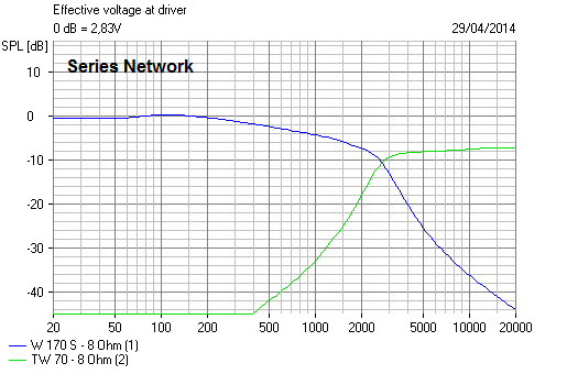

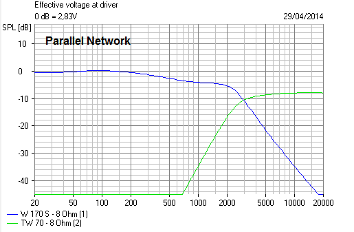

People claim great things for series filters, as opposed to the regular parallel filter. There IS a measurable difference, and they do seem to align phase better. I don't know really. But impedance curve is totally different, and the rolloff is gentler. Perhaps another trade-off.
See below for example filters that do similar things to frequency response and phase.
