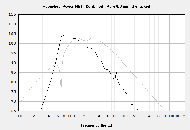

upper mass corner (Fhm) = (2*44/.35) = ~252 Hz
min. throat (St) = ~13543/pi/252 = ~17"/43.45 cm
mean center = sqrt(44*252) = 105 Hz
min. mouth dia. = ~13543/pi/105 = ~41"/104 cm
traditional prosound tuning = 1.56*Fs = ~69 Hz
  • BC12PS32pro_horn.txt

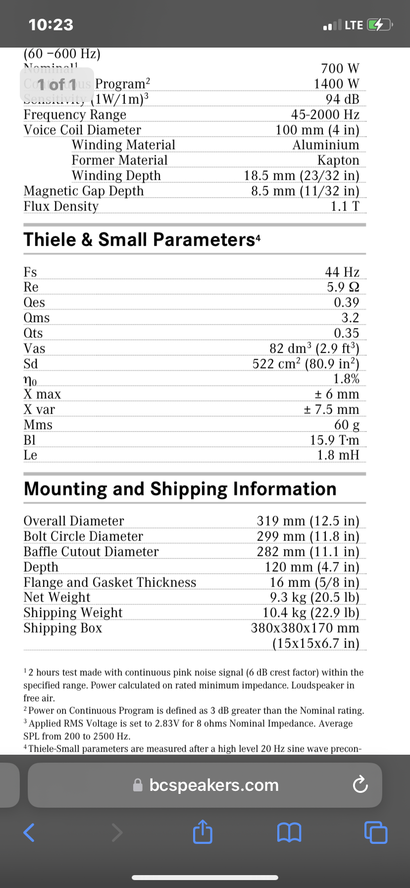

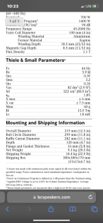

using ps32's smaller ''brothers'' the pz32's
Although the 12PZ32 has a 3" voice coil and lower thermal power handling, the gap depth and winding height are both larger. More importantly, it's Qts is much lower and BL significantly higher, so it has a much stronger motor than the 12PS32.
So for PA, using the 12PS32 I would look at the MTH30, for home use I would consider the ROAR12. At PA volume the THD might become to significant in the ROAR 12.
