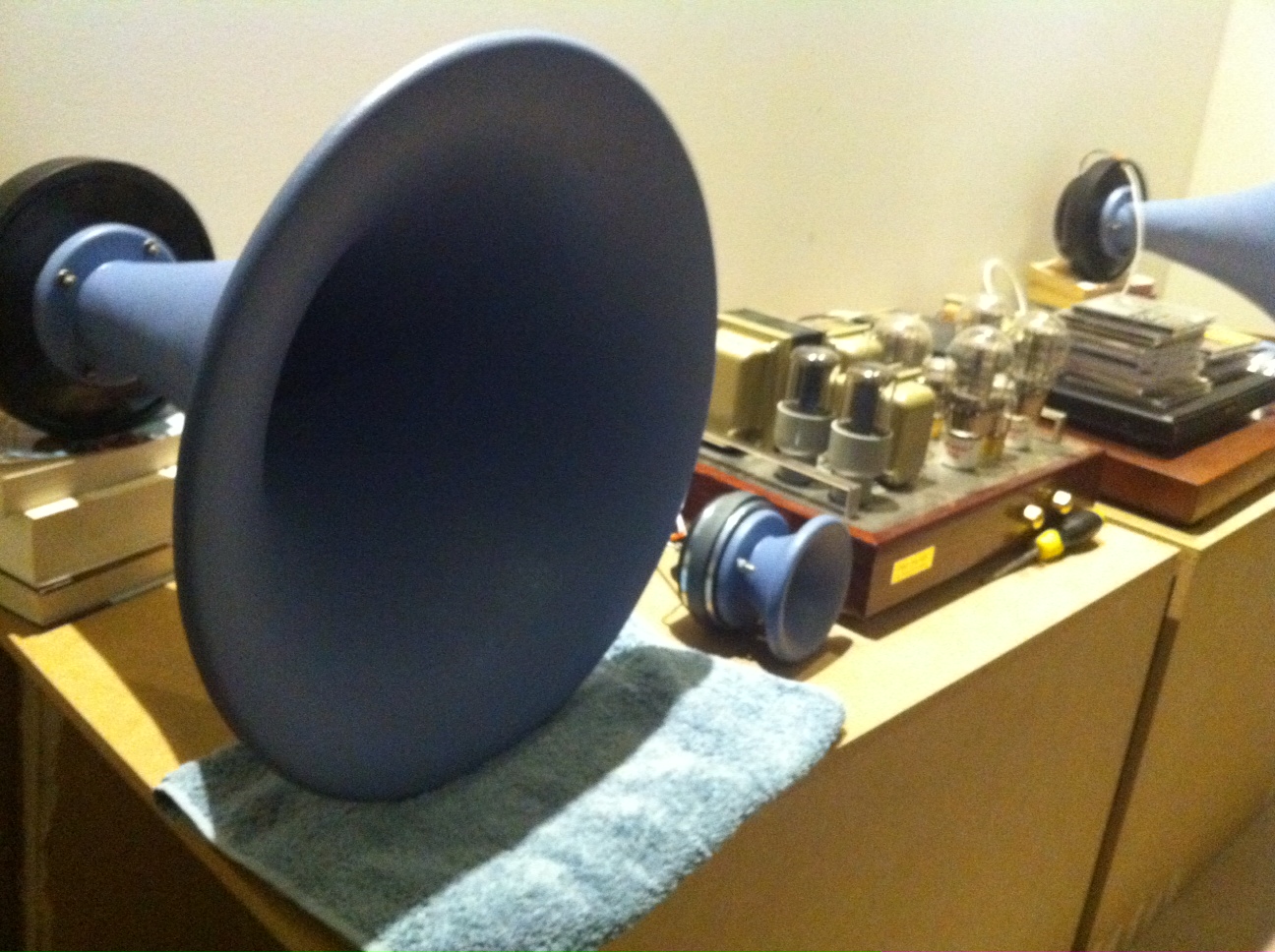

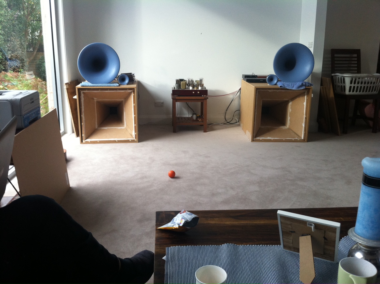

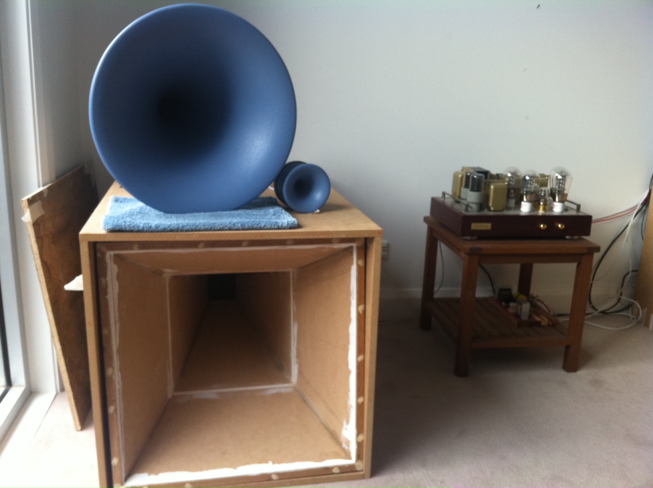

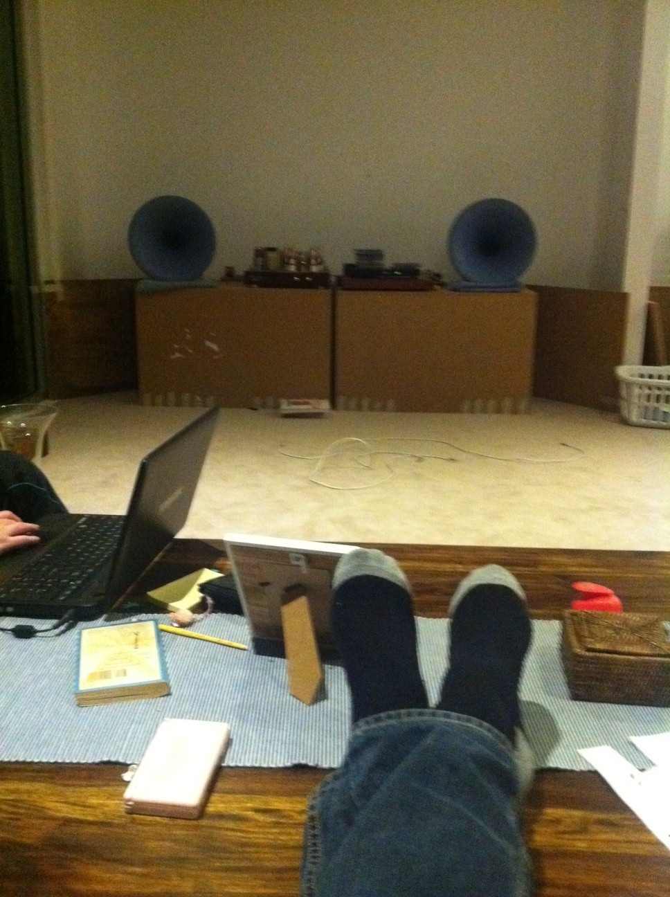

Sounding lovely after a day of run in.....go the horns...!!
This weekend, I'll move the mid bass horns to fire out into the room....
Gotta start my 30Hz tapped horns too.
All fun.
