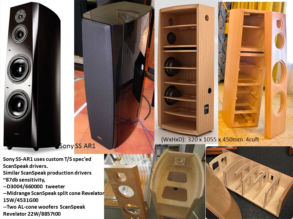

There are a few reviewed TM designs using the SB26ADC-4 1" Aluminum Dome Tweeter and SB17BAC35-4 6.2" Aluminum cone midbass which include measured frequency and impedance data which closely match my simulations. You can scale these cabinets to required TM-WW volumes. The TM-WW is very popular in production speaker designs because a pair of 8" woofers has the same surface area as a 12" woofer, but allows artistic 10" - 10.5" wide cabinets like the award winning Sony AR1.
