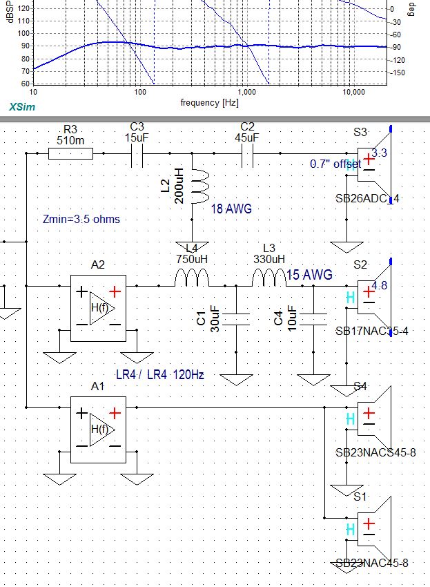

There will be more diy cabinet design wood work to get the final dimensions with my suggestion than a complete kit. You could download the free miniDSP 2x4HD manual to study the capability, complexity, and judge if it meets your goals. You could visit miniDSP discussion forums (one on diyaudio) to ask questions and get DSP programs which could cover your requirements.
There are a few reviewed TM designs using the SB26ADC-4 1" Aluminum Dome Tweeter and SB17BAC35-4 6.2" Aluminum cone midbass which include measured frequency and impedance data which closely match my simulations. You can scale these cabinets to required TM-WW volumes. The TM-WW is very popular in production speaker designs because a pair of 8" woofers has the same surface area as a 12" woofer, but allows artistic 10" - 10.5" wide cabinets like the award winning Sony AR1.

I don't understand if it is about a small theater or a home theater, two or three designs come into mind according the size of the theater and budget:
zaph Zaph|Audio - SB12.3 3-Way Tower a kit exists
Weltersys member synergy two ways or if small home theater : Bawslo's "synergy box"
a DIYSOUNDGROUP hometheater design
there are certainly many else... but all those seem to be very good quality and more or less in the budget 🙂
