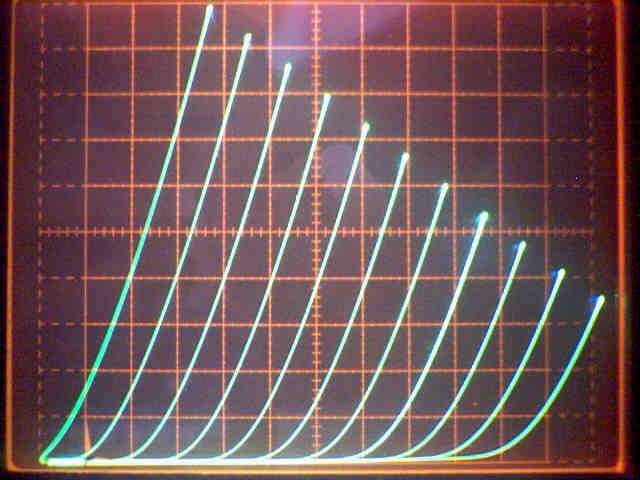

But triode tubes, even if not externally degenerated, also have local feedback from their internal space charge. And pentodes (which removes the space charge feedback) aren't even particularly linear, though they do tend to have lots more gain than triodes which lose gain from their internal feedback. Tube amps without any degeneration applied are rare and still have internal local feedback. Without feedback, most amplifying devices aren't very linear (a possible exception is some power MOSFETs when run at very high idle currents, but that's higher than they can usually live running at at usable voltages).

A high performance SE amp is intrinsically very expensive but surely many of the skilled members of this forum have managed to build such. I wonder, though, if is it really possible to reconcile the contradictory requirements of the output transformers without taking the most extreme measures. What I really cannot understand is how it is possible to look at a set of valve characteristic curves (any valve) and maintain that distortion can possibly be minimised without using any feedback.
There's a good section in the Langford-Smith book where he plots virtual characteristic curves to help visualise the effects of feedback. (I say virtual because the actual valve operation doesn't change per se, it is the performance of the circuit).
