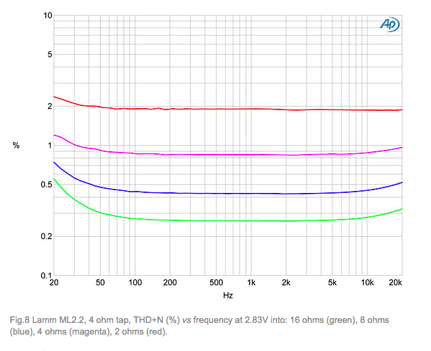

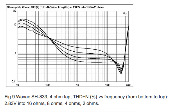

Thank you guys for the comments, but what I was asking is not the low order vs high order distortion.
My question is, why some SET amps have non flat "2nd harmonics" distortion vs freq response (intentionally or not). If high quality OPT is used, it would not be hard to make them flat, but even many of money-no-object type of SETs have high 2nd harmonics at lower frequency. So I wonder if higher 2nd harmonics at bass frequency has any "subjective" or "scientific" advantage, and what is the advantage, if it's so. Or if any disadvantage (trade-off) to make it flat?

The Jensen transformer I linked is an example of an extremely good OPT. Even then the distortion rises at the lowest frequencies. It's just the nature of OPT's and I doubt throwing $20,000 on an OPT would yield different results. Again, this is most likely not audible anyway, so who cares?
If you're adamant to get around the OPT, you gotta look to OTL tube amps or Mr. Pass' SIT amplifier. Pretty sure that both will suck up around 300W+ continuously. Better have good A/C

Thank you for your opinion, and I do not disagree with you. I just want to hear opinions from someone who find non flat response has certain advantage over flat one. If I go to an audio forum where people just talk about their sujective preference, I think I can find someone who prefer non flat amp over flat one without knowing what's going on, but I was wondering if someone very knowlegeable in this forum could explain more scientifically why this kind of non lineality is preffered by not a small number of audiophiles. We all know the reason why many people accept or prefer non linearlity such as second harmonics, but I had never heard the reason why low frequency 2nd harmonics is more acceptable or preferable than higher frequency 2nd harmonics.
You've already answered your question. Because it can be subjectively preferred.
FWIW, I have not read a good study on why that might be, but it is. I can also tell you that a strong dose of 3rd harmonic in the low end makes bass sound "fatter" and is generally liked. At what frequency that moves from fat to annoying I don't know. Somewhere around 200Hz would be my guess.
Basically, if you add low order harmonics to the bass, it tends to fatten up the sound and make it richer. That can be pleasant in the bass. For whatever reason, the ear finds audible distortion on low sounds pleasant, but not so much on higher sounds. Perhaps it's like any other sound. Play some pure sine tones and note their subjective effect. Which is more annoying, a 100 Hz tone or a 1000 Hz tone? Would added harmonics in those ranges be similar?

On the reproduction side of things, its more ideal to have a characteristic that complements the Flecture-Munson curve.
