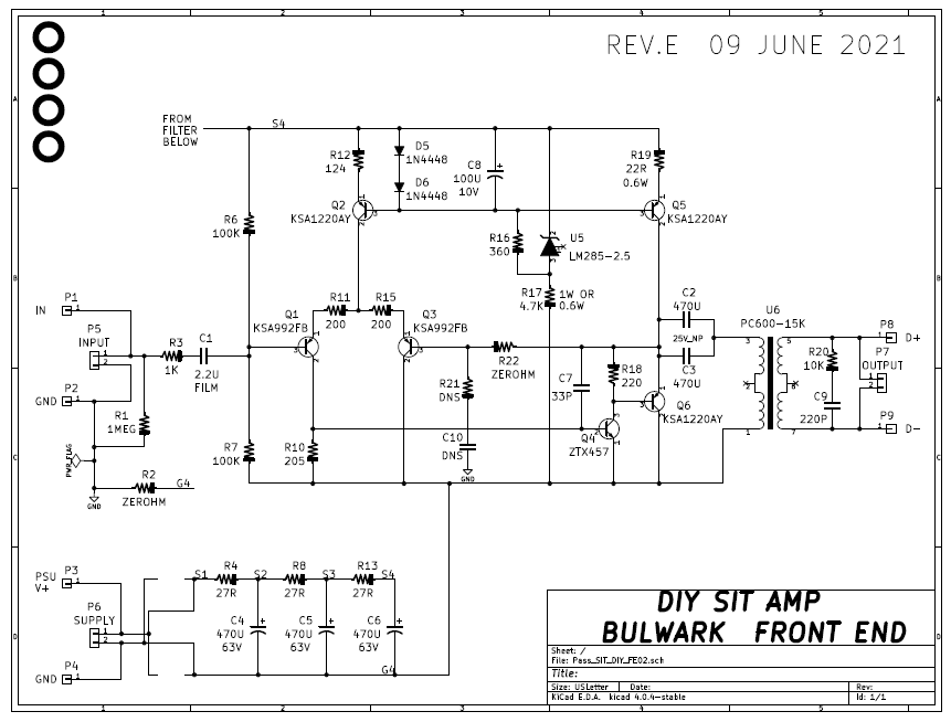

More than 100 diyAudio members absolutely LOVE the VFET power amp kit, designed by Nelson Pass and sold by diyAudio. It used the SMPS shown below. I write in the past tense because all amplifiers were pre-sold via a lottery and there are no more, there will be no more, all are gone forever.
Also attached is the schematic of one of the four alternate "front end" cards, to get a feel for their functionality.
