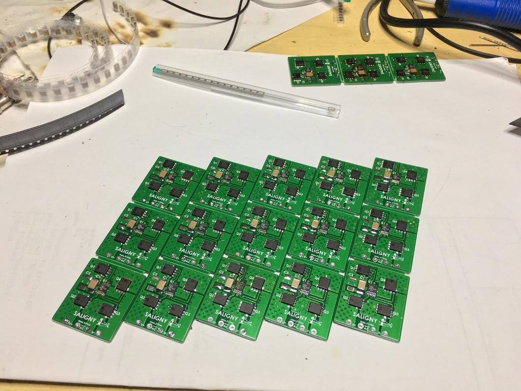

This is to let you know that I'm designing another two ideal bridges.
One will be dedicated to low voltage, small power applications, with very small footprint 6x6 mm and will handle around 8A continuous.
Second one will be able to handle voltages up to 200V and 35-40A continuous.
Synchronous rectification is the next step in audio (and not only audio), it brings sonic improvement in almost any appliance.

Hello Tibi,
Good plan!
But 200V is just about in between SS and tube. If you could bring that up to 400V or more you'd catch the tube crowd as well! Just 1A would be enough!
Jan
Hi Jan,
For tube fans I'll have discrete ideal diodes that will handle up to 450V at 6A.
Hope the end of soft tube rectification is near. 😀
Tibi
Tibi
Great! You have a link to those?
But remember: there will always be people that think that soft, crappy rectification sounds better ;-)
Jan
Jan
Discrete diodes are already under test and I'll post some pictures soon. Other two designs are more challenging.
Tibi
Tibi
Litlle bit higher voltage is very welcome. I was concerned that current production Saligny can't reach my desired 80vdc. for field coil power supply drivers.
Thank you JD for delivery confirmation and GB subscription !
Joimonf, next ideal bridge will handle 200V @ even higher currents, while been very compact.
Destroyer OS, light green mean that goods are packed but not yet shipped.
Expect to have many of them shipped today.
Tibi
Tibi
Sounds interesting!
