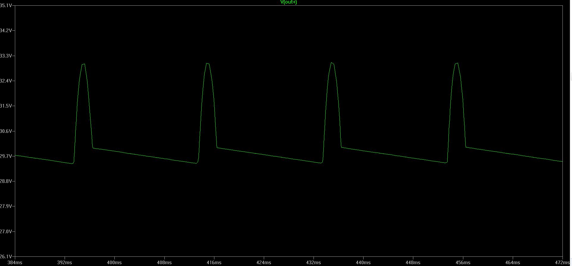

Please note that Saligny will work with center taped transformers (and center taped used as main reference ground) only when both sections are in phase. This was discussed here.
Thanks to a very observant friend who noticed the frequency of ripple, the mystery shrouding the weird synphase connection has finally been revealed 🙂
It is perhaps worth warning any adventurous synphasers that in this mode the 4320 works as a parallel half wave rectifier with the obvious increase in ripple. It may be appropriate for this info to also find a spot within the first post of this thread.
The 50Hz ripple can be seen in both simulation and measurements.
In the standard unipolar connection the 4320 applies out of phase control signals to the opposing fets in the bridge, emulating the behaviour of a standard diode bridge. In the synphase connection this changes and the opposing fets get synphase signals at their gates, effectively working in parallel.
Below is the 50Hz ripple waveform from the synphase simulation. In the standard connection this is of course 100Hz.
On the plus side this is an elegant way to achieve half wave rectification without passing dc through the transformer secondary.
