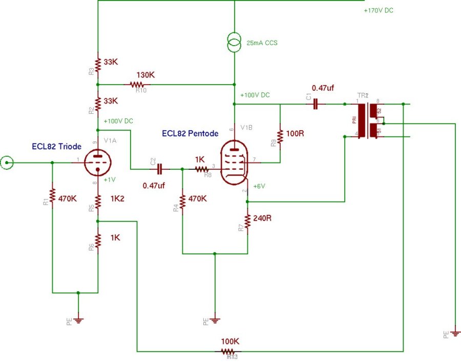

This is my design for the interstage transformer design using the ECL82. Any comments are welcome.
I had some ideas about how to overcome the limitations of the torodial interstage transformer approach. The first and obvious solution is to lower the output impedence of the driver triode. This will allow it to better drive the interwinding capacitance. Choosing a triode with high enough gain and low enough output impedence would be a problem. Alternatively simply push 40mA through the driver, but again achieveing this with only 170V of supply would be tricky.
Another solution which adds another dual triode would be to use a transformer with a step down ratio, this will have two benefits. It is likely to have lower interwinding capacitance. Secondly the step down ratio will increase the effective impedence of the load presented to the driver, by that ratio. The disadvantage is that we then need to add another pair of triodes after the transformer in order to regain the voltage we lost in the transformer. If we use a dual triode for this - mismatch shouldn't be a real issue. This could potentially introduce more distortion as we have introduced another gain stage. This however is probably the best solution overall as it stops the interstage transformer becoming the limiting factor.
The third solutions is what I am attempting, which is to lower the effective impedence of the driver so making it more able to drive the interwinding capacitance. There is plate to plate feedback which should level out the frequency response (the loading down at high frequency is present at the plate of the driver and doesn't appear within the transformer). it will also make the whole stage behave more like a cathode follower- ie lower output impedence. This is local feedback so should be stable. There is also global negative feedback which should help to reduce any distortion introduced within the transformer, and also reduce the output impedance. If the gNF proves unstable it will be removed - but the plate to plate is the important form of feedback. Because the CCS consumes 70V it should allow a voltage swing of 60V.
If this proves inadequate I will attempt a step up arrangement. If I can get the response flat to 10Khz I will be reasonably happy.
Another reason that I like my solution is that it maintains the two tube per channel idea.

Hi there,
I lashed up the ECL82 driver today.I made one or two simple changes. The split cathode on the triode is now made up of 630R on the top and 470R on the bottom. The anode load is 22K at the top and 33K at the bottom. Works really well. For a 2.5Vpp input I am getting about 8Watts of output. The pentode is producing about 110Vpp output which is about its theoretical limit with 65 volts over the CCS( (65-10)*2=110). At this point the input stage clips. It would therefore be pointless to try to get more output from the input triode as it would drive the pentode into clipping.
The frequency response has gone up from -3db at 4khz to -3db at 8khz, and response is sustained well beyond that point. The 70hz response peak is still there, but maybe slightly reduced. The plate to plate feedback is working and stable, the cathode feedback is working and stable. Sine wave response is good until about 8khz when it starts to look a bit odd. Square wave response seems to be a little more spiked.
There is one strange aspect in that the 6080's are giving about 2/3 of their grid input voltage as output. For some reason they are not even achieving unity gain. The cathodes are unbypassed. Would bypassing the cathodes solve this or is there another reason for the loading down. If I bypass - what value should I use?

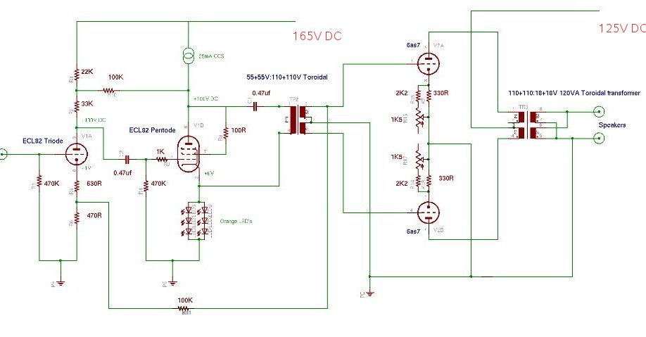

On the basis of that here is the final circuit, minus Yves mod, which I will try on the hoof.
If anyone has any useful suggestions on how to improve this design I am all ears.

I just wanted to correct some statements I have made.
The drive to the 6080's is 60Vpp which gives a final output of 5.5Vpp. This should give about 7.5Watts of clean output in 4ohm load.
The measurements I stated before were down to problems with interpreting my scope. I apologies for any misunderstanding.
Shoog
Did you mean 5.5vpk or 5.5Vpk-pk, there's a world of difference between the two.. 😀 By my calculations 5.5Vpk into 4 ohms is about 3.75Wrms..
I recommend either adding cathode bypass capacitors or alternatively a bipolar/non-polar cap between the cathodes of the 6080. Right now your unbypassed cathodes are reducing gain to less than 1 and also increasing rp to something like 1.3K if I haven't goofed the calculation.
You'll get at least twice the power, better bass extension due to the lower effective rp, and less distortion for the same reason at low frequencies.
I suggest trying a cap across the 6080 cathodes because in theory this will make the output pair a cheesy LTP and should result in some additional cancelation of even harmonics, and the net dc voltage difference will be small as will be the ac voltage across the cap as long as Xc is relatively small compared to the resistance present at the cathodes. I would think a 63V-75V cap would be adequate here which is good because it will need to be big to be effective - several hundred uF minimum. Something to try anyway, you may or may not like the results.. Bass performance would probably be better with straight cathode bypass caps.
Thanks for that analysis. I was think that I was going to add cathode bypasses. I did a little experiment by adding 1000uf caps. The gain went up to just less than unity and the sound seemed to open up somewhat. Because of the high dissapation through the 330R cathode resistor I had to use wire wound, which seems to effect the high frequency response. I will bypass with 1000uf 63V electros paralleled with 10uf 63V polys.
