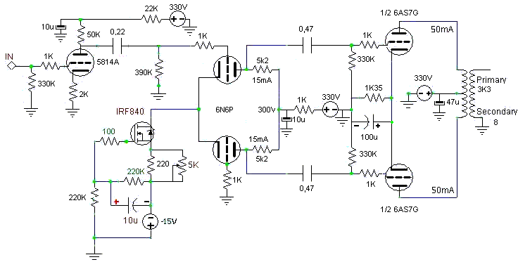

Just an idiot idea not yet checked :
Almost no DC in the OPT so toroîds should be usable.

I was toying with the idea of using toroidals as outputs, but was a little concerned about DC with such variable tubes. Seperate cathode resistors would seem a must.
I saw listed on a datasheet a completely different operating point for these tubes. 135V anode, 250R cathode resistor, giving a current of 125mA. This means that the grid is at -35V which presumably would lessen the variability of bias. Since my speakers are 4ohm, I would need a 800ohm load which would mean about an 18V:240V which coincidentally is exactly the toroidals I have. The driver design would presumably be much more straighforward at these voltages, how about an improved futterman style driver with the cathode returned to the output.

Hey Shoog,
I'm not so far from that you suggest.
It's designed so that each half 6AS7 draw 100mA and has 115V Vak, bias being 40V.
This already set the plate dissipation at near 12W.

It looks interesting and sort of the same, but isn't it running as something like a SEPP. Are the phase splitter and first stage two halves of ECC83, as this maintains the 2 tube philosophy.
I like the idea of running mine at just 135V because I have a big toroidal power transformer which would probably do power supply duty. Mine would be running at just over 0.5A in total.
When the output tubes grid is at -35V, whats the drive voltage which the phase splitter need to supply (70V PP maybe) ? This would mean that the phase splitter would need at least double that across it, so at least 140V.

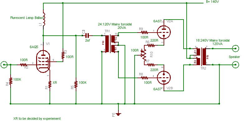

How about using a mini power pentode to do current amplification, putting it through a toroidal interstage transformer with a 1:10 Voltage ratio. This would do the voltage amplification and phase splitting and would drive 6as7 directly. Simple and elegant.The only issue that would arise would be stability issues if global feedback was needed.

I wouldn't use a 1:10 step up unless the rp of the driving tube was extremely low as this equates to a 25 fold increase in source impedance to each of the driven grids.. (say 3K rp to 75K effectively at each grid) Mr. Miller would come to town and you would be lucky to have any response above 10kHz.
The designs I have seen all use the toroid as a conventional pp output transformer. Bear in mind the low voltage configuration is going to give you somewhat fewer watts as well. Some means of adjusting dc balance may be advisable.

Good point on the impedence step up. I was thinking that by running a driver tube at 40mA, after stepping up I would still be left with about 7mA to drive the grids of the 6AS7. This would allow me to use the same +B and a low gain driver tube. I would have to go down a different rough and use a a higher voltage input to the transformer and step down the voltage to the grids instead of stepping it up. This would require a voltage doubler at least to get the required voltage to the driver.
I have used toroidals as outputs and they work well. I don't see why they wouldn't work as interstages. The difference between them and a proper (expensive) interstage transformer is that they wouldn't accept DC and so need a RC stage. Other than that there hi bandwidth should make them ideal. I can't imagine that they would produce a worse result than any of the more conventional tube based phase splitters, and there slight imbalances. The only way to find out is to try them.
The output tubes have a 100R pot to balance them.

Had another idea. What about making the driver a cathode follower. Give responsability for voltage gain entirely to the interstage transformer. This reduces the output impedance to acceptable levels. I could use another 6080 to do the driver duty, which would be nice because then we are down to a 3 valve amp. Linearity would be less of an issue when run as a cathode follower. However 2.5A heater current is a hard one to swallow for just a driver.
How about a triode strapped EL86, which has a low Ra and is happy to run at relatively low voltages.
