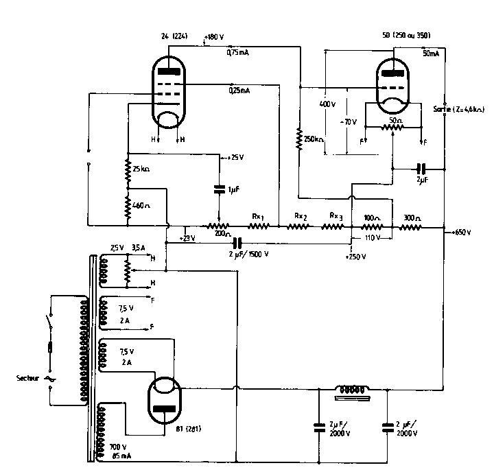

BTW, attached for amusement the design of the original Loftin/White Type 50 Amplifer.
That one gets around the Gridresistance limit by using what in effect amounts to a DC servo loop. Not bad for around 1927.
Power Transformer supplies 820V AC BTW..... The type 81 halve wave rectifier is not recommended in modern circuits, we can do better now. If you build a hybrid bridge a type 80 Rectifier could just about supply a stereo Amp.

Arnold,
Have a look at the Loftin White, attached ( easier to read, your is huge, Thornsten).
Now, Thornsten, one could say that they are parents, but I am convinced that mine is much simpler ( I am talking about the adjustments you must make, I guess, quite often, with the L&W, considering the interconnections between all gradients).
You must have noticed that all the resistors are in series, from the B+ of 650 volts to ground and they have to supply the right amount of current to the driver stages, which in this specific case, does not draw much. What if you needed to ?
Also, may I suggest you read again the summary of the performances that the DCMB has, that I sent some time ago.
I don't think you can do the same with the Loftin White ( invented in 1928 ).
You seem to focus on aspects that are liable to be criticised.
This might be constructive, but please, make an effort to see the good sides, also.
Regarding the coupling capacitor that you barter with the electrolytics, please observe that the DCMB attacks straighforwardly grid and cathode of the output tube, transferring every detail the driver load resistor has collected. This is what I claim to be an ultimate transfer connection and it is not the case with a coupling capacitor, right ?
Unfortunately, electrolytics are commonly used around the circuits. If you don't like them and you are wealthy, all you have to do is to replace (all of them) with paper/oil ones or even better quality.
Anyway, to be honest, I don't dislike your objections. You can always learn something, anytime.

Konnichiwa,
Actually the LW circuit with the Pentode driver uses the screen grid to introduce a DC servo loop which auto-adjusts the output Valve Bias and is quite resilient to valve parameter variations.
Correct. They do, BTW. Allways.
You re-arrange. the same principle scales to any sensible driver stage current levels. There are also variations with a similar stabilising DC loop for triode drivers, but there the DC control loop has much less gain and is less efficient. Well, Pentodes sound a lot better than triodes when driving triodes (the reverse is true the other way around) so nothing to worry.
ANYWAY, even with all these caveats, a LW using a single supply actually has a very stable operating point under all condtions, if the input valve sets the bias correctly (adjustment to suit different driver valves may be needed), simply because it has a ton of DC local feedback in the output stage.
Bottom line, classic LW needs normally no adjustment even with output stage valve change (input usually requires adjustment).
You only start to get into trouble once you use a split supply LW circuit (such as the one I showed in another thread), then the output valve has no DC dengeration adn a DC servo loop becomes neccesary.
The specific DCMB Circuit(s) from Audio Express and Valve have some additional features you omitted in your drawing, mainly the presence of a feedback loop acound the output valve.
Surprisingly (perhaps), you can.
My problem is that I do NOT see any good sides. Non at all, honest. Once you draw out the current loops all aparent good sides readily disappear and we are left with drawbacks only. You cannot even claim lower cost as a good powersupply for the driver and seperate supplies for the Output stages eat up the money "saved" by not using expensive gridchokes and coupling capacitors.
The LW with split supplies (aka DCMB) is one of the many possible ways to arrange circuits, I find that it merely trades one compromise for another.
You always need to account for the current return. It must return somewhere. In your case it has nowhere to go but the powersupply. Please draw out all the relevant current loops and you realise that instead of coupling between driver anode and output grid with a capacitor you now couple between driver cathode and output cathode through the powersupply.
You have not eliminated the capacitor (you cannot anyway), you have merely moved it around.
Yet it is not the ultimate transfer as the loop is closed through the supply.

Alex Kitic said:Here's an output stage...
Unfortunately that circuit would be dangerous to the 50s since it uses a 200K gridleak. The 50 is only spec'd for 10K between grid and filament (it's an old type valve... might have a soft-ish vacuum or something)
