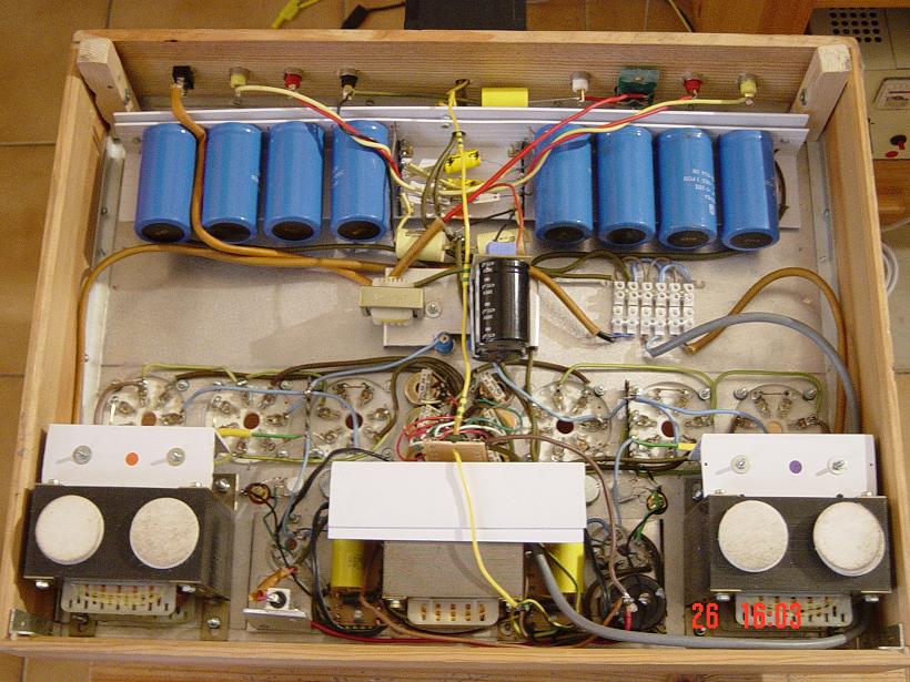

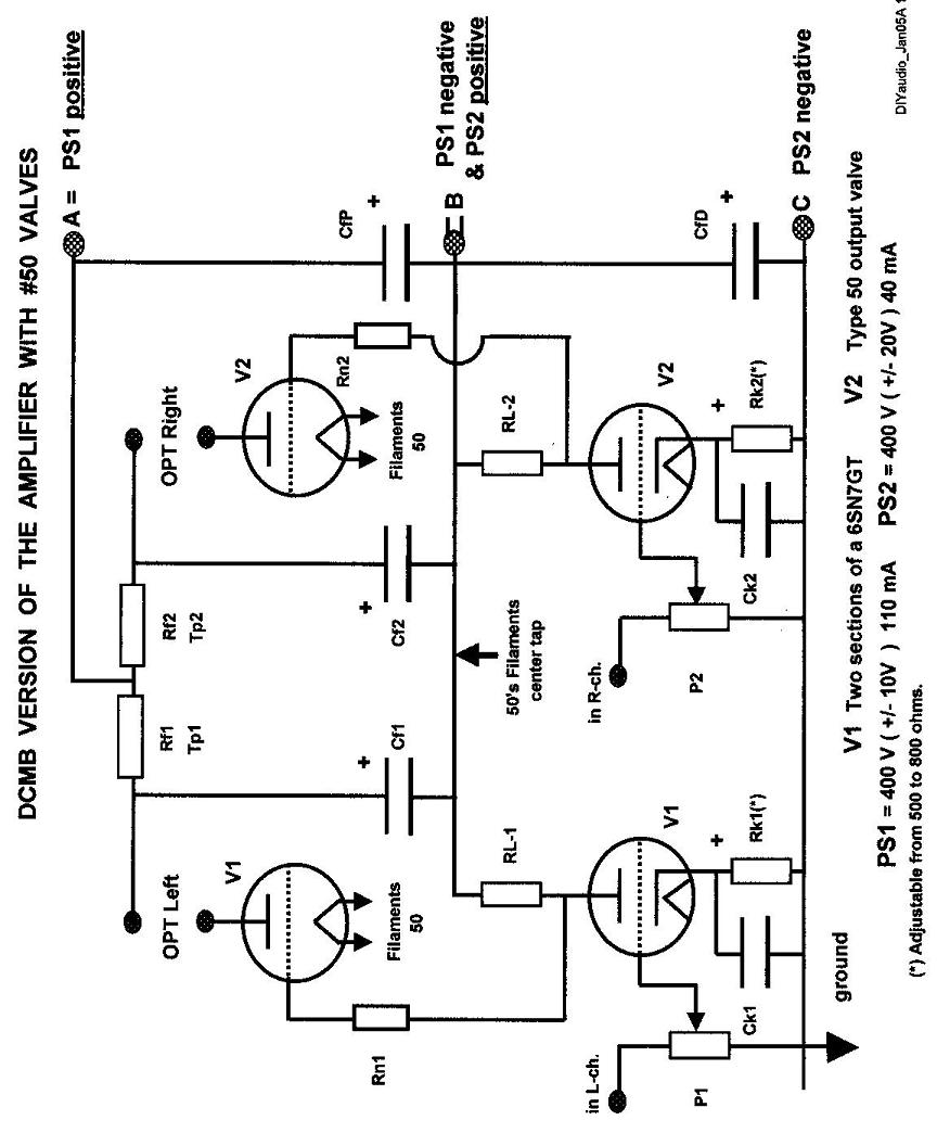

Here is an amplifier I built ( three units ) using three paralleled 6C33 and delivering 50 watts per channel, in Single ended topology.
I attach the upper view and will follow with the view inside.
The power supply is in a separate box and connected with a simple twin wire cable.
The filament and driver transformers are on the main unit (the one shown). THD at full output is 6.5 % - Range 35Hz to 35 kHz
at -3dB .
You can find schematics and full description on AudioXpress magazine, July 2004.
Uses quite expensive OPTs .

Hello Dean,
Very kind of you, I am very pleased, needless to say.
Your suggestion looks, at first sight, like an improvement.
In fact the swing required does not change, if the multipurpose load resistor of the driver valve is connected between cathode and grid of the corresponding output tube.
However, please check if that means ( I suspect ) to use monoblocks or separate drivers for each channel, instead of a common power supply for same.

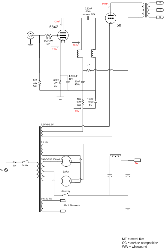

Nice amp ari
Here's what i have come up with based on my readings from Thorsten's post.
Due to power transformer limitation (will be using an existing Lundahl), I will be operating the 50 at 350V/-50/50mA/1K which I think will have enough juice to drive my Altec speakers.
Here's my mock schematics - not yet complete by any means, and I'd appreciate your input.
What are the candidates for the Plate and Grid chokes? What should be their specs? Would like to try some Hammond iron for these.
I also plan to use a VR tube 0C3 to provide ~190V for the 5842(417A) but since two 0C3 will yield 210V, can I use a dropping resistor to bring it down to 190V?
Thanks for any input.

Konnichiwa,
Anode load Chokes:
S&B Anode Load Choke (120H/12mA 40% Nickel Core)
Tango TC160-15W (160H/15mA)
Magnequest EXO01 (100H/20mA)
Tribute (Custom made - if you are patient - Amorphous Core)
Grid Chokes:
S&B Grid Choke (4KH+/0mA 80% Nickel Core)
Magnequest BCP-16NI (1KH++/0mA ??% Nickel Core)
Magnequest BCP-16M6 (1kH+/0mA M6 Steel Core)
You could also employ a 1:1 interstage transformer, to mind come:
Tango NC-20
Tango NC-16 (connected 1:1)
Tango NC-14
Tamura B-6003 (connected 1:1 - Amorphous Core)
Tamura B-5003 (connected 1:1 - Amorphous Core)
Audio Note Trans-016
James should have some nice IT's
Lundahl LL1635/20
Sowter 8424
Sowter 9525 (maybe, Bifilar winding often gives bad sound)
The S&B Anode Load Chokes I had designed for myself where specified as 120H/12mA/1k2Ohm with a 50% Mu Metal Core (as a result total 40% Nickel). They turned out to have a little more inductance than that, they where meant as funtional equivalent to the Tango TC160-15W.
Given that you will have around 400V HT Available you could of course also use a 100nH (or therabouts) Choke with 15K DCR, in other words a nice 15K Resistor, in the 417A Anode, especially as you only need to drive 50V Peak. A 15K load for a 417A to drive 50V peak is pretty decent.....
In that case a 3K3 +B decoupling resistorwill be needed to get the 185V.
The S&B Gridchokes probably have a well, well oversized core for their own good and measure at ludicrous inductances (4.8KH @ 20Hz with a few volt excitation) and have 1K DCR, but a few more KOhm will not be of concern. Any of the above gridchokes will be fine, but with an original #50 in the output IT or GC grid returns are sadly mandatory.
I don't think Hammond has much suitable stuff.
A trick you can apply, find an Interstage transformer that has enough inductance (i'd say 50H minimum) and the current handling, no need to worry overly over HF response. Then bridge primary & secondary with a suitable capacitor like here:
Bob D used the Allied Electronics #227-0862 IIRC.
http://www.alliedelec.com/catalog/pf.asp?FN=681.pdf
I'm not sure if I would use that Transformer though. There might have been a technical report in one of the Valve backissues, I'll have a look. Then again, quite a few Joe-list members have been swearing by them....
Found the Valve back issue on the first try (dem old grey cells seem still to work, clearly not enough drink), they note the Allied IT as having 35H @ 12mA/60Hz, quite possibly tolerable, if not great. The poor HF response if dealt with with bridging cap (mixed coupling), leave chassis space for a Tango NC-20 if you like the results... ;-)

Dear Arnold,
Your schematics looks OK.
Please rectify the stated drop at the 1k2 bias resistor. In fact
if the plate current is 0,050 Amps, you have V = I x R =
0,05 x 1200 = 60 Volts ( and not 50 , as I read on your schematics).
The dropping resistor for ( before ) the two 0C3 in series should be 1667 ohms ( 1k5 - 5 W would do ).
Thornsten answered on the plate and grid chokes. You have a lot of choices.
According to the SE Amp CAD simulation, with the ONE Electron UBT2 transformer, you would get 4,65 Watts , with a B+ of 450 V
( can you make it with your power tranny ? ) , with a 2nd Harmonic distortion of 3,7 % and a third H. Dist. of 0,1 % .
Damping factor 2,8 . You need a swing of 60 V PEAK ( circa 43 Vrms). Plate current would be 49,5 mA.
If you can't reach this B+ voltage, try with 390 V, and you can get the same results, but you should use a fixed bias supply of - 60 V,
positive to ground and negative connected to the low end of the grid choke ( previously disconnected from ground ).
However, the style 50 tube manufacturers advise to use self-bias.
Should you wish to switch to a DCMB circuit (Sorry, but I have to promote my own circuits), let me know and I will convert yours into one. You will need to use a 6SN7GT instead of the 5842, but you will save the plate and grid chokes and you won't need an interstage tranny.
Bye
Ari.

... you will save the plate and grid chokes and you won't need an interstage tranny.

Yes, Ari, if I'm not cryptic, I'm using slang! I meant to suggest that your circuit solves certain problems in an elegant way that, to a person shopping around for an interesting circuit, represents an excellent find. Just my opinion.
Thorsten, thanks as always. I will see if I can get hold of those transformers that you recommended. The simplest for me is to use the Lundalh IT which I can get from Singapore.
Ari, how can I refuse? I also would like to learn, so please feel free to convert it to a DCMB circuit with explanations if you don't mind? Thanks!
I am a just a builder
ps. the 1k2 should have been 1K
