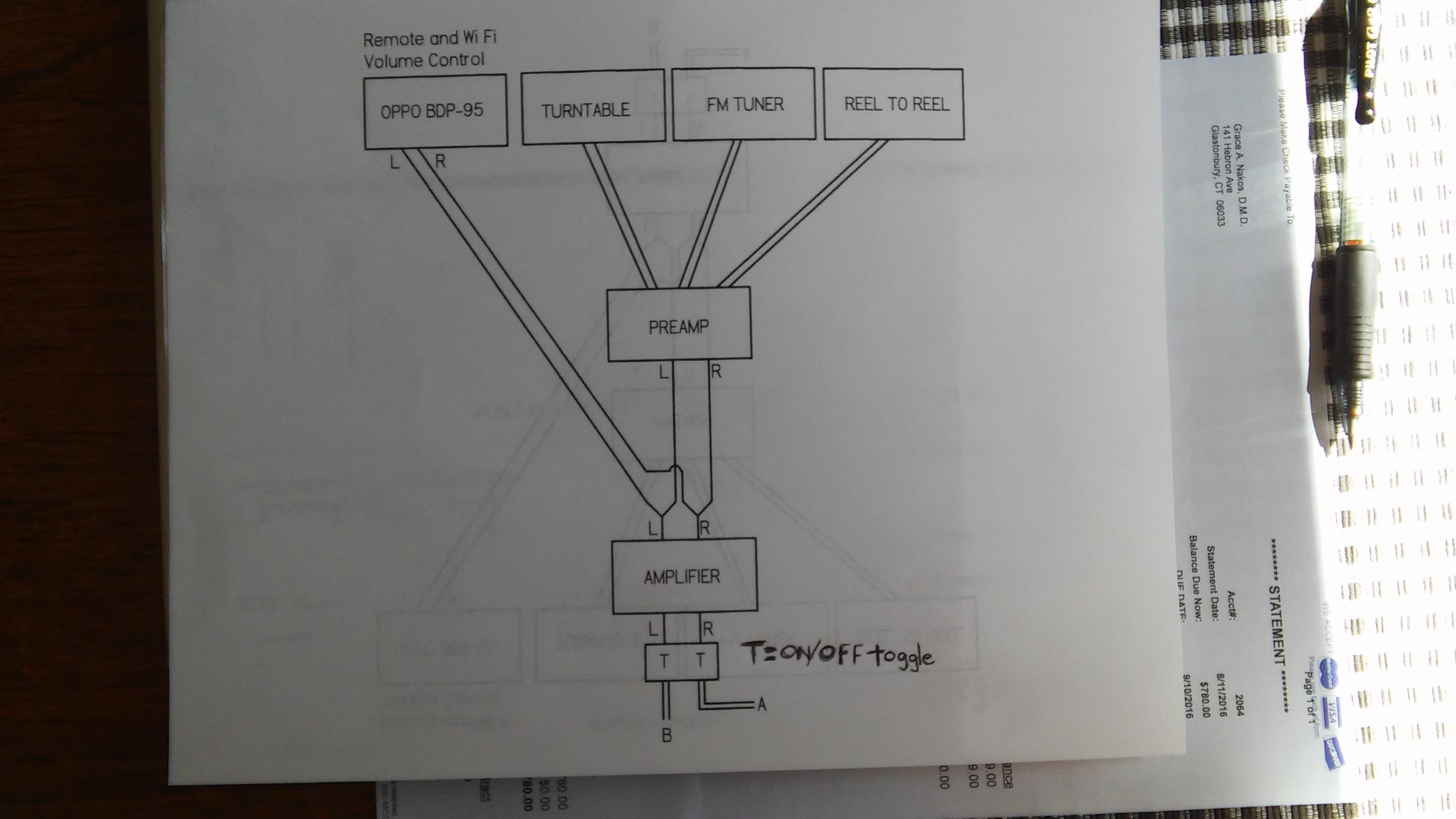

system connection question
I want to connect my OPPO BDP-95 directly to my amp and want to connect the other sources to an Audible Illusions M3A which would be connected to the same amp. I am thinking a Y connector connected to the amp inputs might work. Please see my attached sketch and let me know if it will work?

I plan to have only the component in use turned on. For example, when using the Audible Illusions preamp, the OPPO wil be turned off. Same thing when playing the OPPO, the other source components and audible Illusions preamp will be turned of. Will the problems you described still happen?

It may, but it will not work well. Each component's output is a low impedance and will load down the other. You'll have low volume and increased distortion.

The load given by a "turned off" piece of audio equipment is probably more indeterminate than if it's turned on.

Thanks for helping me understand how to use this site. I also don't need a new thread because, based on responses here and elsewhere, I'm not going to use Y connectors.
I didn't know that other components, even when off, could effect sonics from a turned on component, when both share the same amp inputs.
As a general rule, paralleling outputs can at best result in severe attenuation of the signal when both outputs are active (although not passing signal). Non-active outputs are quite likely to distort the signal, although in some cases they may simply do nothing at all.
