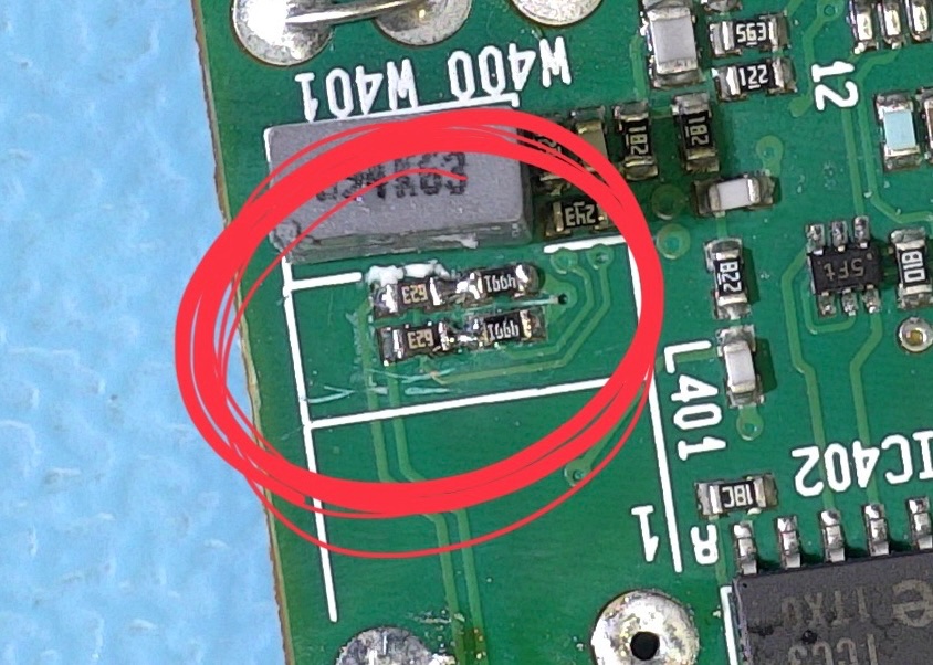

I will try that, thank you!First, you have to carefully tear off the white glue piece by piece, then desolder the coil.

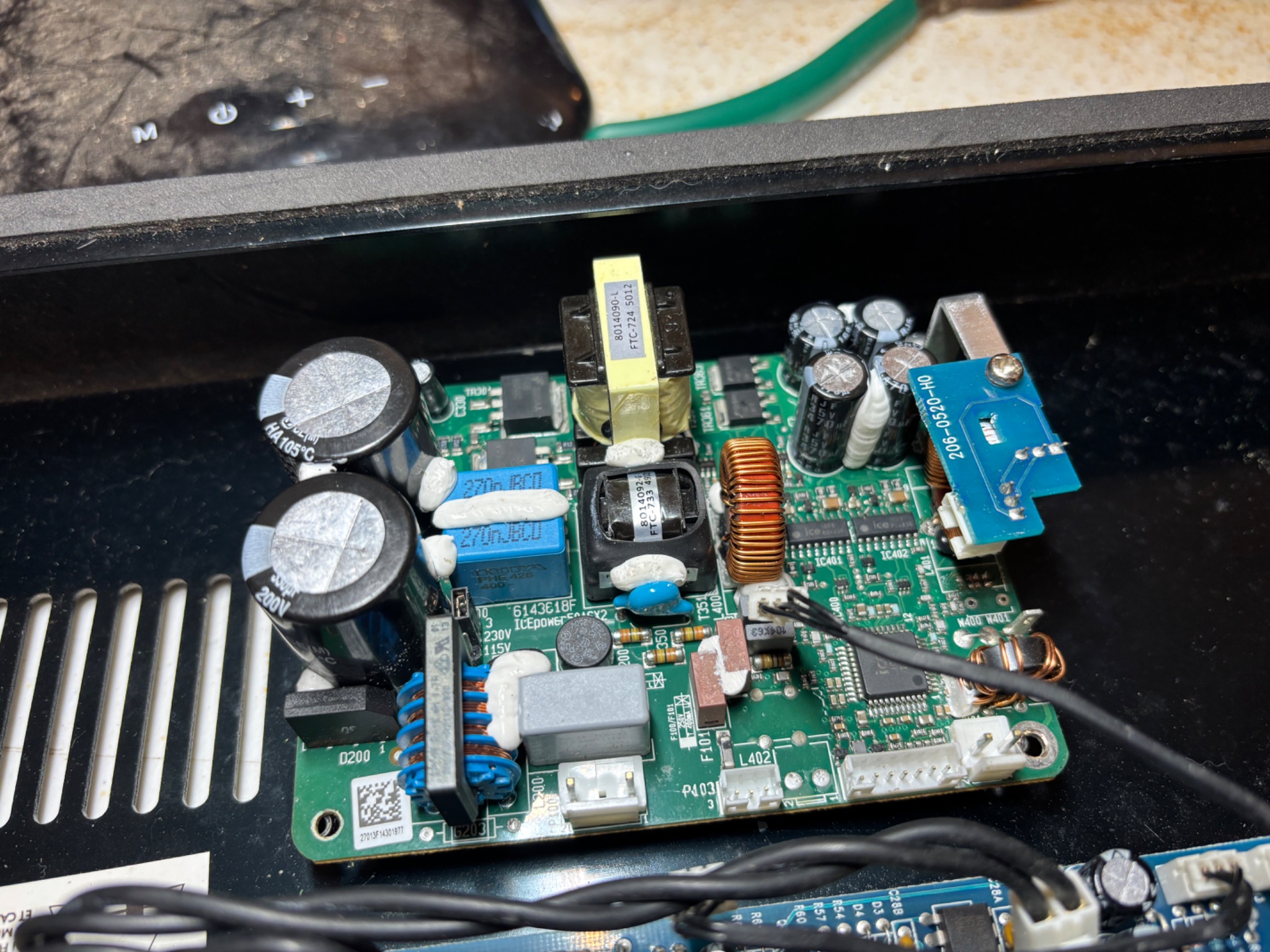

Hello Frobek,.... good job with IcePower 50asx2 amplifier solution !!! ....I have a doubt and I need your help, now I have another brick on the bench......haha......my Icepower 50asx2 have the same symtom, I have already removed the silicon and I have discovered the resistors two of 62K (one it's ok other is broken) but the others that you say as resistors it don't have code and color is blue, one of these measures 5K and other is open..... but seems to be both is a capacitors ....really are resistors smd 5K ???......Thanks in advance.
Look at my photo, these are resistors :

Hello Frobek, I have recently received my new resistors 0603 62K/5K pack and I have done the replacement broken resistors, now ICE Power Amp works fine again !!..Thanks for share the solution !!!, my amp is on de road again !!!Look at my photo, these are resistors :

I see that you have solved the issue with the 50ASX2 amp, But I have the 1200as2 and having the same issue. I tried plugging it into my Variac and set the voltage around 92V, and it works great. But when the voltage is higher, it continues to switch ON-Standby modes. Any recommendations would be greatly appreciated! Thanks
