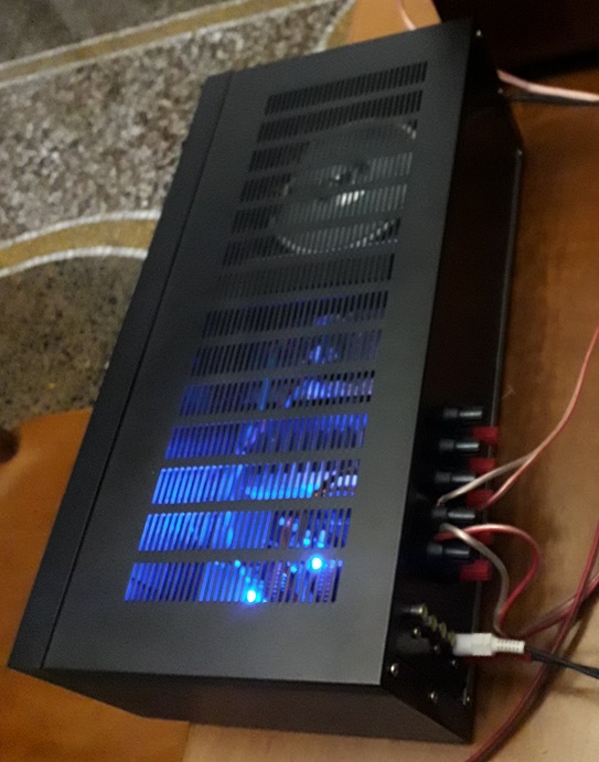

Another way
The theoretical and preparation phase is gratifying. I try to prolong it, by collecting discarded electronic stuff for a couple of months.
Old cases have thick and non-optimized sheets.
If I buy cheap accessories, they simply don't work. If I buy quality parts, I spend on them as much as an industrial device. Instead, I can get functional parts from garbage.
Wrong purchases of the past can be rethought.
Sustainable.
