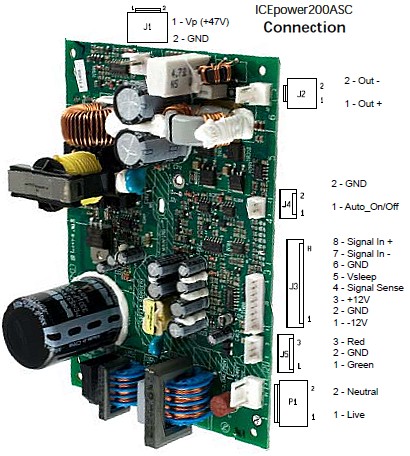

Mauricio,
Just a friendly advice: do not mess with the offset voltages and timing settings. 😀
The attached information should help you with the "not-so-obvious" connections.
Cheers!

thank you all for help, and in the case of not having any welding would also nornal ......
and I have 4 modules, and this one with its definition pretty bad and I thought it would be the lack of a good fit to off set being almost 0.5 volts on its output ...... the others are with 0.22 volts
thank you
mauricio
