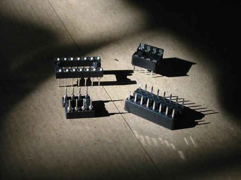

So, I might use a couple of gold plated (for corrosion resistance), turned pin sockets until I have made a final decision on the opamps.
What do you think of buiding a new, small board for the opamps, with point to point wiring and a good connection to the main groundplane?
The surrounding circuit could be constructed more concisely on the new board.
Two sockets on the left are machined. The ones on the right are flat sheet type.

For testimg over a limitedtime, corrosion should be no problem, unless you surround yourself with all kinds of strange acidious fumes........
The sockets at left above are quite OK, but by all means,- if it makes you feel better, use the gold plated ones.
It is quite strange though, this negative vibes for sockets...
I do agree they should be avoided in the long run, but for short time testing.- no problem. As I said, it is contact problems, mainly associated with cheap sockets, that gave these little gizmos their bad reputation, and not without reason. OTOH, we do use connectors, relays, wires etc. to hook up pre to power, transistors heatsink/boards etc. All these introduces C's and H's as we go along. After all, your signal chain starts with your source and ends at the loudspeakers. We all agree that the shortest route possible is the ideal way to go, to minimize line lengt etc.etc. but logic and reason is allowed, - and so is common sense.
Thanks again for the advice
Didn't select "gold plated" out of choice - but it is the only type of machined ones available in the local electronics store - apart from the real cheap "swipe" ones which nobody seems to like. Besides, the better quality ones are also inexpensive - only AUD$1 each!
