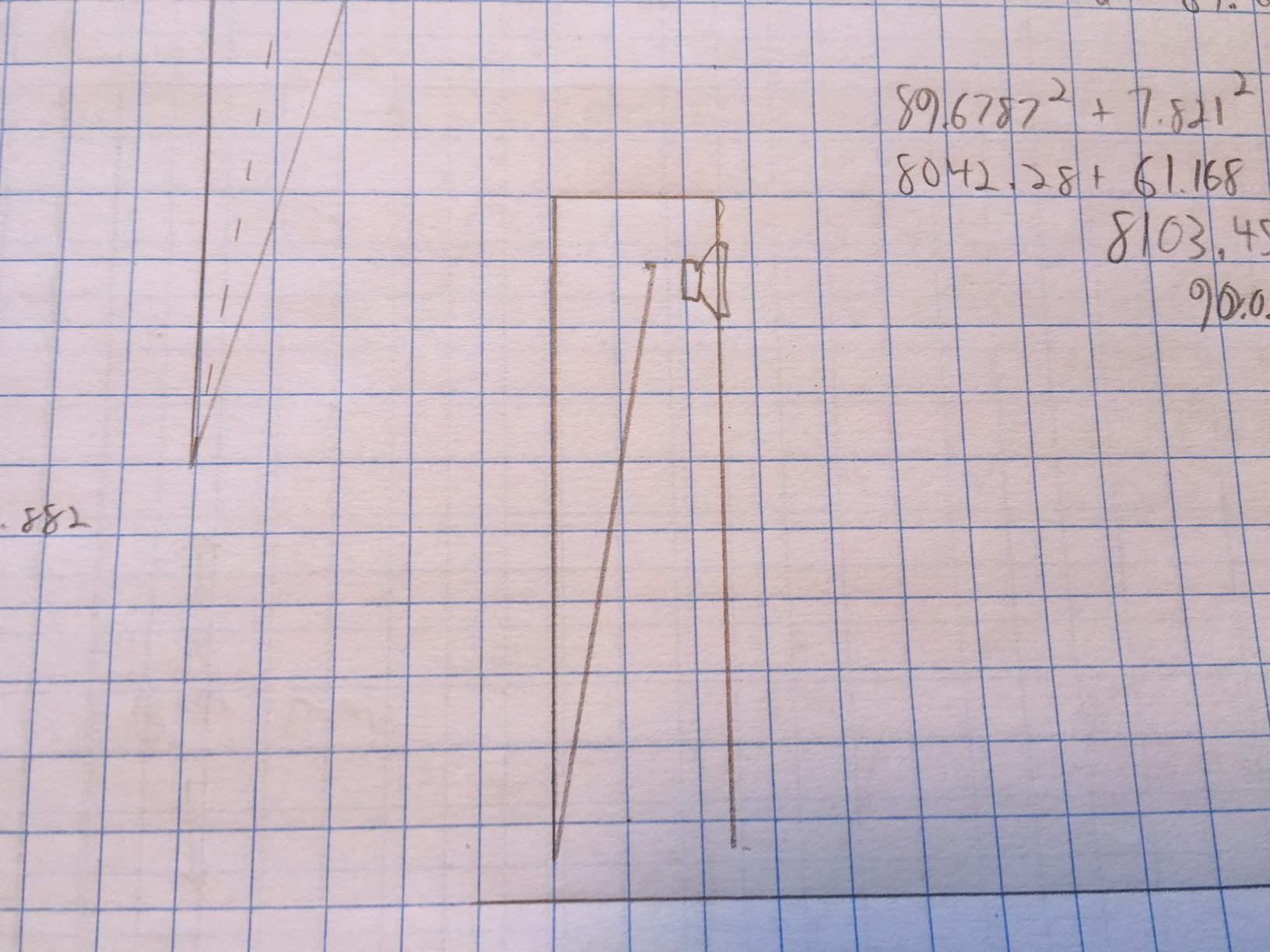

OK, so I calculated what would be the driver height using L*0.56 and realized that the driver will be placed at a little more than halfway along the line from the closed end.
In a folded iBIB, that means you'd have to place the driver on the opposite side of the cabinet as is customary, i.e. on the same side of the fold as the mouth (as in attached pic). Is that correct? And would it still hold true for iBIBk?

Hi there j: If I recall, the driver position for a BIB used in GM's posted calculation is
Z=(about) 22% down from the pointed end, clearly on the front side... terminus being on the back side for upward exit. Given my advanced age, I may have recalled this incorrectly, however, I, will check on my other computer for the GM calculation equations. ...regards, Michael
Given my advanced age, I may have recalled this incorrectly......
I resemble that remark! :( Close enough, 21.7%.
BIB math example:
Fs = 70 Hz
Vas = 0.29 ft^3
Qts = 0.445
Vb = 20*Vas*Qts^1.25
L = 13464.54/2/70 = 96.175"
folded height = 96.175"/2 = 48.088"
Vb = 20*0.29*0.445^1.25 = 2.10804 ft^3
Sm = 2.10804*1728/48.088 = 75.751"^2
depth = SQRT((75.751*SQRT(2)) = 10.35"
width = 75.751/10.35 = 7.319"
zdriver = 96.175*0.217 = 20.87"
a-b-c = 10.35/2 = 5.175"
