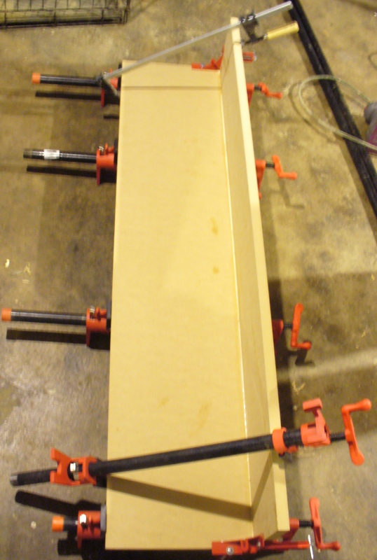

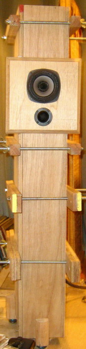

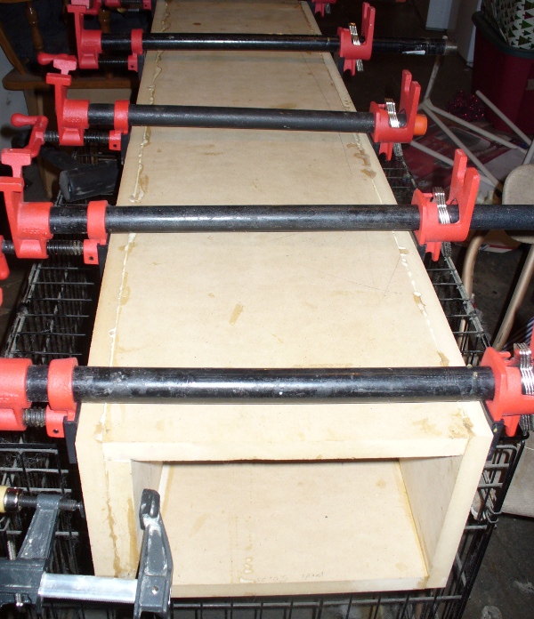

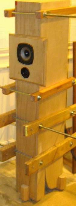

Been testing in mono using makeshift clamps.. So far I like it a lot. I'm using different drivers (widerange) that have very similar T/S as the FE127E with a slightly higher Fs of 75Hz. Scottmoose assured me it's theoritcally an okay 'drop in'.. It is.
No need for BSC to my ears. Bass is impressive even with not much density in lining/stuffing. Needs more listening test. I'm using twisted cat5 wiring for each terminal for now, it's ok but transients seem a bit blunted, will try other wiring soon...Sorry I don't have any equipment yet to do any measurements.

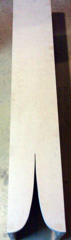

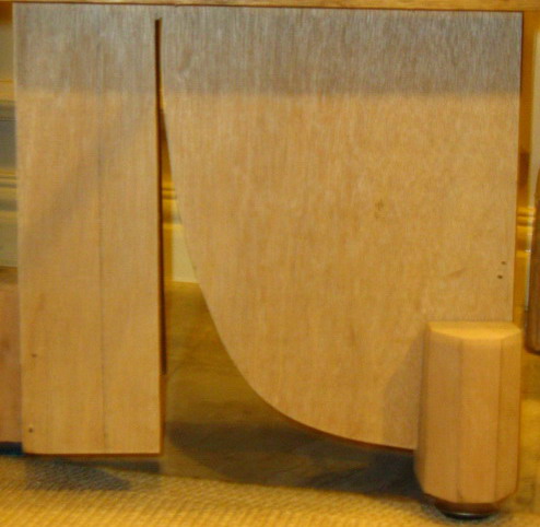

.. half of K-slot on one side. the curve doesn't look as smooth in the pic than it actually is. sorry all of it was hurriedly shot. To size the slot a friend did the calcs in Tractrix spreadhsheet for me that can be downloaded from the Karlson site. The are ~27"^2 area was used as suggested in planet10's published plans.

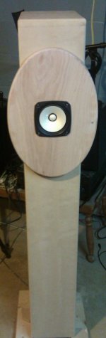

Just finished preparing my suprabaffle for staining.
Before I had the suprabaffle finished, I temporarily installed the speakers into the cabinets without the suprabaffle. Just a basic 4" hole in the front of the cabinets, with correct height on center according to the plans.
Before I glue the suprabaffles on, I'm wondering if I should enlarge the driver hole from where I installed the Fostex drivers before, effectively removing area behind the suprabaffle piece. From Dave's iBiBk Google Sketchup rendering, it looks like there's a larger square cut, but someone suggested I could leave the driver hole the same size as-is. Though, maybe there's a bit of "interaction" from the back of the driver from the thickness of the wood behind the suprabaffle? Maybe not, but thought I'd ask before I glue!

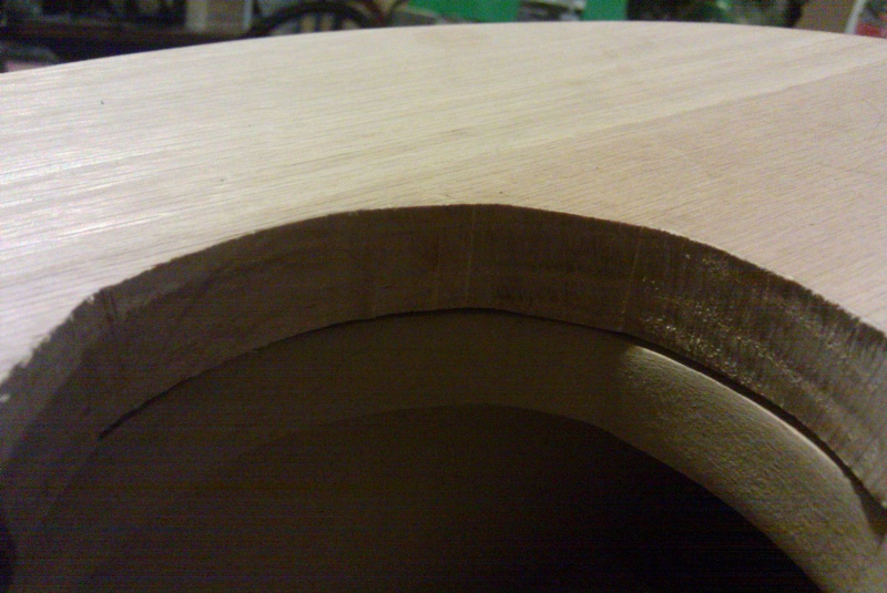

Thanks! Now that I'm thinking about it... I forgot to chamfer the back of the driver hole. I still have the opportunity to do that with the suprabaffle, so maybe I should enlarge the original cutout. However, if the back isn't very affected by the same size hole in the first place, then chamfering doesn't seem like it'd be very essential.
Yes you should. The back of the sB driver hole should also be opened up (we use a 45 degree bevel) and the hole on the baffle should be at least a continuation if not larger.

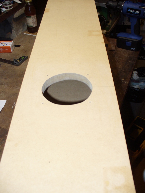

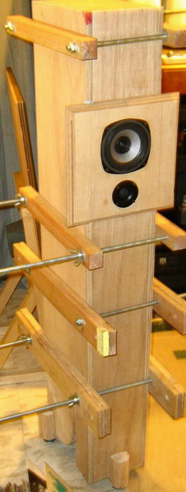

Sure. Here are pics of the temp cutout, the suprabaffle stacked on top of the original baffle, and the baffle and driver fitted. I haven't glued the suprabaffle yet. I still need to smooth out the baffle cutout. I cut the hole out with a jigsaw. Didn't have a circle router jig yet. Helpful accessory!
Here are a couple more pics of the assembly. It took me a long time. This is the 3rd set of enclosures I've ever built. The first being when I was about 10 years old and the enclosure fell apart under its own weight.

Looking good. You do need to releive the backside of the cutout or you will have a really cuppysoundfrom the tunnel. I'd dramatically open up the baffle hole, and the backside of the sB needs a bevel.
