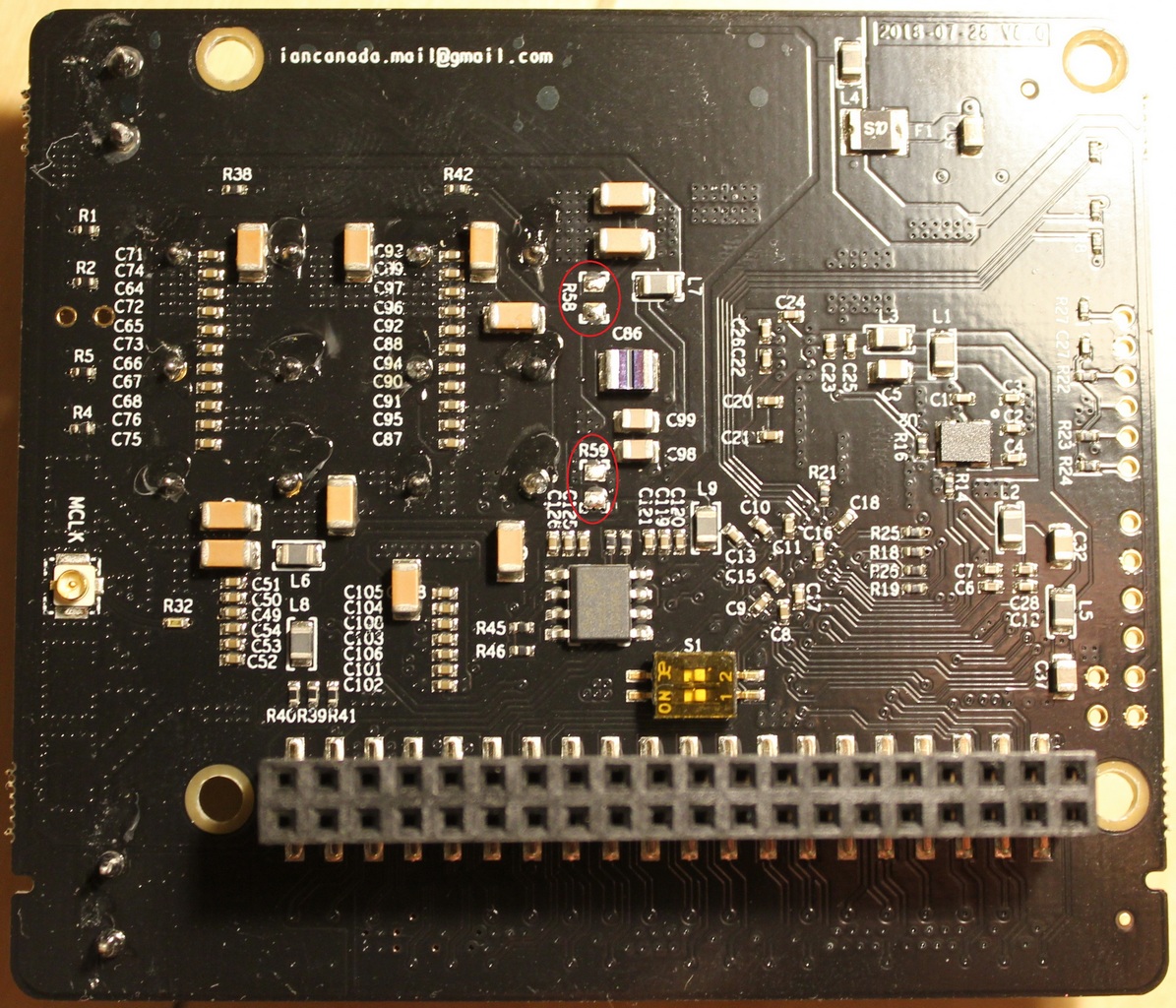

Hi Brum
Glad you had success.
I have done this and power with 3v3 but from LT1963. I dont have a battery supply. I am all linear regs.
I realise I probably have left a lot of performance on the table. Ian is out of battery psus but I am not sure I am really wanting to go that route.
Supercaps also interest me but I'm not keen on the little bombs sat in my living room in case of a short!
Hi Brum

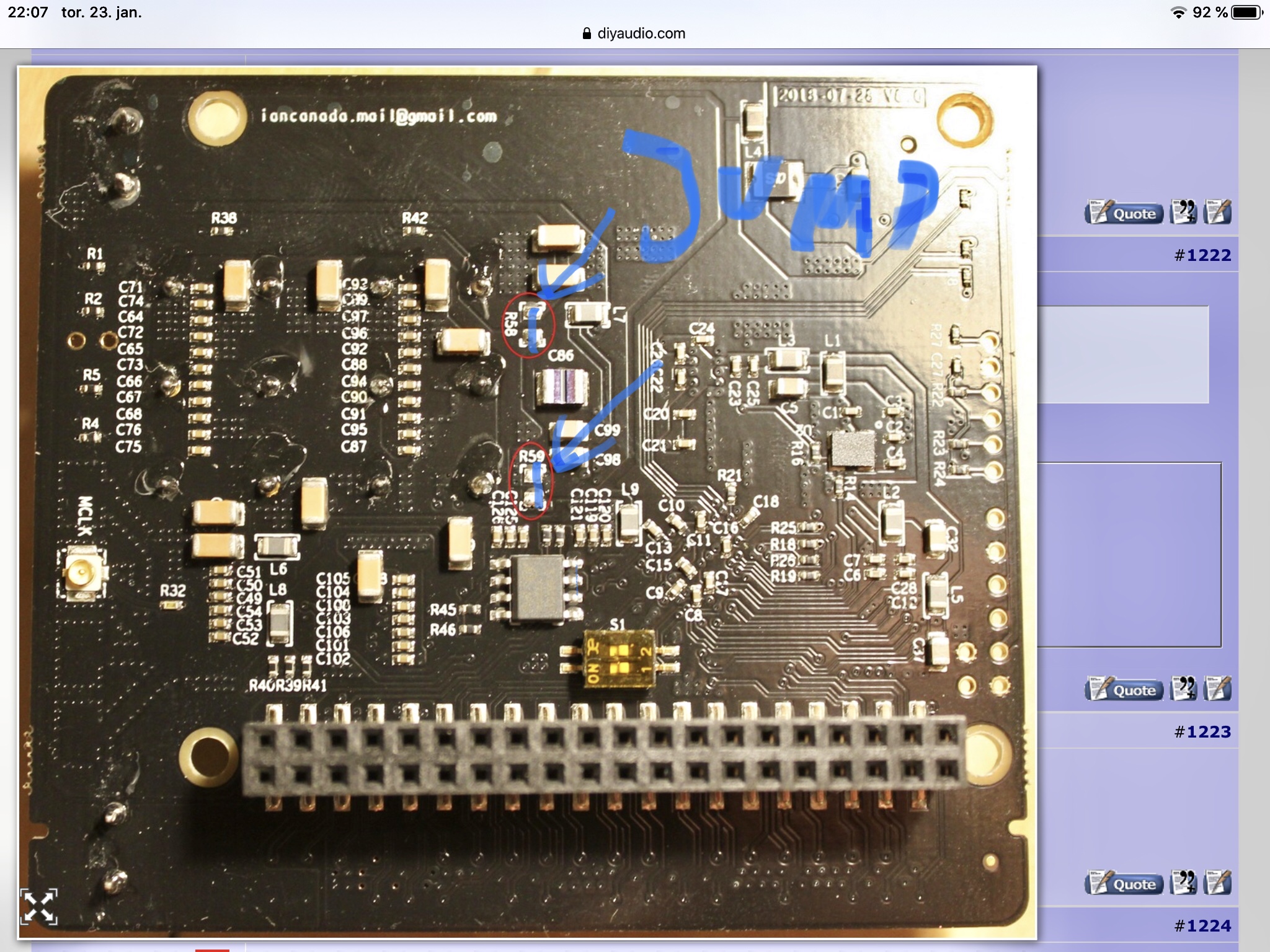

It is certainly more convenient to not use batteries! I have one 3.3v battery that I switch on and off using one of Ian's basic relay boards from a previous GB. Based on only needing one 3.3v battery, I think I will stay with this arrangement, rather than buying the battery management board.
I've bypassed the LDO's this morning and as reported by Greg and others, it makes a large improvement when powering the FifoPi with a 3.3v battery.
Just to make it clear. (for myself). Ian says that it is theoretically best to bypass the regs with a jumper, but if it’s feeded with 3.3v, this will be done automatically. So is theory and practice the same here ? Or ?..
Anyone tried both options ?
