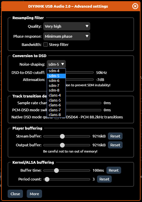

I just installed xmos216 to play DSD512 on Ian 9038q2m+FifoPI in TrueSync/DPLL 0/OSF Bypass.
I'm using Daphile to upsample audio files.
Everything is working well, no pops(I only play DSD512 so no change to pcm), no stuttering.
Music sounds great, I would say larger soundstage, better "density" and details.
But maybe some psycho audio is at work.
I will compare it to my allo katana when I'll find time to install USBbridge SIG.
For those who upsample to dsd512 too: What DSD noise shaping are you using? sdm-4, sdm-5,sdm-8?
I read that sdm-5 is recommended for DSD512 rate.

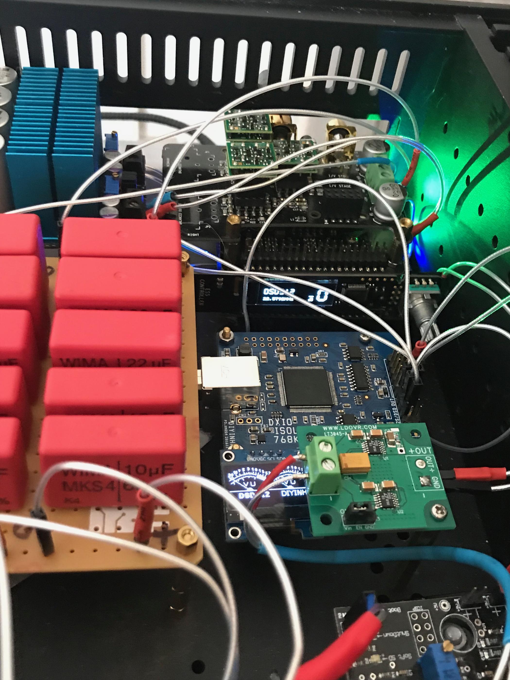

Hi Ian,
Could you show a picture of the other side of you DAC stack?
Do
Hi Do,
Here is the picture of the other side of my DAC stack.
From the top they are:
1. Bisesik transformer I/V
2. ES9038Q2M DM DAC HAT (with GPIO I2S terminator board)
3. ShieldPi V2.0
4. FifoPi Q2
5. ReceiverPi
6. RPi
The USB streamer is connected to ReceiverPi through an isolator board. Actually this isolator can be eliminated because FifoPi is built-in isolated. But I just don't like the noisy PC ground.
ShieldPi V2.0 has double layers shield. It also has a open window for XOs of FifoPi so that taller XOs such Pulsar can be used. The window also makes it possible to swap XOs without disassemble the DAC stack.
