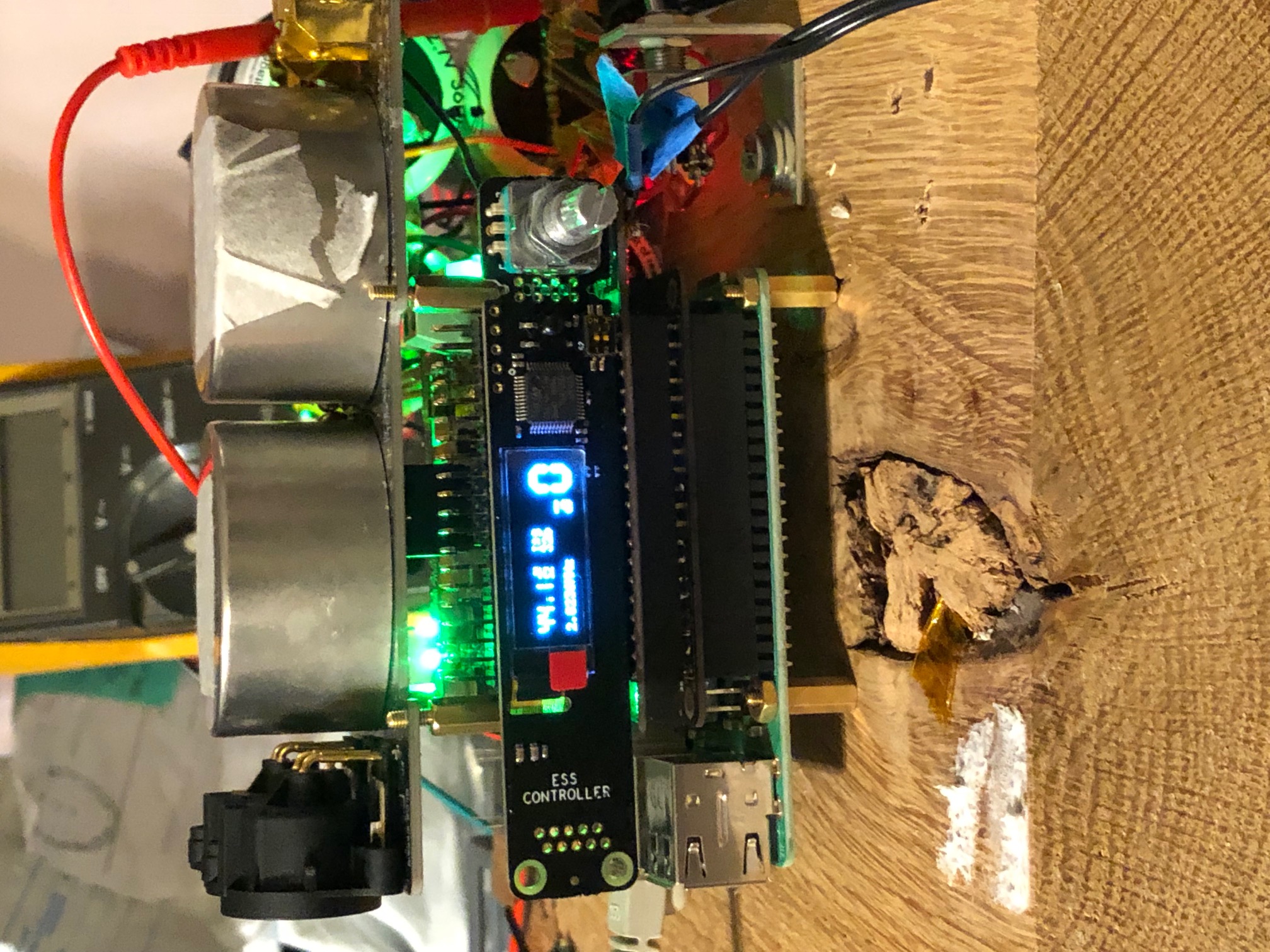

Finally have my setup making music!
So started with an Allo Sparky, but it kept stuttering, little dropouts every few seconds. I managed to get it working once at 44.1k, but then stuttering came back so I gave up on it. Maybe it has some compatibility problem with Ian's boards?
Using a Pi3 instead, running dietpi with squeezesoft and HQP/NAA and airplay.
Output state is Bisesik's iv transformer.
dual mono 9038 dac hat and fifo pi boards, with one of Ian's.
PS is two LT3042 boards generating 3.3V, each connected to two Nesscap 2.7V, 360F super ultra caps. Passively balanced with 90 ohm resistors. I know this is lower than most use, but only downside is a little more power dissipation, lower R will balance better.
So Basically two ultracaps PS's, one feeds DAC and other feeds fifo pi. Thinking about adding two more ultracap PS's for the DAC, haven't decided yet.
I have a linear walwart, 5V @ 1A to power to Pi3. 1A is working fine, I have wifi turned off, and nothing connected to USB.
Letting it break in, but I was impressed listening last night.
Ordered an adapter board and an NDK NZ2520SDA 45.1584Mhz. I'm only concerned about DSD/DOP and 44.1k, so only changing the one clock. May also see if I can get an Andrea clock setup going.
When I change the clock, I'll also bypass the fifo pi 3.3V reg, wondering if anyone has pics of how to do it?

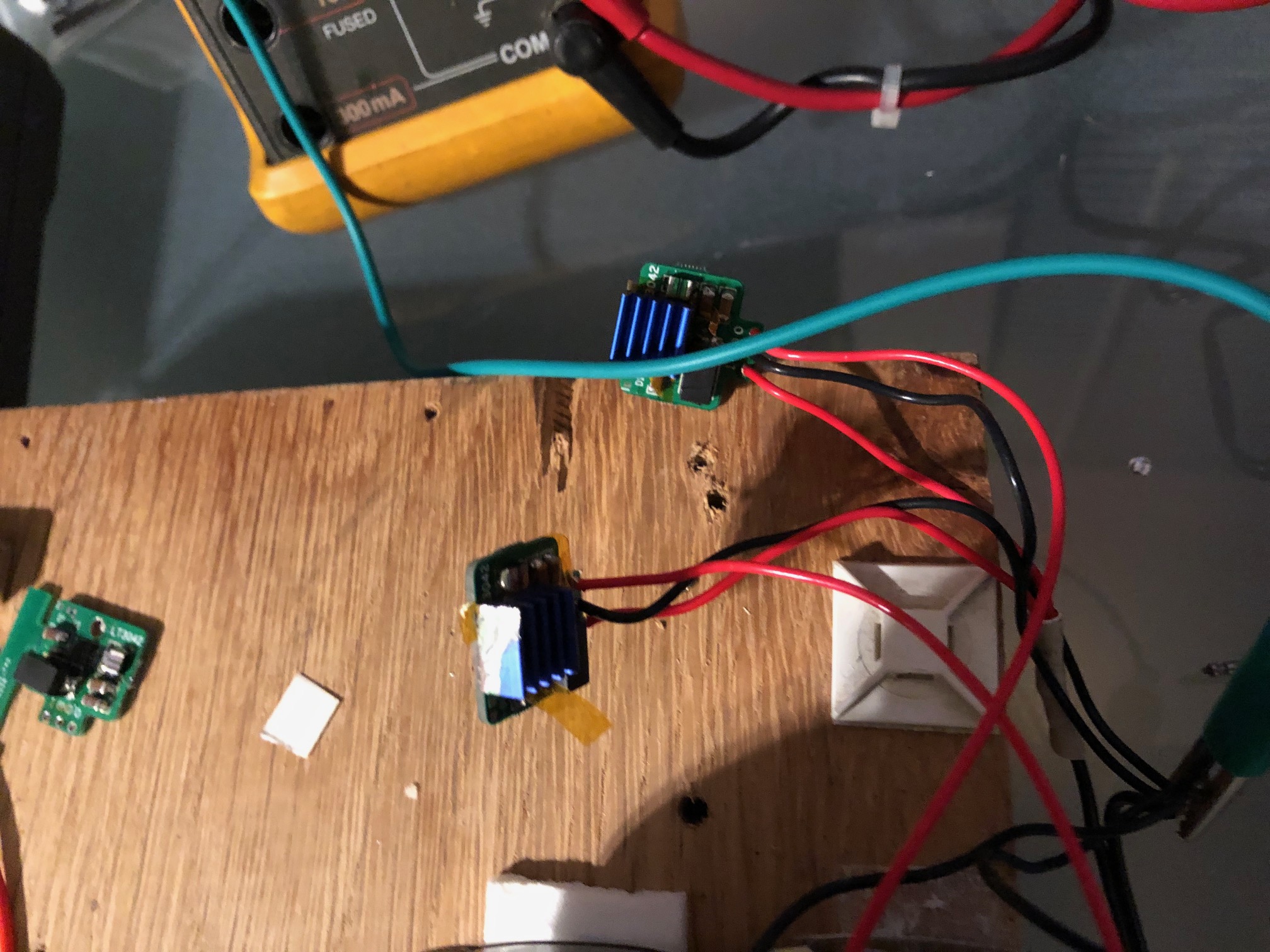

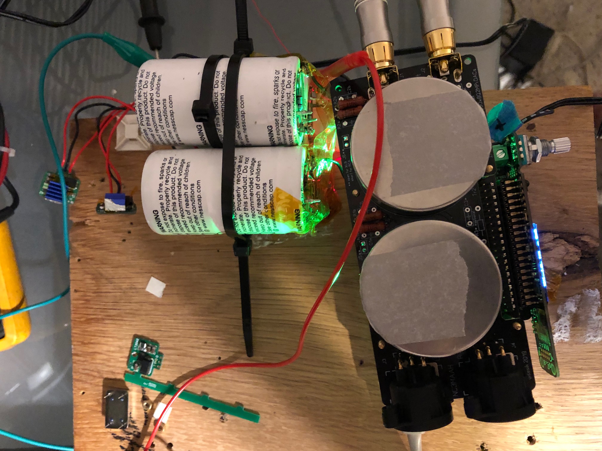

Received a PM with questions about my setup, but I'll answer here, seems like others may want this info.
My Power supply is a 5V, 1A linear regulated walwart from Jameco. It feeds two LT3042 regulator boards. I'm using the free boards that Ian gave out if you asked when placing the DAC fifopi order.
The LT3042 has a built in current limit, I think it defaults to 250 ma if you don't install a resistor, that's how mine are setup. Ian's pl sets it to 200 ma.
The difference is how much heat they generate. To combat the heat, I had a little stick on heatsink which I cut in half with a hacksaw, and stuck 1/2 of each 3042. Be careful to get the heatsink as square as possible to the 3042. Without the heatsink, they get hot fast when charging the caps.
Each 3042 output goes to two ultracaps, wired in series. A 90 ohm resistor is installed from neg to pos terminal on each ultracap, so need a resistor for each cap.
Ultracap "output" (3.3V terminal) to a switch, bottom term. I used a double pole double throw. Switch mid term to boards, one to DAC and one to fifopi.

So I connected it all up, with caps not charged (0 VDC). Per Greg's recommendation, used lots of kapton tape at the ends to keep the caps from shorting to anything. Based on lifepo4 batteries I've used, I'm sure a charged ultracap will dump a done of current if shorted to something. But I don't think the mounting posts connect to anything, so I didn't worry about covering them.
I wired the caps to the DAC and fifopi like the ultracaps were the PS, since they are the current source. So I made the ground wires from caps to boards as short as practical, same with wires from caps to switch to board. Switches add wire length, but I didn't want to wire directly from caps to boards.
I solder power to the DAC and fifopi for all three power sources (including 5V for the pi3). I don't like using the screw down type connectors for clean power, trust solder a more.
So with switch off, I plugged in the 5v walwart to start charging the caps. With no heatsink, it gets hot fast. Heatsink slowed down temp rise quite a bit, but still gets pretty toasty and caps had a long way to go.
So I pulled out a PC fan from when I was trying to make a really quiet PC a long time ago, and set it up to blow air over the heatsinks. Fan wasn't blowing very hard, but this helped a lot, with a fan, temps never got over 100F. Without fan, probably hit 150F after maybe 5 mins and I pulled power.
I accidentally installed a 5V reg in one position, so it started to exceed 3.3V. At 3.4V I knew something was wrong and pulled the plug. Replaced regs with caps charged, and tried again. It worked for a while, but then it went wonky on my and started to discharge, even with power applied. Something may have latched up. I thought I blew the reg, but left it powered on. After it reached 0, it started to work and charged the caps back up. I came back and was happy to find both rails at 3.3V.
At this time, with caps charged and dac running overnight, reg heatsinks were at 90F, so regs probably a little hotter but under 100F.
BTW, I use a little IR thermometer to measure temps. Just point and pull the trigger, they work great if you're working on power supplies or regs and need to know chip temps.
