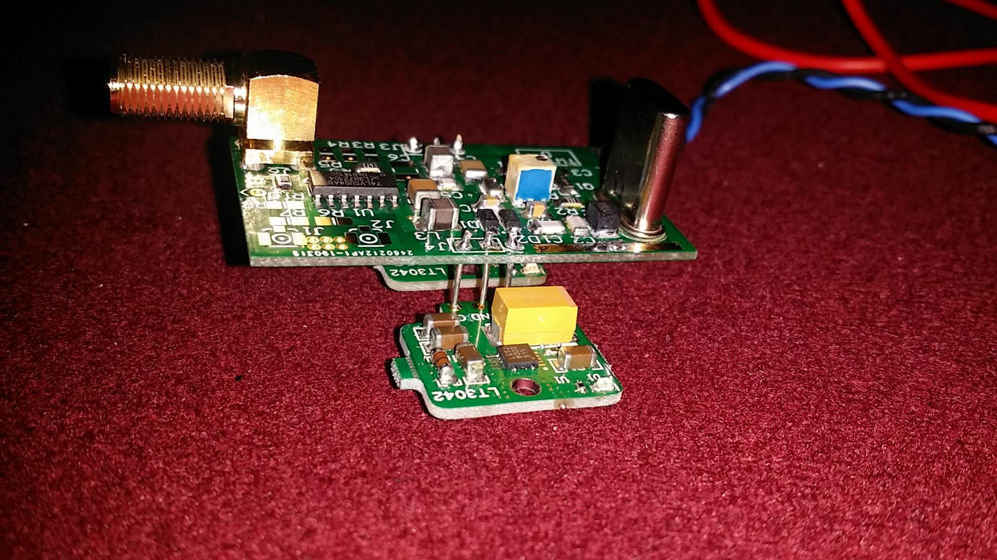

On the metallic area in the middle of the LT3042 package outline, yes, you need to get that soldered to the thermal pad on the bottom of the LT3042. So you need to use solder paste there and make sure it gets to temperature.
I do mine mostly by hand. I use a thin-gauge solder to tin the thermal pad on the bottom of the LT3042 package and also on the board. I also tin 2 opposite-corner LT3042 pin pads. I then use solder wick to remove MOST of the tin from these areas. On the solder pads. I leave a perceptable amount, but not so much that there is any noticable bulge.
Then I carefully align the LT3042 chip on the board, making sure to get pin 1 in the right location, and hold it down with a very tiny flat head screwdriver. I then use a VERY fine tip soldering iron to attach those opposite-corner pins to secure the LT3042 package to the board. To ensure I have them aligned correctly, I solder one AND make sure it is aligned well with the pads on that side, then nudge the LT3042 package if needed to get the other side's pads/pins aligned before soldering that side.
Before going forward, I again confirm the pins are lined up with the pads on the board and adjust if needed. Use magnification here if needed... I have to!
Then I use my solder-rework heat gun to first heat the bottom of the thermal pad area, then flip the board over and hold the LT3042 in place with that fine-tip screwdriver while heating the package top. I use a 30-count on the bottom of the board and a 24-count on the top.
After that cools, I remove the screwdriver and inspect again to confirm the pins are still aligned with the pads AND that the LT3042 package is firmly flush against the board.
If alignment issues at this point, I will use the rework hot-air gun to remove the LT3042, discard it, and start with a new one. I've done a LOT of LT3042/LT3045 soldering (maybe 50-75 devices!) and always buy 1-2 spares for every 4-8 packages I need to install.
Only then do I solder the remaining pins.
THEN before going forward, I use a VERY fine tip probe and check continuity on each pin. I use the fine probe so I can touch it to the small exposed pad area on the LT3042 package side and not the joint to make sure the joint is secure.
Then I solder on the rest of the components.
Note that it takes me about 2x-3x as long to do this (after doing a LOT of these) as it takes you to read to this point! Practice!

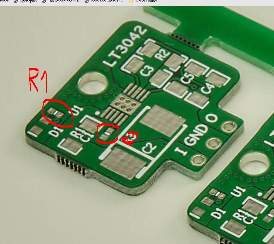

Having started yesterday the first 2 small pcbs were working right at the first test. But what a pain to solder!!! Especially the resistors R1 and R3 and the LED, which I cancelled. Since I am lazy, I only worked with my hot air gun and tried to reduce solder paste to the absolute minimum. This worked except the third reg was not working. It just show slow rising voltage at about 0,8V. Will check it today. Needed some break for my eyes.

confusing reg
Jim, yes, actually a bit confusing. Resistor 1 and 3, if i remember correctly are so small, that their name print is done far away. More in the area of some C's.
I can make a pic later, or tomorrow, but have a look at the board. The tinyest parts are the resistors. They are unbelievable small and really hard to place. Btw, all the parts are hard to place.
Cheers, Ernst

I too found it confusing initially. Study the pcb carefully before soldering. It will become clear where the parts go even though in some cases it is not possible for the label to be next to the part due to the small real estate.Could you take a picture of your small Ian canada reg pcb?
I find the schematic confusing compared to physical layout.
Attached is a pic that shows the parts placed on one of mine.
