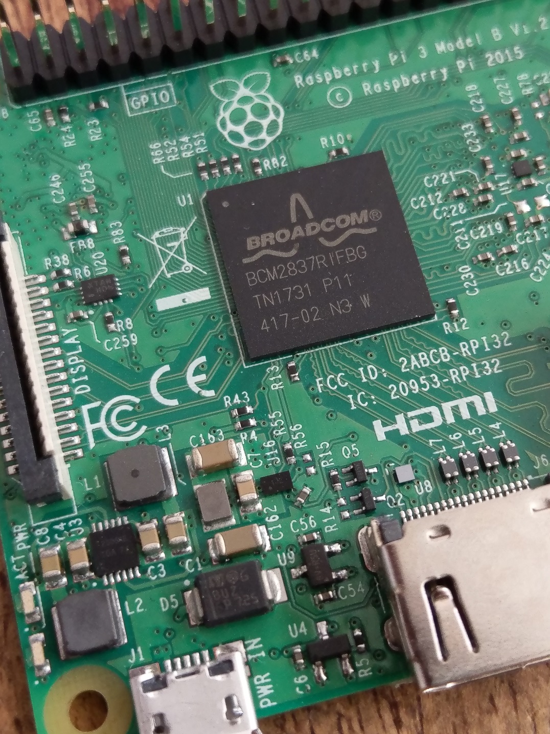

Greg, just for information for Pi3b owners: I do have and currently use a Pi 3b V1.2 with it's DCDC chip ripped off but with the mezzanine board. What I want to say is, there are some 3b Pis you can use with ripped off DCDC chip. Gives a nice improvement here as well.

Question... does that version also have a 1.2V rail as shown in post 41 of this thread:
Mezzanine Power board for Raspberry Pi
I have a couple of RPi 3 Model B V1.2 here and they don't have the same power chip and layout as the 3B+ shown in that post.
As I look at the B V1.2, it does look a lot more like the 2B power chip and layout than the 3B+. See my attached picture and the RPi Zero and RPi 2B V1.1 pictures in this article:
More power to your Pi - Raspberry Pi
AND now that I understand the RPi model numbers a bit better after re-reading all of these posts and articles, this makes perfect sense now!
Again, that's very good to know! Thanks for setting me straight!
