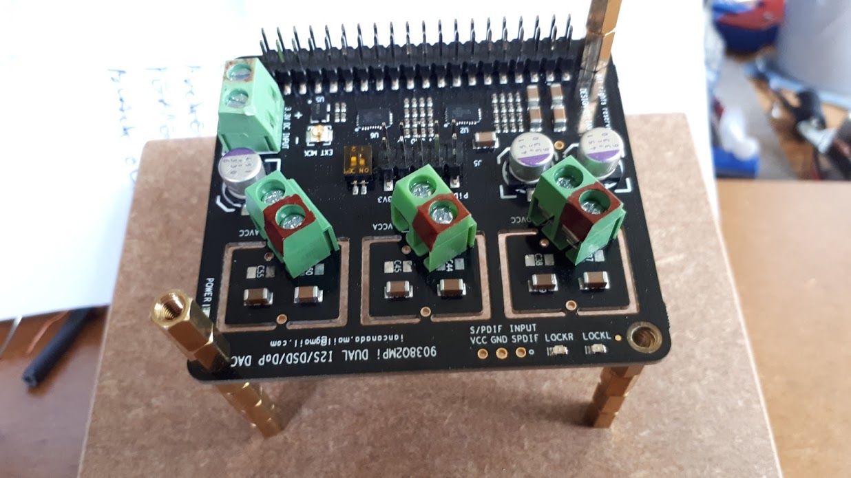

Anyone wishing to add 3 supply rails to the DAC could do so as this photo.
The connectors are a perfect fit across 'in' on the break out board and ground on the main PCB. The pins need a little filing, cut the 'in' track between main and break out boards. Remove 2 SMD caps.

@misterdog
Can not see the picture
Ian
I think there could be an issue with the site, Google photos, or me.
I PM'd Adrian 311 with the link which worked, maybe someone could post a photo to narrow down the fault ?
Here is the picture from misterdog.
