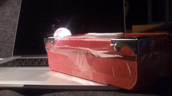

Got my package about two weeks ago, but just got around to sending a message. It's been a crazy time.
The box looks really nice, but the contents even nicer ! Thank you Ian for your hard work!
