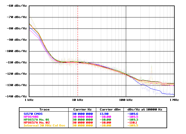

This is the measured phase noise of SI570 extracted from here: Si570 Kit from K5BCQ
IMHO, not suitable for audio 🙂
funny that its already been used pretty successfully in audio. all clocks get worse as the frequency goes down and the crystek is no exception, the crystek is an extraordinarily good XO and has quite a bit better performance down low. It does not come in suitable speeds to solve the very particular problem i've been talking about since the post on the previous page, a problem you have not offered an alternative for. we all have access to the datasheet, posting excerpts from it tells me nothing the thread (anyone whos interested enough), myself or Ian dont know

My point is clear: si570/571 proposed by you isn't suitable for audio. It is just a generic XO with a variable output frequencies.

Just a kindly discuss with you. I saw that phase noise plot long times ago. But I don’t know if you noticed the testing condition. The guy did the test by a R3463 spectrum analyzer , not a phase noise analyzer. He clearly mentioned that he had limitation on close-in phase noise measurements. That means the close-in phase noise result was not accurate. However the Si570 phase noise floor won all other reference oscillators which was true. So, I list the link of where the plot originally came from just in case there was any misleading by it.
http://www.cliftonlaboratories.com/si570_kit_from_k5bcq.htm

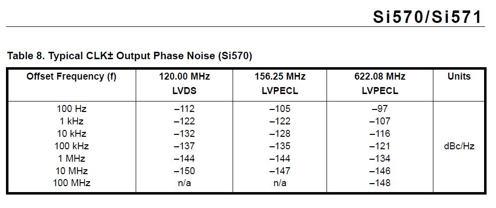

I attached the rated phase noise performance of Si570 from Silicon Labs official documents. It’s -112 dBc/Hz at 100Hz and -150dBc/Hz at 10Mhz, sounds not that bad. At least, among all the XOs with programmable output frequency, it one of the best.
I don’t know what kind of XO you are looking for, as you said, suitable for audio application. Actually I have all of the four XO oscillators you mentioned, CCHD957, Si570, NDK, TentLabs J. I did very careful test and comparing between them. But I would not post the result. Because too much personal preference. I’ll leave this part to other members, as well as the funs. I pay respect to their knowledge and their ears. I don’t think you’ve already experienced Si570 for it need a firmware driver and an evaluate board, but I’m highly suggesting at least doing a comparing test between the other three. The result would be very interesting.
BTW, Si571 is a different story. It has an analog frequency feedback control input Vc which is very easy to introduce phase noise. It results in 30dBc/Hz worse than the Si570 on close-in phase noise performance. So I’ll not take Si571 into account.
