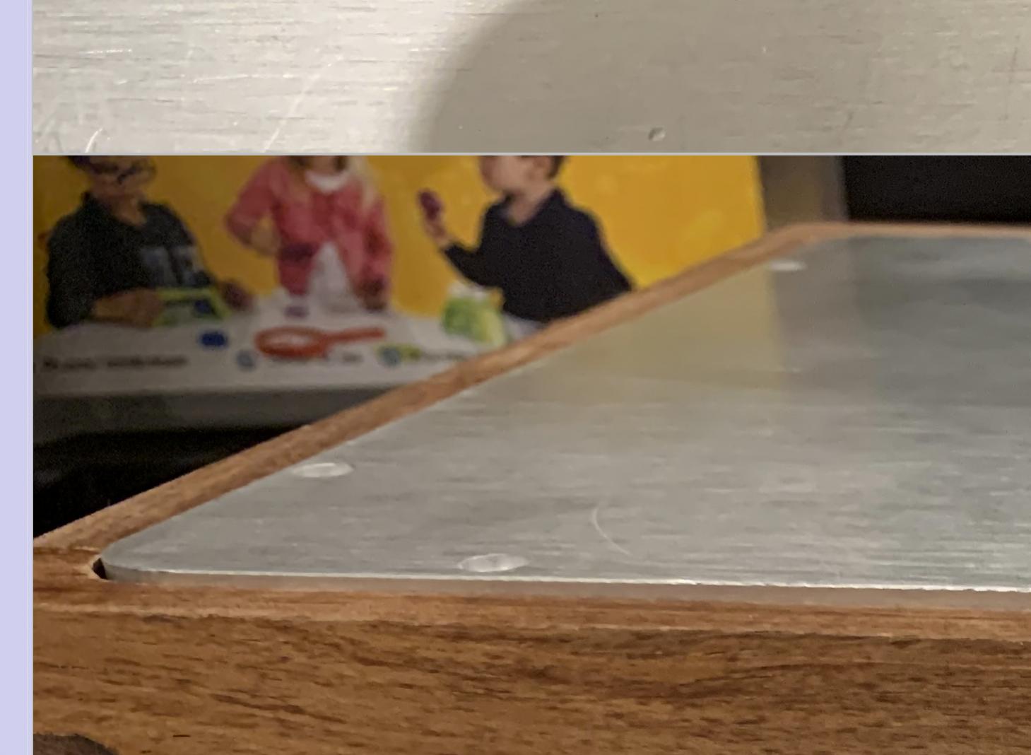

It can be done by mounting the stationpi on a piece of aluminium a little bigger than the stationpi. . Then you can use long stand off that will help you to position the UcConditioner board a few centimeters above the raspberry. You can even mount it in such a way that the green connectors on stationpi and UcConditioner will be just a few centimeters apart.
You can use a similar idea for the 3,3 volt boards but you will take care about cables ( if you will use the clocks from Andrea)
I will make a construction with 3 levels where the first floor will be the lifepo4 board.
And i will use 3 3,3 volt boards plus the big 5 volt board.
Greetings, eduard

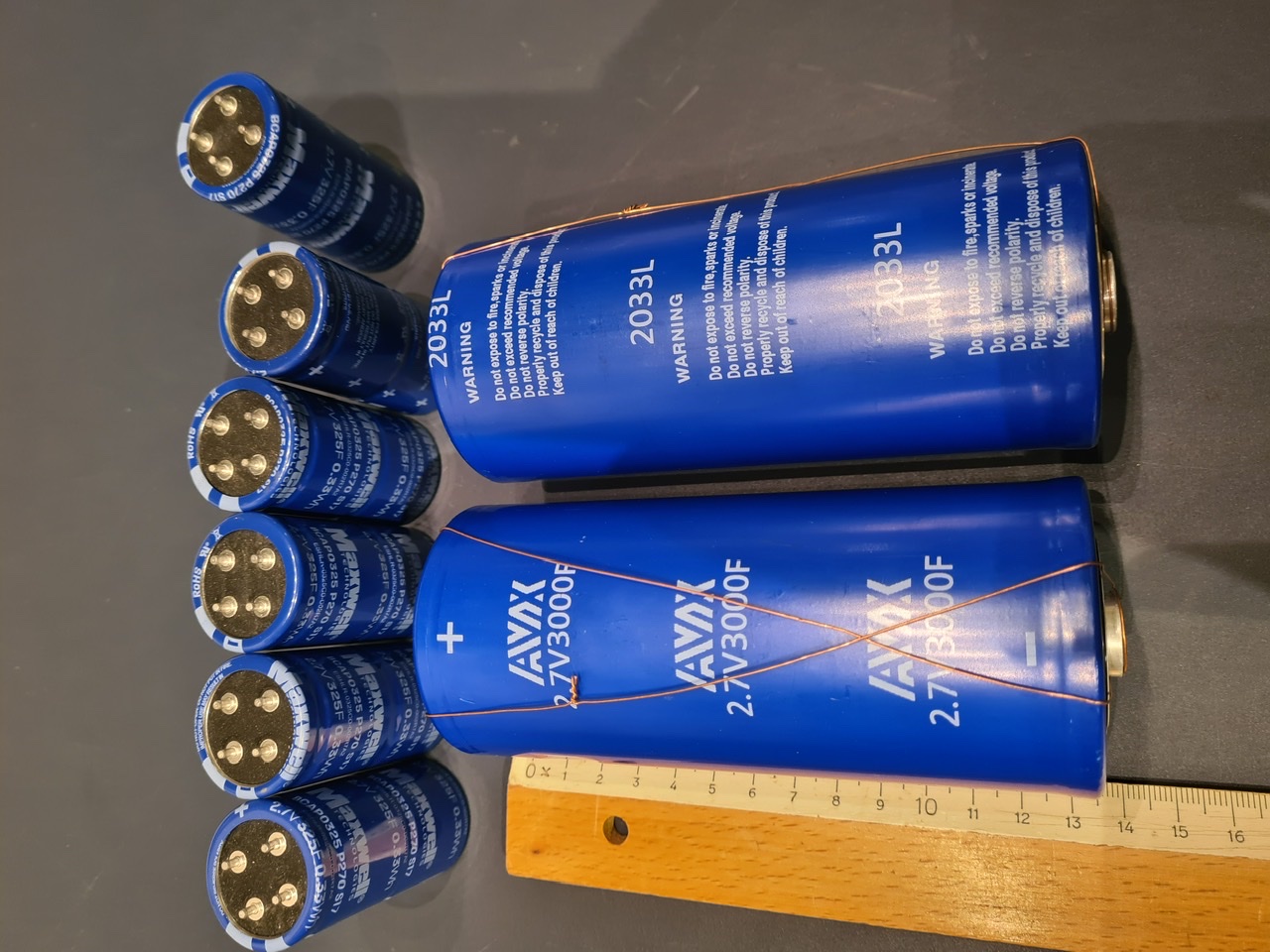

Hello Ian,
A pair of these big and i guess heavy caps will be '' installed '' using the usual methods seen on diy audio upon a piece of wood that is already overpopulated.
One day when you are bit tipsy during a blind test with your audio mates and then someone causes a short circuit with a ring, watch, belt, zipper when you are out to get more booze.
Greetings, eduard

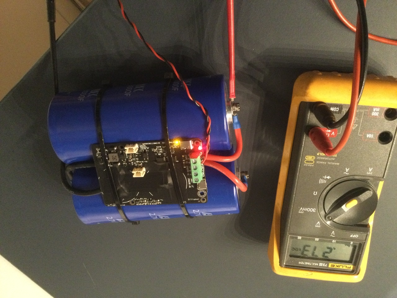

I have experimented with 3000F caps on the UcConditioner. It works, but in my opinion it is a big chunky piece of power supply for very little improvement over the standard UcConditioners and only for 5v. I usually have several power supply rails to populate and also at higher voltages.
Maybe Ian has designed a better way to use them: floating like a battery supply instead of parallel to the raw power supply.

Hello,
Of course the 3000F can offer some benefits if it can be used without being connected to the electricity coming from the wall.
BUT if you count the number of crimping, soldering and "" sliding " contacts i wonder why nobody tries reducing that number. Once you know where exactly the UcHybrid board will be positioned in relation to the lifepo4 cell there will be room for improvement. WHY not solder a cable at both ends to connect the cell to the supercaps..i think the big number of contacts between these two parts will do more damage than a bit more cable. But of course if you can use 3 inch, 8 centimeters good cable directly soldered why not.
If you use the supplied cable it will cost you nothing. .
Greetings,Eduard
Please wait for my UcPure for the 3000F ultra capacitors.
Ian
Hello,
I think that adding this seize/weight of caps to the already big collection of boards on a wooden panel like we can see here usually will be downright dangerous. These caps need to be attached in a proper way, no tie raps, instant glue, silicon kit or duc tape.
Greetings, Eduard
