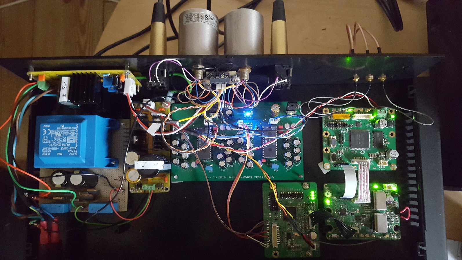

FIFO2, CLOCK & i2S-PCM DUAL 1541 ALL NOW WORKING.
I eventually damaged my first I2S-PCM board by connecting to 15v instead of 5v. Ian very generously replaced it for the cost of the cost of repair.
I also then bought a Fifo 2 and dual clock board.
Today it is all connected and it sounds superb. Better than the dual AD1862 I have been listening to in the meanwhile (via SPDIF and a SRC4192 EV).
The CD transport is a used Denon DN-C110 professional rack mounting Cd player modified to provide the three I2S signals buffered by a 74LVC245.
(Actually the data is 16bit right justfied which the FIFO2 accepts when pin 5 is jumpered and which was the cause of the distortion on loud passages when fed direct into the I2S board)
I/V is four 50R resistors and the Sowter transformers. By using balanced operation, the static 2ma offset of the dacs is nullified so no DC flows through the transformers which si essential.
The wiring needs tidying and my MK2 dac pcb will have pads for U/fl connectors for the data but I am relieved I now have something great to listen with.
