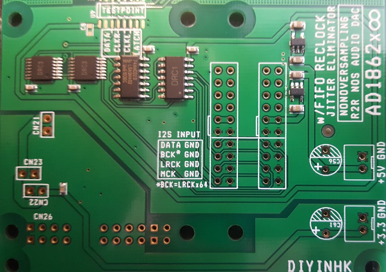

I had previously asked Ryan for his pcb gerbers to TRY and get started into analyzing how to on pcb design. Ryan graciously attached the gerbers - Thanks, Ryan!! But learning curve is a bit challenging. Hard to teach an old dog new tricks!

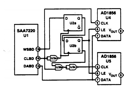

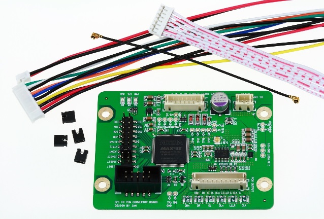

I just stumbled on this and find it very similar with the exception of another IC. Was thinking of using this on a TDA1541a under simultaneous mode but too ignorant to know whether this can function without MCLK since RPI I2S only outputs BCK, LRCLK, & SData.
Do you know if this can function as I2S to Simultaneous converter?
I have not tried or know about TDA1541 in simultaneous mode so I don't know.

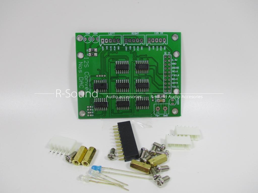

I wouldn't buy that converter - it's hugely overpriced - I paid US$11 for mine. China pays next to nothing for international shipping under global agreements, so that is just a huge rip off.
As I understand it, it's basically a copy of Pavouk's design with an additional buffer (for simultaneous signals?). More rip off. PRC = The People's Republic of Copies.
Here's Pavouk's pages.
