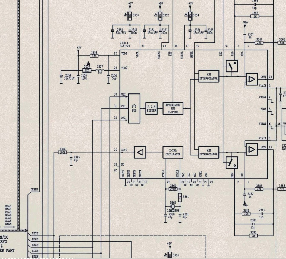

I2S signal from this circuit
Hi there,
I want to pick up the I2S signal from the attached circuit.
Can some help?
Many thanks!

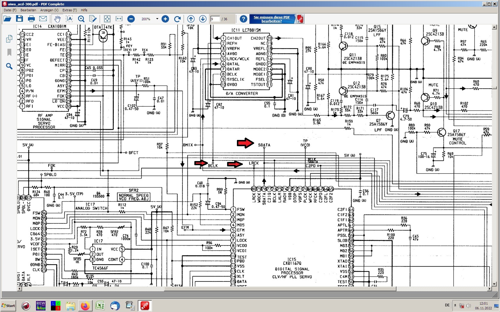

I think also that it is not I2S format
The dac chip on the sch is Sanyo LC78815M
please take lokk at the PDF

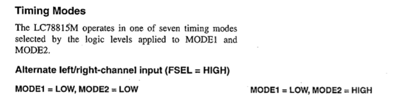

Also it have 7 posibile formats (non of them I2S)
try to detemine which format is used by checking mode settings pins?
FSEL pin 12 is HIGH connected to pin 10 (DVdd)
MODE1 pin 13 is LOW connected to pin 15 (DGND)
MODE2 pin 14 is HIGH connected to pin 10 (DVdd)

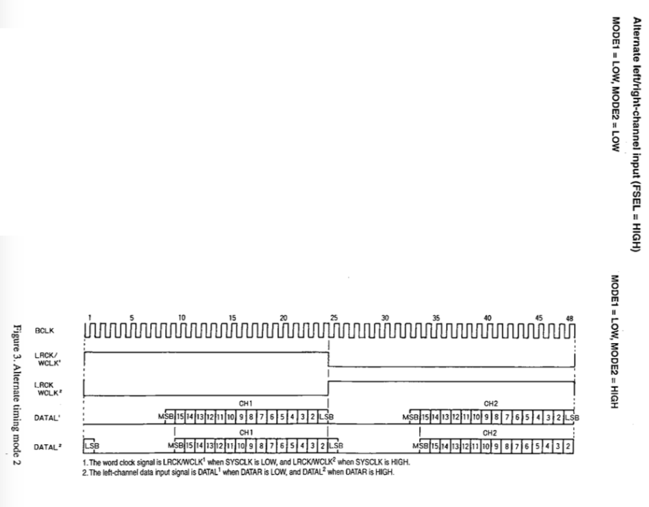

So it is the the figure 3 format alternate timing mode 2 from the datasheet page 6.
not good news 🙁
48bit lenght for Fs, right justified ets... Compare to the I2S standard...

And it have posibility of 2 cases format. See the picture.
You have to measure and determine which of these 2 is present.
And based on that eventualy think about some translating circuit?

Thank you Zoran, but I got the I2S Signal from the circuit and player in post #4.
As it is a Phillips circuit it works.
And it sounds not bad - guess the missing 2 times SPDIF translation is the reason.
But I have no idea how to implement a mute circuit.
I get Plops if I change CDs etc.
