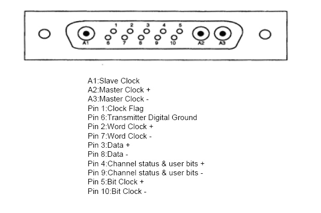

No. There were at least two 13W3 based versions I2SEnhanced and I2SPlus which was Muse. And they were not compatible with each other.was there a I2S 13W3 standard back then? because if not the 13W3 I2S inputs could differ from brand to brand.
Yes . It was also referred to as the Universal I2S interface. Remember this was about 25 years ago.
I just remember the Sun Ultra workstation 13W3 monitor interface, that I somehow managed to mate with a VGA monitor 😏 It was not today either.
maybe something like this?Yes . It was also referred to as the Universal I2S interface. Remember this was about 25 years ago.

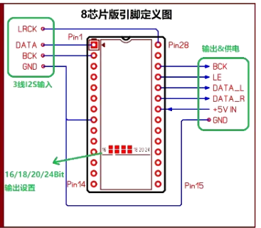

also, I ordered a chip that is supposed to replace the df1700 and make the dac "nos".
is it dangerous to put this instead of the df1700? could it possible damage the dac?
