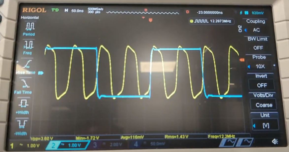

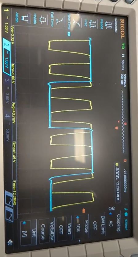

I measured the timings on a previous ADAU1452 project.
1 is ADAU1452 CLKOUT vs ADAU1452 BCLK out.
2 is Crystal direct out vs. ADAU1452 BCLK out.
Unfortunately I don't think this looks usable with a single flip flop reclock. I would need to delay Crystal direct out or ADAU1452 BCLK out in some way.

I don't think Mark understands your question here. Inverting the clock will still give you a setup time violation, yes, depending on the propagation delay of the inverter.
Sorry, Mark is correct. I misread your post I think. Inverting the clock looks like it could work with the clock output directly since the falling edges are not occurring during transitions.
