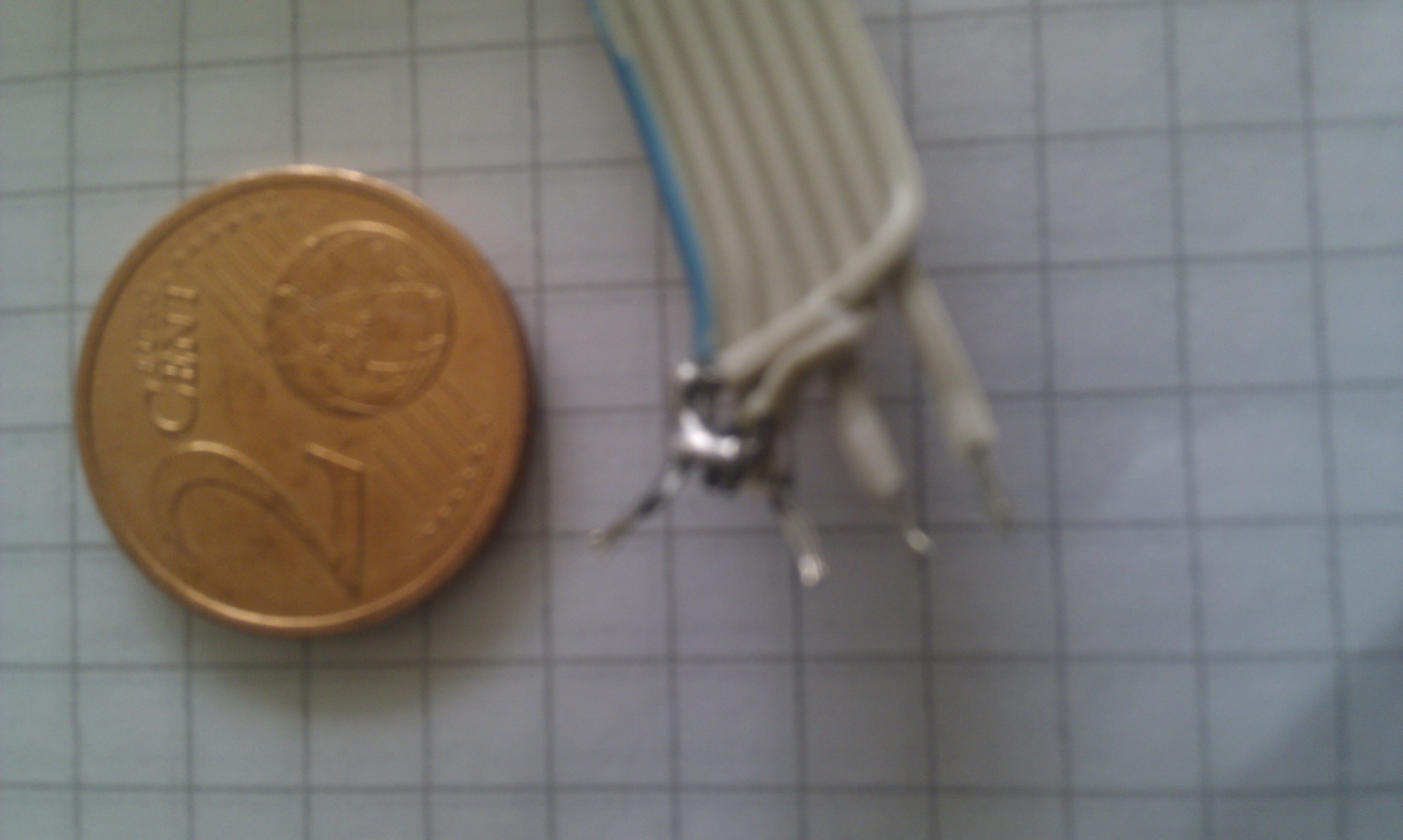

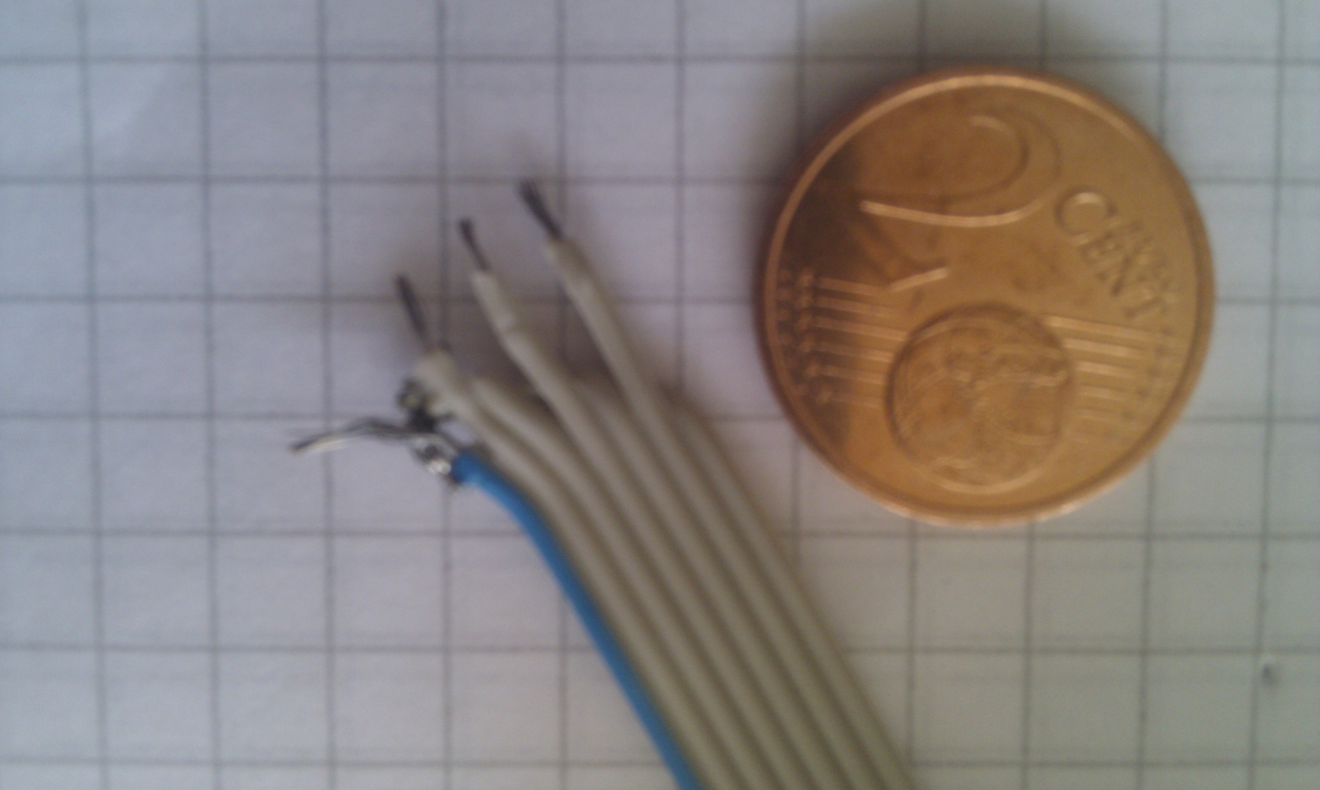

Is this DIY cable good enough for 8 to 10 cm of I2S ?
Its GSGSGSG : 7 cable which 4 Gnd soldered together but the 3 gnd cables recover the 3 hot cables with 90° to be sold together on the fourth gnd (blue one).
What is the worst here ? Bad diy like that with this length or stay SPIDF with 20 cm but full 75 ohms ?
On one side we have the Squeezebox Duet Xilinq chip with 3 x 25 ohms resistor and of the other side I2S line for ES9023 with the possibility to have 50 ohms resistors (Subbu DAC). If I2S better than SPIDF here, do I supress one of the two grups of serie caps (the 25 ohms on the emiter, we keep it always at the end ? or reverse reflexions can occur also towards the emitter?
Series: 25 ohms 5xilinq chip) + 8/10 cm bad cable + 50 ohms = around 75 ohms !
