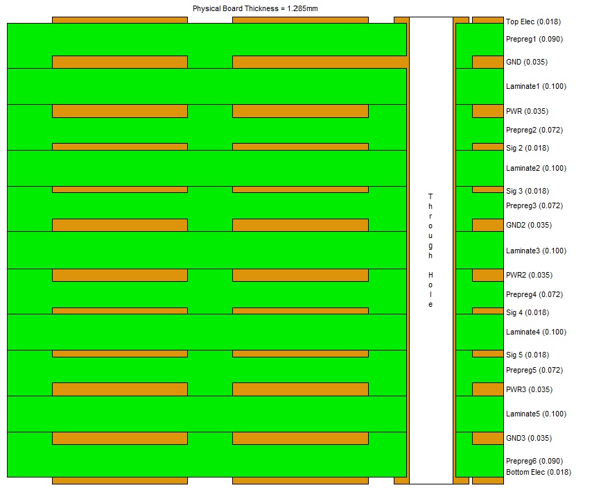

Transmission line rules apply to these and we will sometimes simulate them using the signal integrity verification software. Numerous reasons why, one of the main being, if you look at the IBIS data for a lot of serial drivers they are quite low impedance with quite a strong current output, so often the signals will have quite a few reflections. Using the simulation software allows us to calculate the values of any termination required to match the PCB characteristic impedance.
Standard PCB impedances for digital signals are usually between 50-100Ohm, depending on thickness of copper, trace width and distance from return signal plane. You can use this:
Saturn PCB Design - PCB Via Current | PCB Trace Width | Differential Pair Calculator | PCB Impedance
to do some rough and ready impedance calculations. For the simulation software there is a full 3D field solver that does a much more accurate job, though you do have to detail your PCB stack up with thickness of all layers and the materials used for the pre-pregs and laminates (we have a data base of all the common current laminates available that we use).
An example of a 12 layer stack up attached below. Only about 35% of the designs I do are actually controlled impedance boards, his is due to the increased manufacturing costs mainly, as you are adding 15-25% to the cost of each PCB, depending whether you want the value controlled to 10% standard or 5%. The rest, are standard boards, where your impedances will be within 20-25% of your desired impedances. For a true controlled impedance PCB the manufacturer has to do a test coupon for every panel and measure the impedance of every test coupon before the boards can be released. The main breakpoint for companies to consider both controlled impedance designs and simulation at the moment is when they start to use DDR memory interfaces (even then a lot don’t, due to costs). But with the ever increasing rise time of todays devices, signal integrity is becoming more critical for even the most basic circuits. As said we are seeing more request for simulation on common busses that aren’t considered as high speed but are critical, these being JTAG clocks and sometimes the full JTAG bus, SPI in its many guises and clocks in general, even down to 12MHz clocks.

When we do controlled impedance designs we work closely with the manufacturer, who use the polar tools to help work out our required PCB stack up, the laminates to use and the thickness of these laminates. We then enter this information into the PCB design layer stack up so that the simulation software is working on the correct data.
