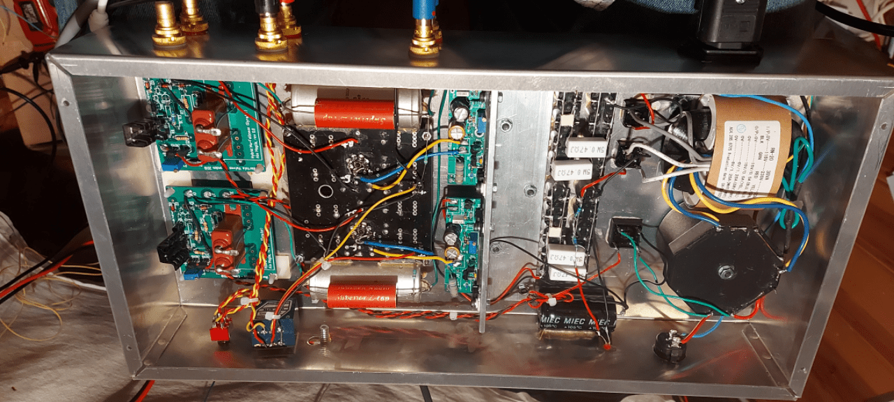

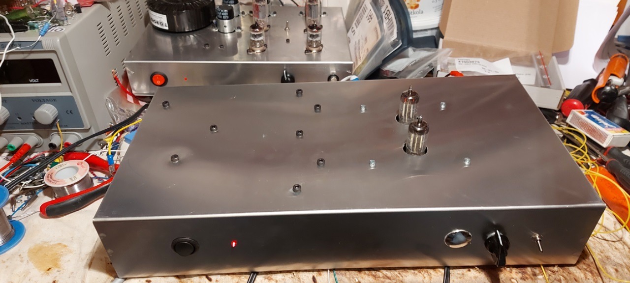

I´ve built a 3A5 preamp
I´ve built a 3A5 preamp:

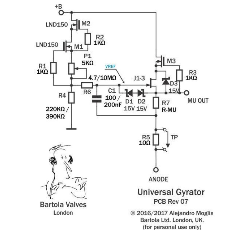

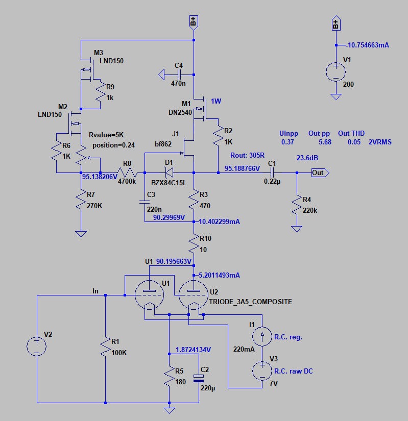

But what I do not completly understand is the Gyrator.
If I set the voltge (Anode) to about 100v,the current through the tube halves is 10mA 20mA per tube,maybe a little high.
And if I set the current to 5mA /triode ,10ma per tube.The voltage is about 60-65 v at anode.
The question is how do I set it?
By the way This one is microphonic....
If I ask like this,how much current is it safe to run throgh the 3A5?

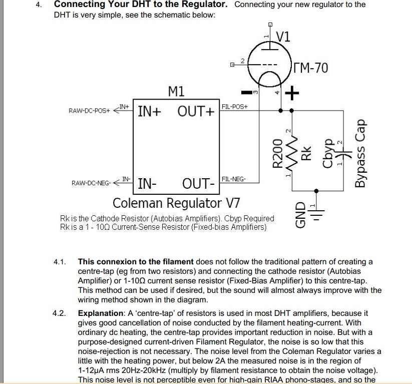

Information like this is published in the tube's data sheet.
Current is only one factor that needs to be taken into account. Dissipation is what you need to check, which is the current multiplied by the voltage across the tube. Here's the data sheet. It lists maximum plate dissipation of 0.5w when used for audio.
"Typical Operating Conditions" lists a combination of 90v at 3.7mA which produces a dissipation of 0.33w.
https://tubedata.edebris.com/sheets/127/3/3A5.pdf

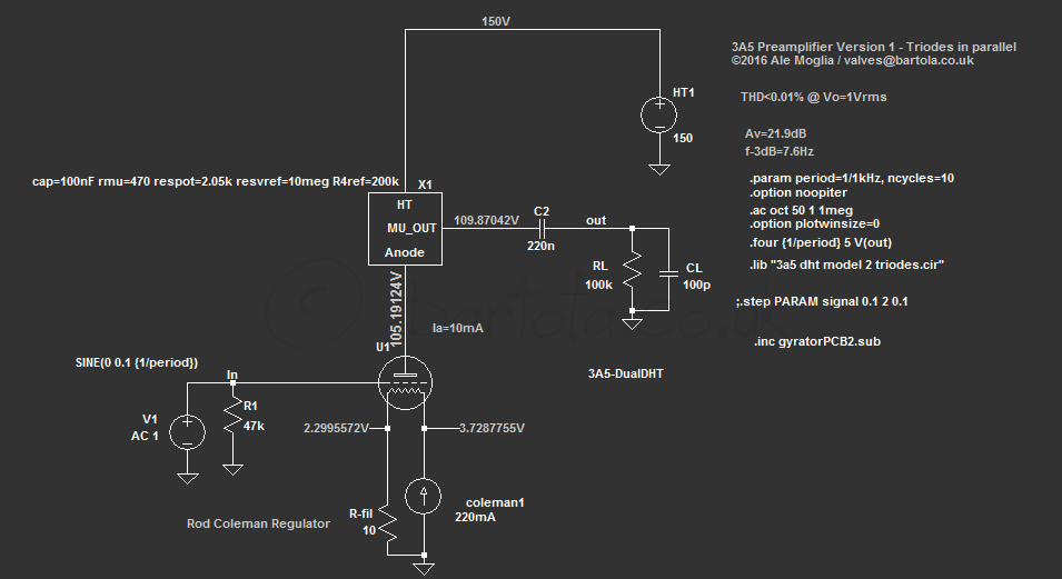

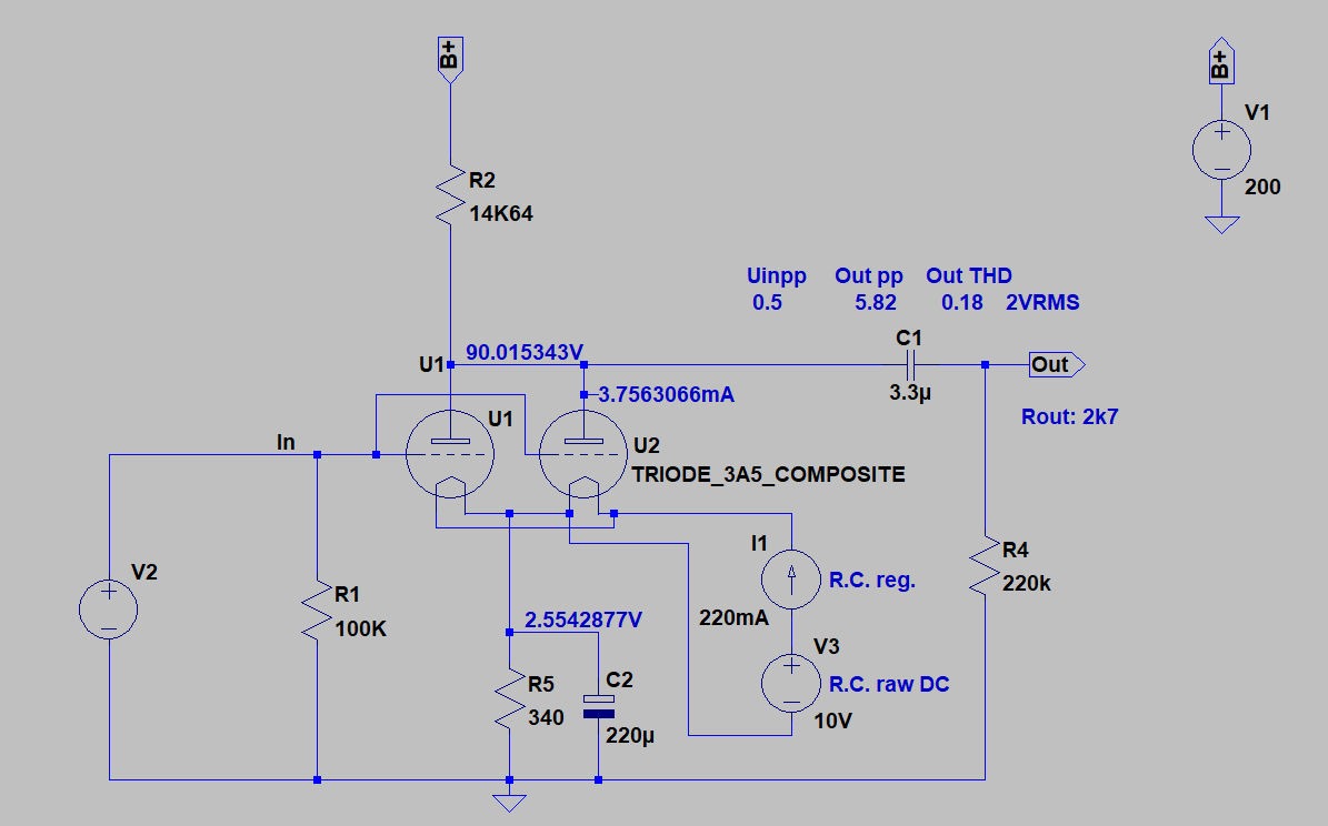

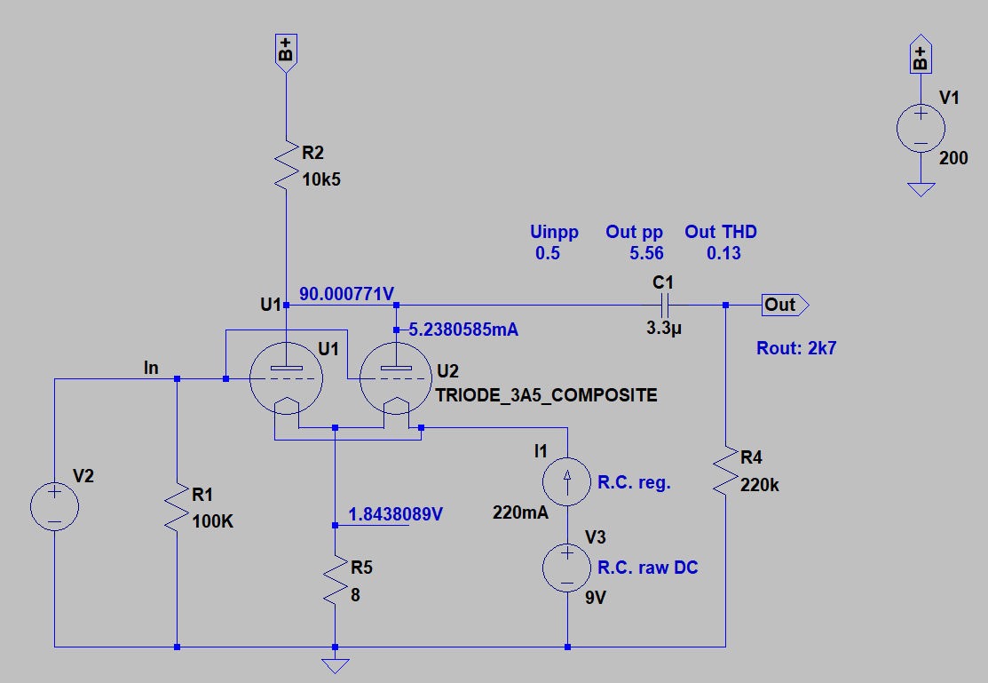

The bias method in #1 post and in #7 russian picture are different.
The first is filament bias.
The later is "classical" cathode bias.
BTW as I wrote another topic, the Rod Coleman regulator parts and the raw supply MUST be "ground independent"!
The raw supply voltage at least: filament resistor voltage (if it is filament biased)+ tube filament voltage + 5V!
After you get it working ok - have a look again at filament bias from your first post and then you can see which way you prefer it.
Be very careful with the heaters on the 3a5 - they will not withstand much voltage, so be very careful when you are connecting the filament reg for the first time - voice of someone who burnt one out in a stupid moment!
