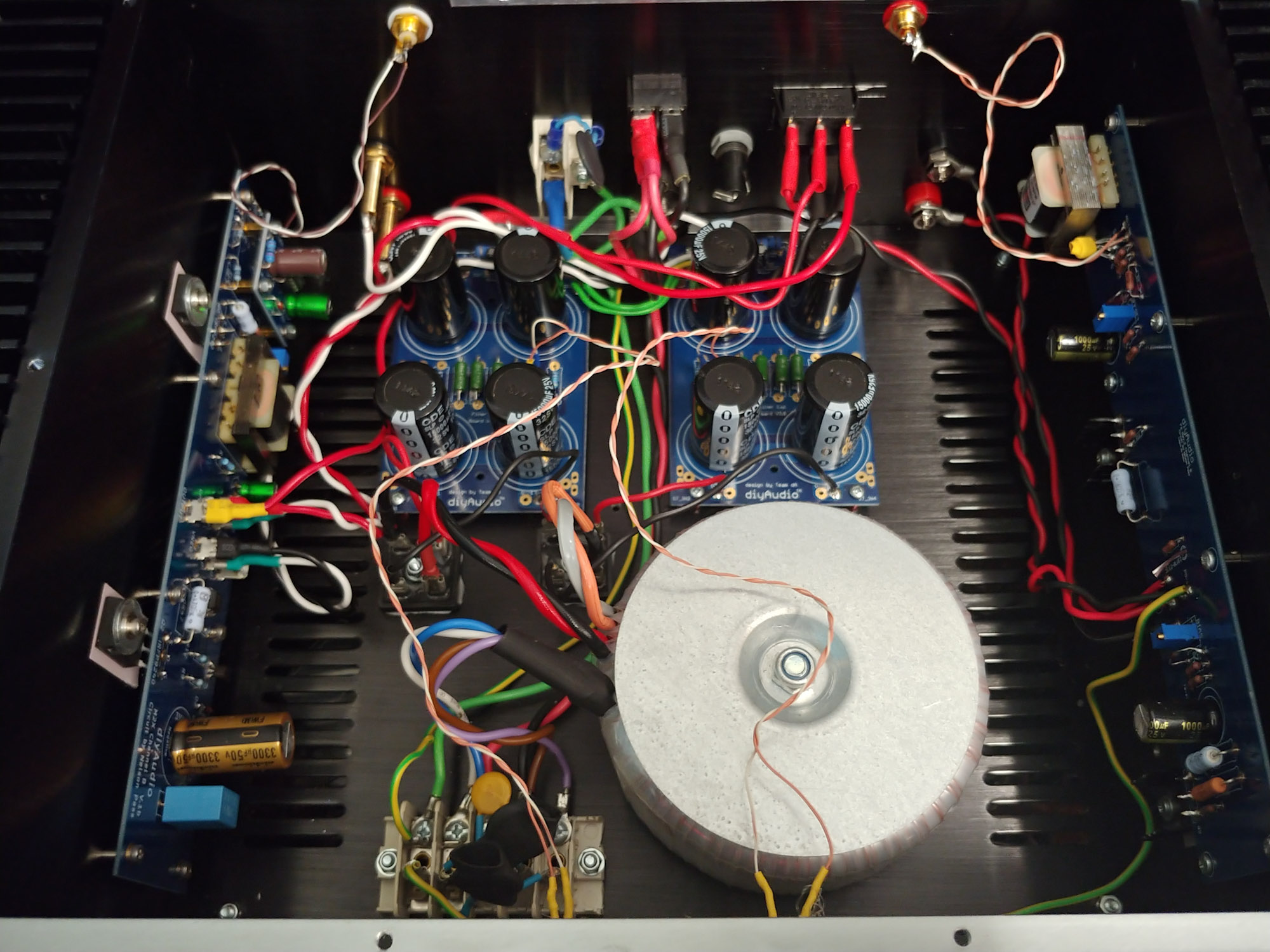

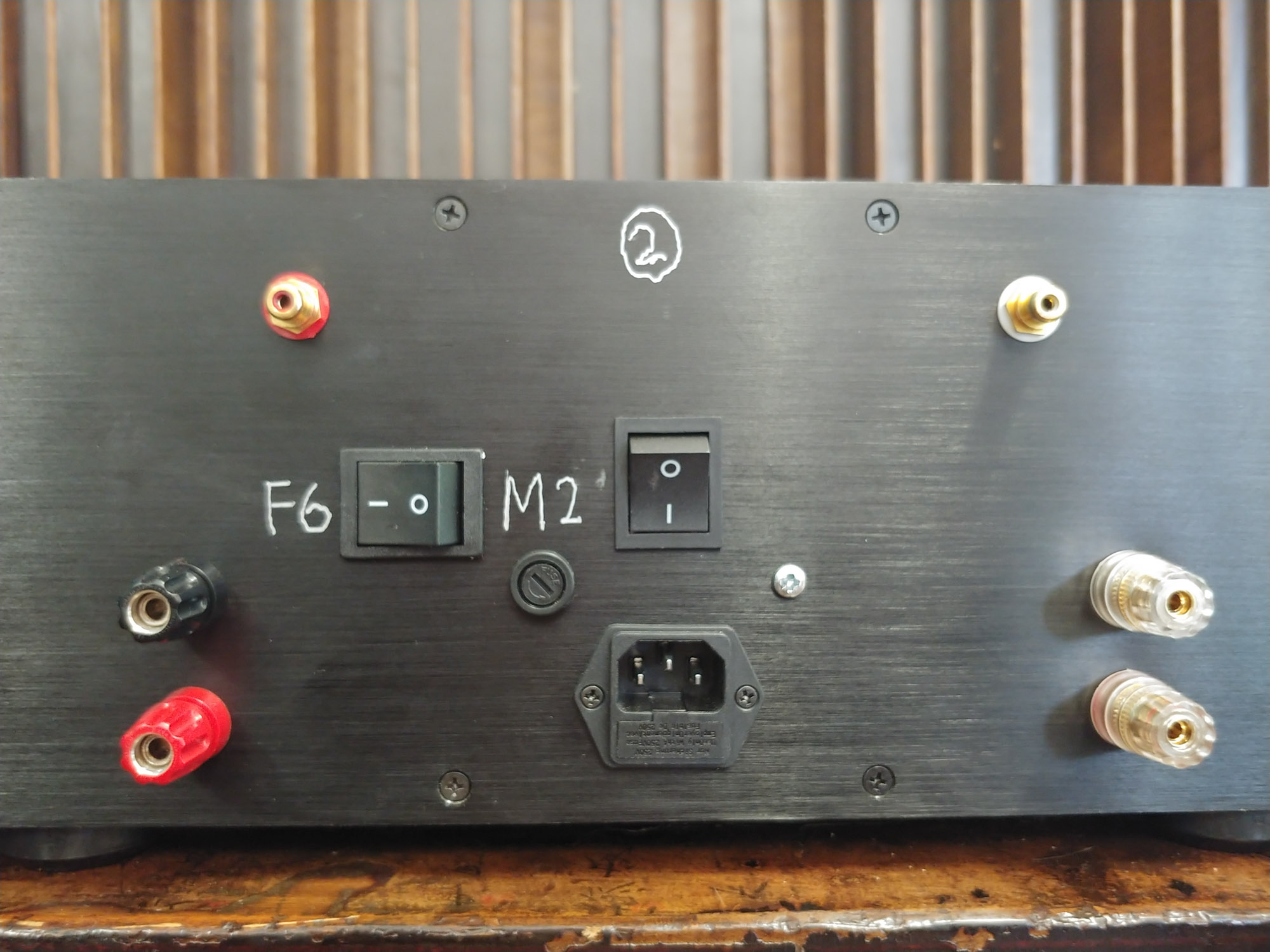

Having thought of this ideas and read Aljordans report I decided to embark on the same dual mono pathway with my F6 and M2 amps, which were in identical chassis with almost identical power supplies (different brand same spec transformers). It has been a great success with the DPDT switch on the power rails and the earth constantly wired, no hum. The switches cost $Au28 and the amps sound more solid in the mid-range ( I use separate bass amplification), well worth the effort. One small suggestion; wire the matching amp boards on opposite sides of the two chassis so you can stack them without getting heat buildup on one side alone, cheers.

someone wise once told me that I should order PSU components in X multiples of PSU boards because, as they put it, "no one ever builds only one". Compound that with antek being out of 300 or 400va 18v transformers, noticing that they do instead have AS-2218's in stock, and this thread, and it all got me thinking.
Right now I want to build my first DIY amp from an aleph j pcb. If I build it now with dual PSU's using 2X 200VA toroids, I'm thinking I can just take out one toroid and PSU board to stuff into another 4U, whenever that itch strikes, likely for an F4.
This a rational idea? 200VA I'm assuming is more than enough for a mono build given that 300VA is plenty for a regular stereo build. Right? Anything I'm missing? /not an electronics guy

About to perform this to my M2 (teabag version) and Aleph J. Cant help but feel a little silly "working on" two amps that work perfectly, but its a proven path so here I am.
One question I have before putting power to it. Answer seems obvious enough to me, but I could look at double burning amp for the 7/4 celebration.
Obviously the V+ and the V- of the power supply are switched, question is about "0" connection on power supply.
I assume (here we go...) that the board that is "staying" remains hooked up to power supply's "0" connection, while the board which is being transplanted in will need a wire from its connection to this "0" connection on power supply?
Next assumption is that these two connections remain attached like this, even though obviously only one board or the other is energized and they don't need that connection switched.
Sorry, I had rather look silly making sure than looking silly for cooking two perfectly working amplifiers...
